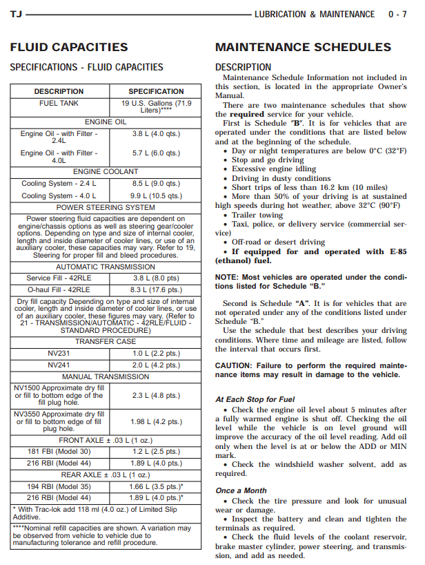

You've got a NV3550 transmission right? From what's I've read, the fluid you're looking for is called "schromesh" or the royal purples version, "schromax". Here's what my 2000-2003 manual says:
Thanks, Terry, and JPNinPA, and to all who helped... The verdict is in - I have a 2001, 5 speed manual, 4.0L Wrangler TJ which has a NV3550 manual transmission (years 2000-2004)..... It took just a tad bit over two quarts.... Thanks, again. BTW - 2001 seems to be a weird year for jeep transmissions.
