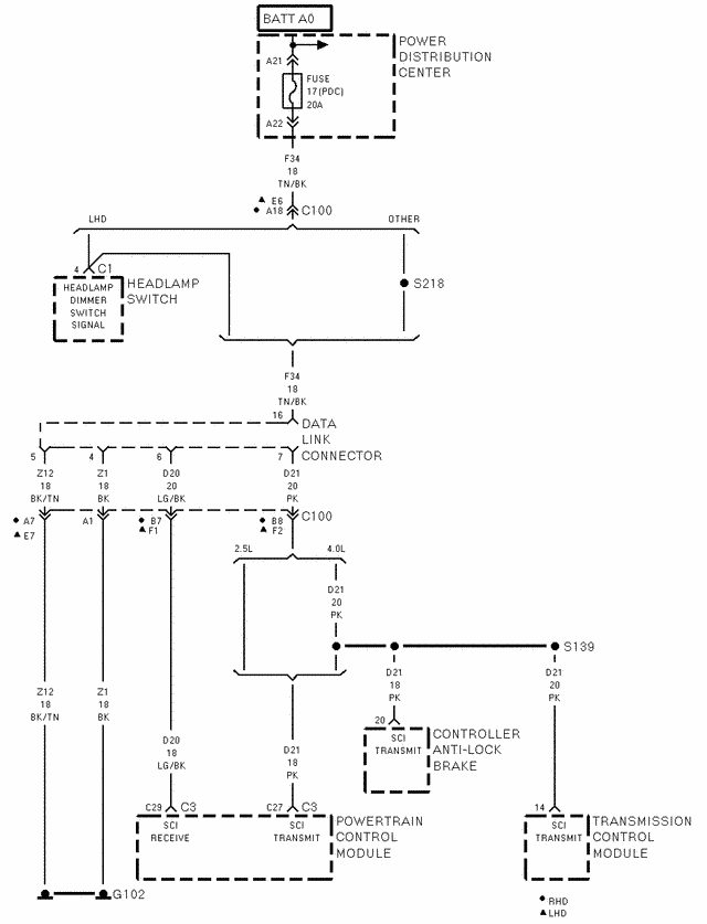

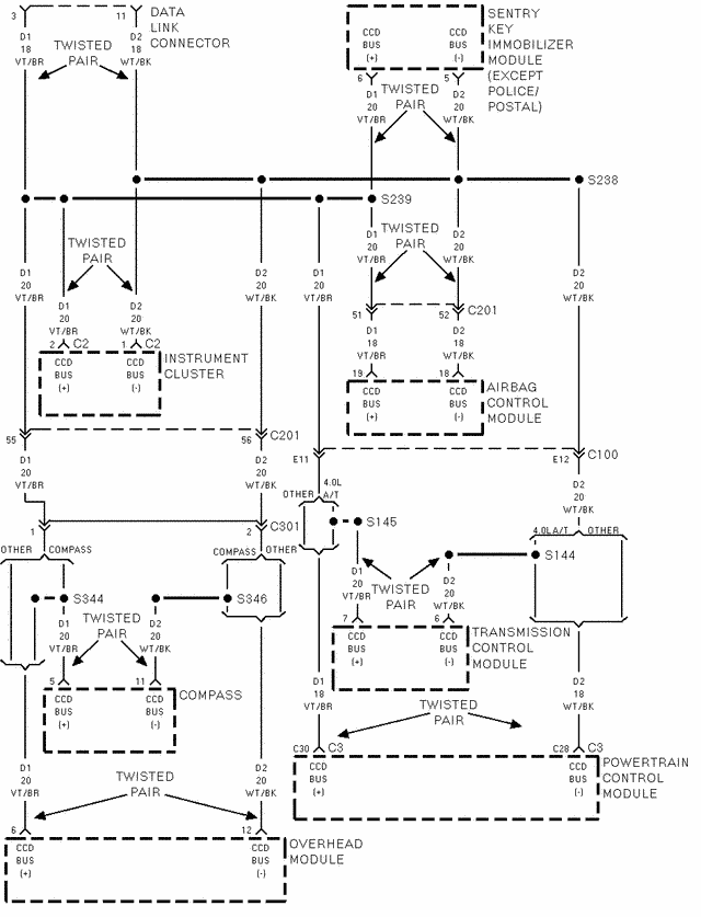

Here's a couple of wiring diagrams that will help you trace the CCD bus communication wires to test and verify.

It's not that bad considering that there are only 2 items your verifying on these schematic diagrams, SCI communications between the PCM and TCM and verify the CCD bus line as well. If any of those lines are faulty, it would need to be repaired, if they test good, replace the TCM.
