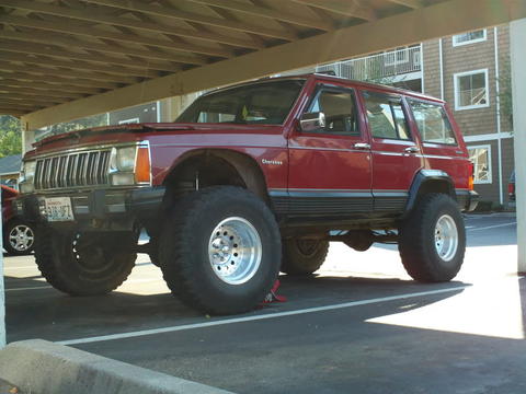

My rear axle bearings recently went out in my 89xj. I have decided that since the axle has to come out, and I have to spend close to $300 in parts, I might as well upgrade.
I think I have decided on the Ford Explorer 8.8 axle with the disk brakes but I have some questions.
-What else do I need besides the axle, e-brake cable, and perches? Is the kit from MOR worth it?
-Do you suggest putting in a proportion valve on the brake lines? Do I need other brake lines for the calipers?
-I read that the after market e-brake cable won't work with abs. My truck used to have the recalled system but I replaced it with the non abs. This shouldn't matter as long as I get a non abs axle right?
-It seems the whole swap will be close to $500... Is there any other more affordable axle swap you might suggest? Or any other options out there being that all this is just because of an old axle bearing?
Thanks for the help!
