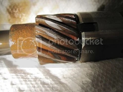

Also it could be timing knock. The OPDA oil pump drive assembly and CAM gear wear. Some call it screaming monkeys.
OPDA is to the right of the oil filter when standing on the passenger side.

OPDA tick from another jeep
What you will see

It’s Your vehicle.... but an easy check for OPDA could be accomplished by: you could clock the engine to TDC on #1 and either see if the locking pin holes line up on the OPDA housing to the timing ring and or lock them and pull the OPDA and inspect the gears.
Screaming monkeys do not always occur. I threw a code snd rough idle when i changed mine at 90K. At 60K it didn’t look bad to consider change.

I did what you suggested and it quieted down the knock a lot. it seems i need a new opda to get rid of it completely. Thanks for the help.
Glad it helped. Get it replaced before too much wear on the CAM
I replaced mine with dorman brand. So far so good.
