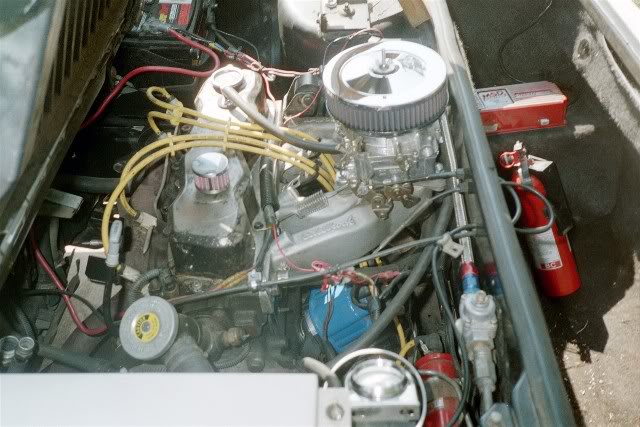

glenn what motor is that is it a iron duke 2.5 or what I have a few starters that may work if we find out what eng it is
every day i learn just a little more. i found the old dash board tag and it says "1969 dj5a" "L4T*3CID" *-is a number i can not work out.
thks for the responses so far but im unsure what a iron duke is. i think its a 2.5l 4 cyclinder. the fuel pump seems to be the same as a 134 military as it has the glass bowl on top of it. im thinking that this is a mutt and i guess if i carnt lift the engine number i will have to pull of the head cover to get the casting numbers.
as for learning......im well impressed with the jeep it went places today that the big f250's couldnt follow including fording a swamp that had places over 3' deep.
That should read L4-153CID if it's a dookie. Who knows what changes the PO did. 5 slot grill is DJ. The other Jeeps are 7 slot.
lol maybe the t is a I so L4-153cid sounds like a winner. the grill isnt a dj (i went to the web sites that was surgested earlier in the post and the grill is a cj5 for sure...thanks for the link john). now im confussed alittle about the motor.....is it realy one side valve and one over head on the f-134 motor. the engine number near the water pump is T33486 which doesnt match any id numbers i could find on the net. i did find a site that says that dj5a was registered until 1972 but no records indicate that any was produced after 1968...hmmm...lol
i havent got the pictures of the motor yet as i seem to have misplaced the camera cable but i will post them as soon as i can.
It's a Jeep so chances are good someone swapped something along the way. There are many DJs running CJ titles and vice versa.
The "Iron Duke" will have a flow through head, where the intake manifold will be on one side, the exhaust on the other. A f-134 will have the intake manifold built into the head and seperate exhaust, and the L-134 is a flathead. Since you mentioned it has a T90/Spicer 18, I'm willing to bet it's either an L134 of F134 . . .just a wild guess
the f134 was stock on many Kaiser jeeps from 50 until AMC bought Jeep in 71.
starter look like this this is for a 134 fhead and can be used for 12 volt just need to change selinoid to a 12 v
I got 2 of them
:) intake is built into the head and the exsaust manafold is attacked to the engine block on the other side so f-134 it is.
my starter looks diffrent from yours john the coil pack is smooth it doesnt have the lump for the field coils.
