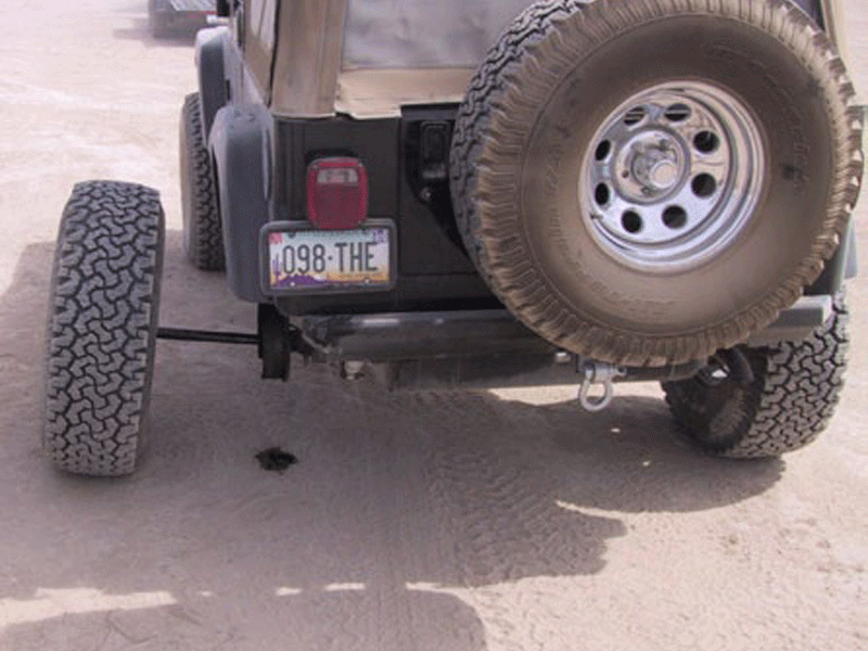

The Dana 35 has axle shafts that are held in with clips. If the axle breaks you end up with this:
