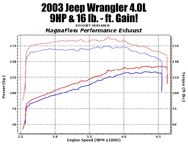

For reference on loading lugging the engine. Note you want to be at or slightly above 2500rpm

He has 32s with 3.73 gears. Said he drove 70-75 and had to turn off overdrive because of low rpms versus hills/mountains
Yeah he would have to be going 83 mph in overdrive to be at 2250rpm. The bottom of efficiency. But you will not have the hp to pass. A breeze can slow you down. Actually don’t think the engine could get there unless down hill.
In third 2750 rpm to go 70mph. And 2950 to go 75 mph.
At 2550 rpm he should be at 65 mph in third. That would give the best mpg performance and keep from lugging the engine.
Then only use overdrive when on the flat or downhill when coasting to maintain speed.
This is all given the tires are really 32. As you know anything above 31 in diameter is called 32
