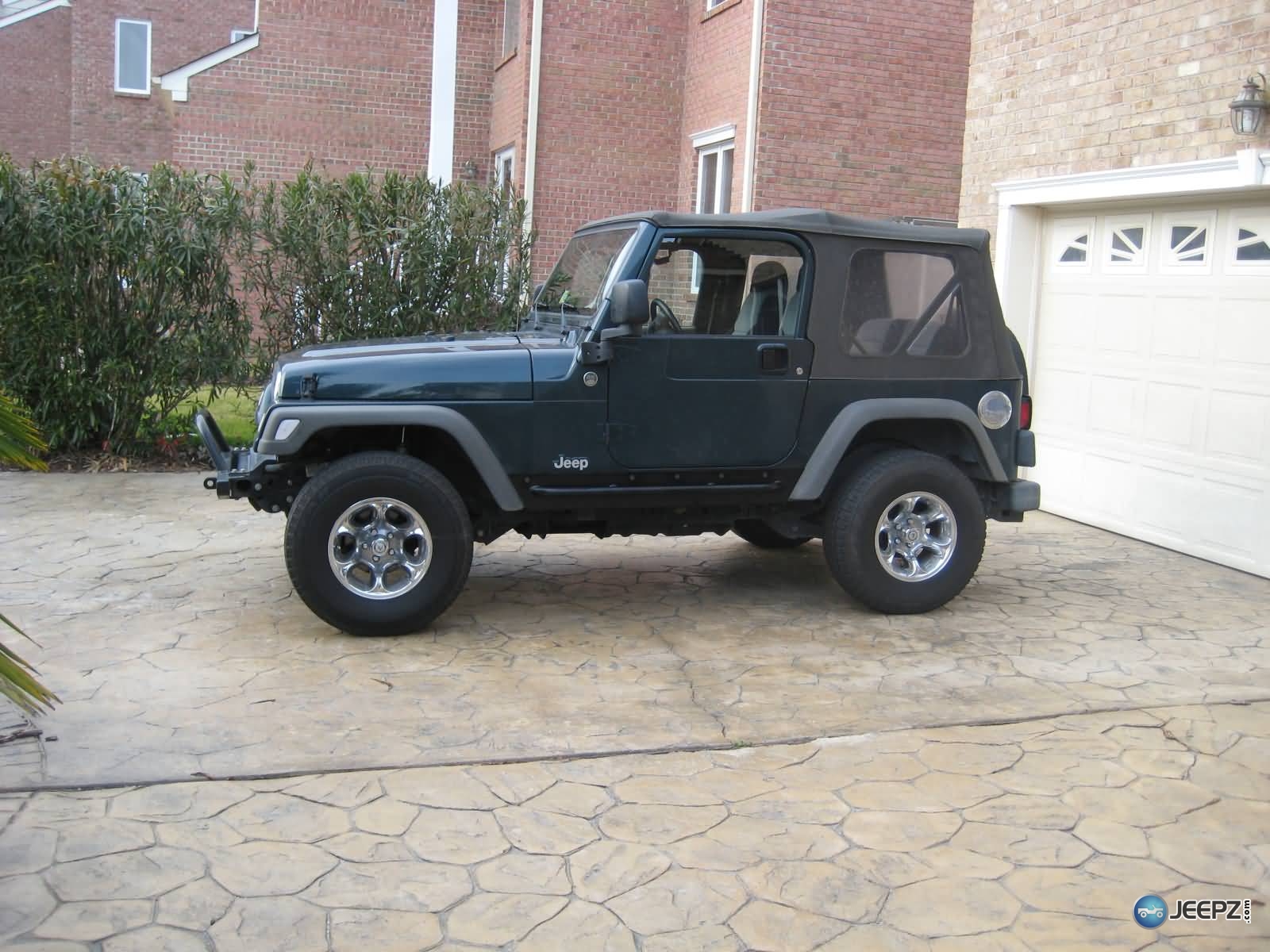

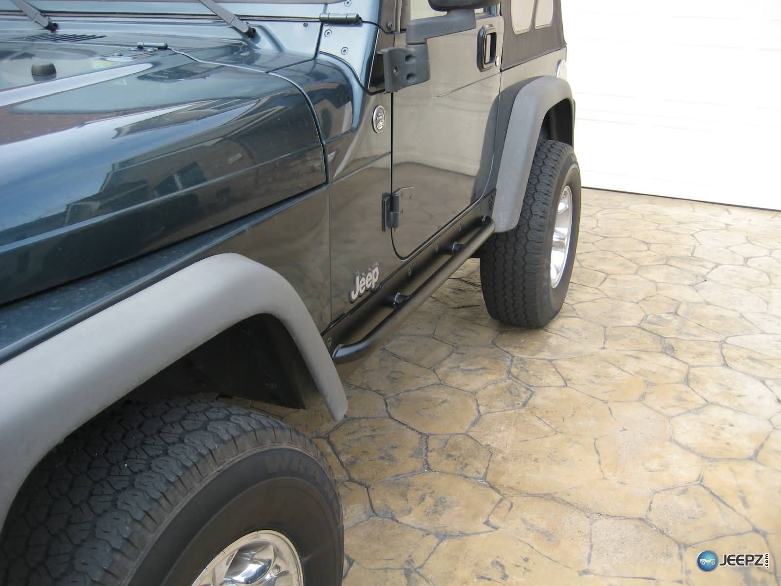

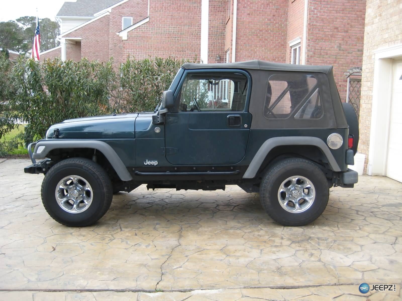

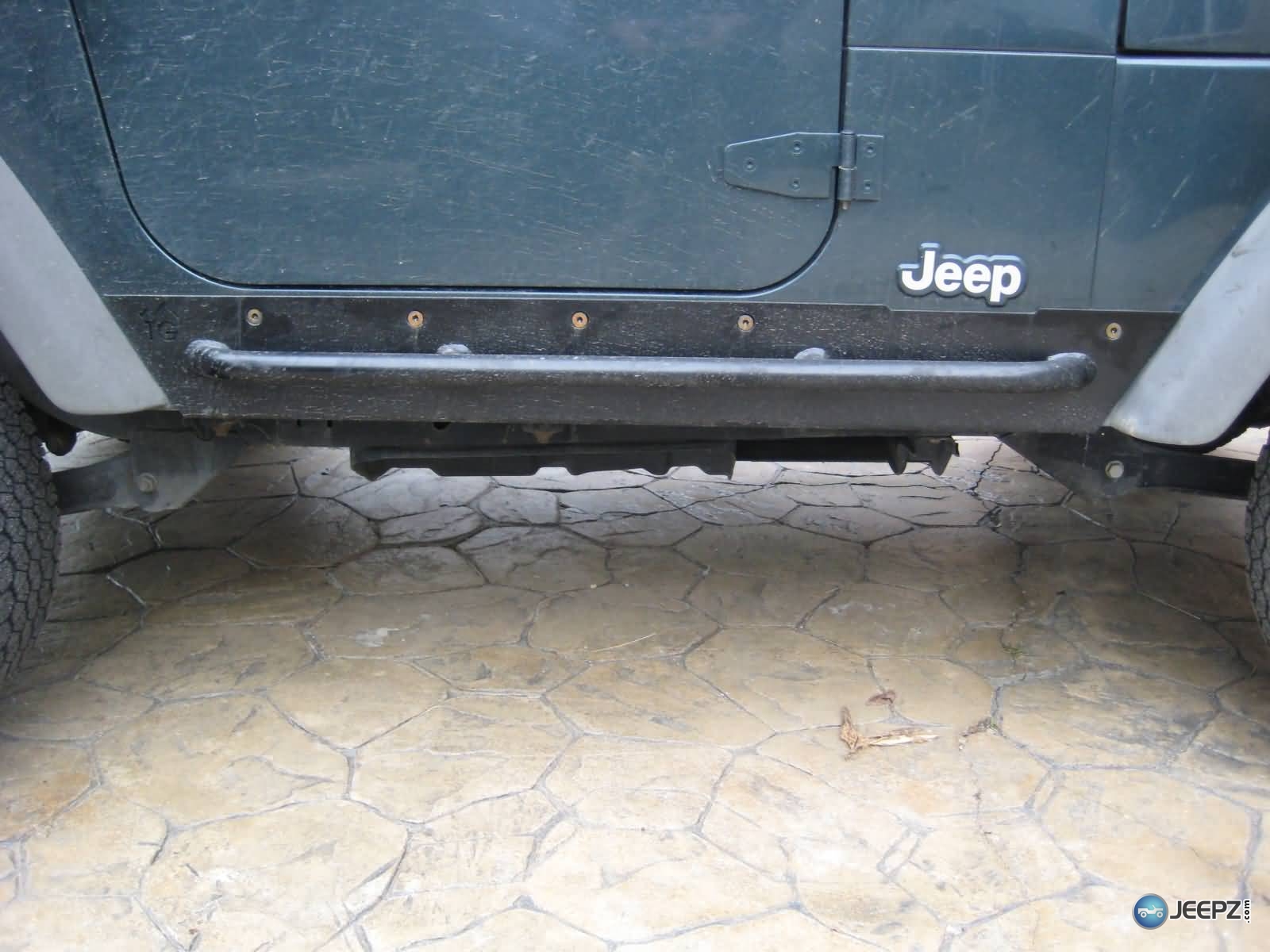

Some photos of before and after the install

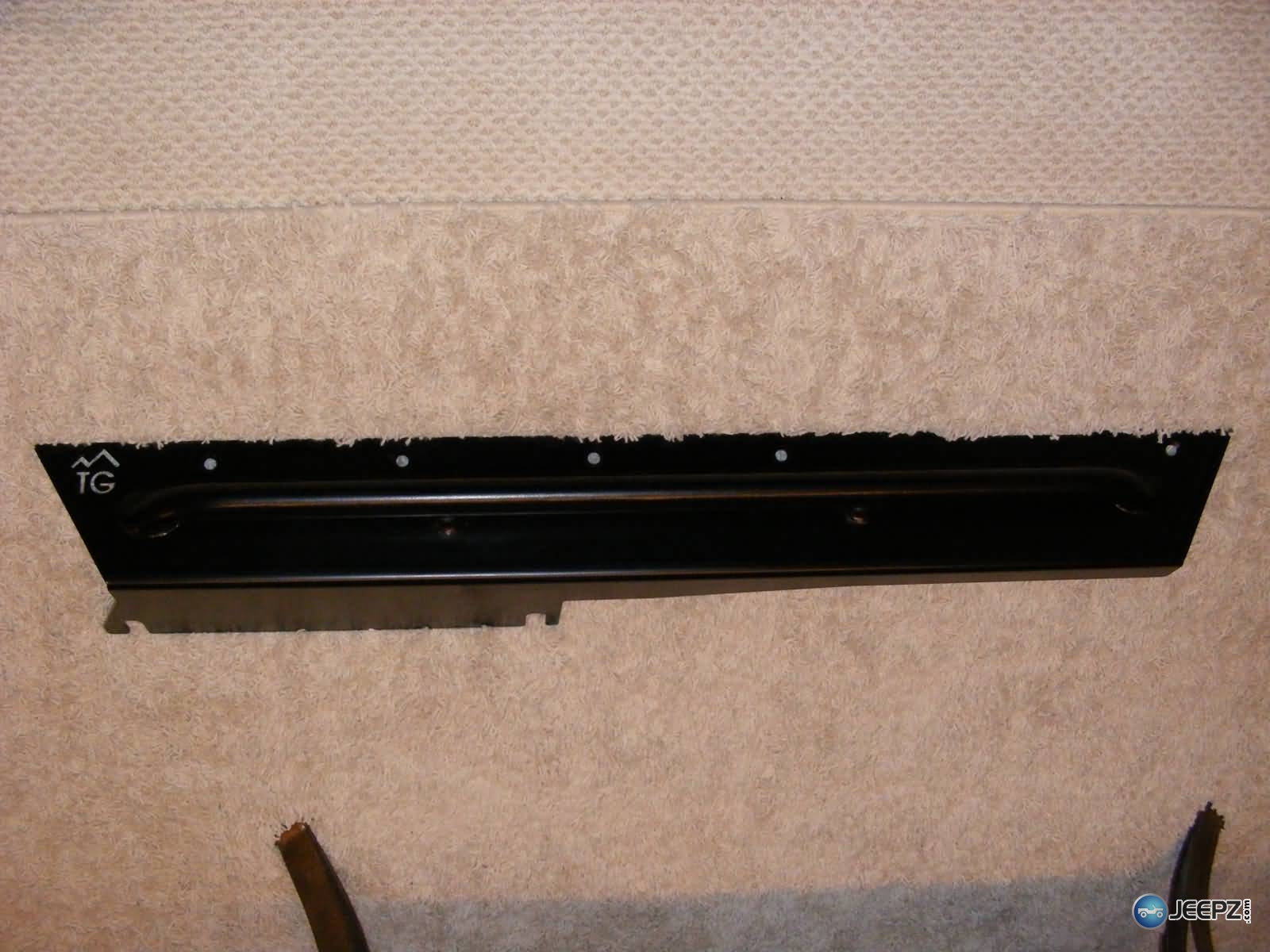

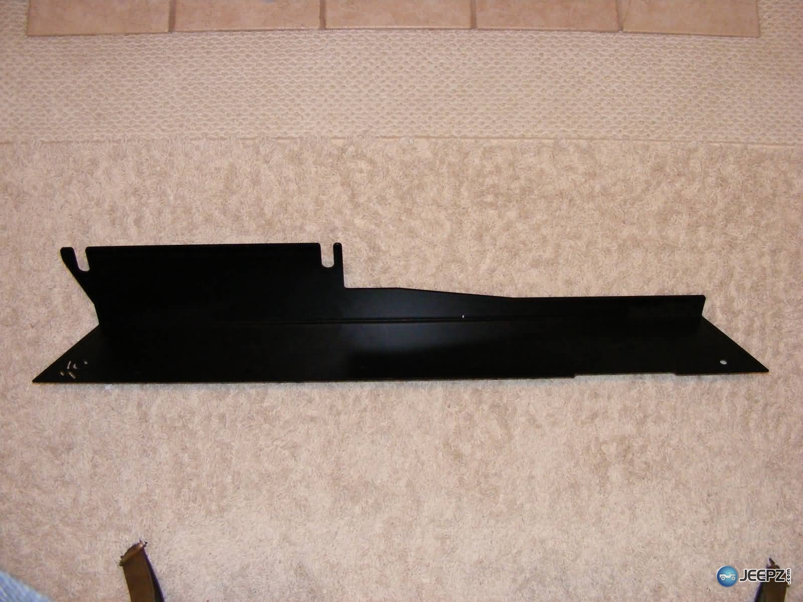

New Wrangler Rock Sliders

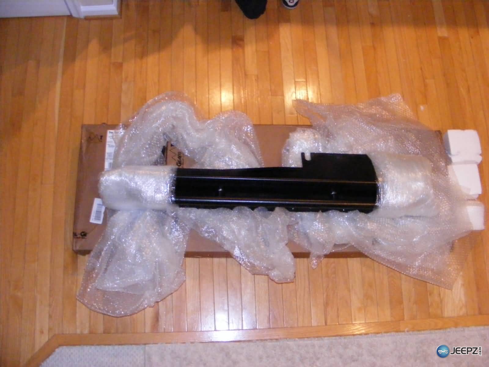

I was very impressed with the packing on these sliders – they showed up at my house in three boxes, one for each slider and a third for the hardware. As you can see they look pretty good, and come embossed with a TG logo on them (there doesn’t seem to be an option to skip the logo) as you can see in the photo below.
My first (minor) gripe came when I opened up the boxes. While there were some pretty cool stickers, and marketing material, there were no printed directions. So, I had to hit their website, and downloaded the PDF directions... tragedy adverted.

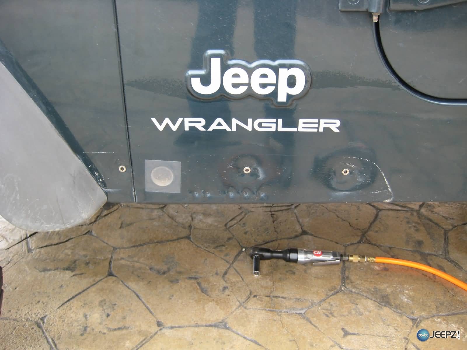

Removing the fender flares

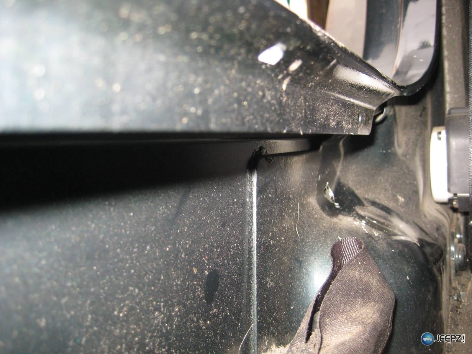

To get started with the install, you'll need to pull off the front horizontal fender flares. They are held on by three screws each. Once you have these removed, you'll notice that there is quite a collection of dirt and crud. You'll want to clean the entire area where the rock slider will mount – you don't want debris sandwiched between your slider and paint for the next 10 years.
Once you have the area scrubbed down, take a look at the screws holes where the fender flare is mounted, you'll notice that the anchors protrude from the body of the Jeep. I was able to countersink these by just tapping them carefully with a hammer. If you don't sink them, they will push your rock slider away from the body by about 1/8th inch.

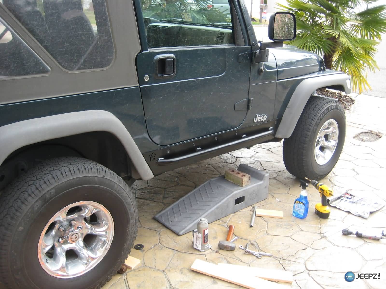

Jacking up the Jeep

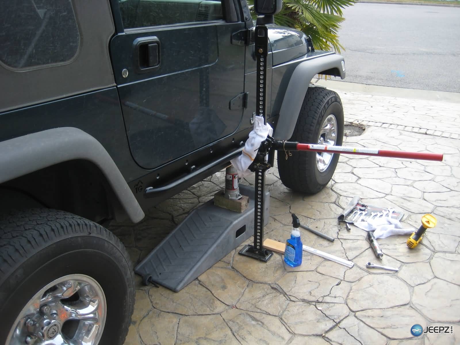

It took some time to find a good way to jack up my Jeep. There isn't a good spot to set my Hi-Lift jack, and since my floor jack wouldn't reach the Jeep body, I ended up going with a bottle jack set on top of a ramp stand (I wouldn't recommend this to others. You should take the time to get the proper jack). I'd like to mention that you need to be very careful when jacking your Jeep, but as long as you don't put your fingers between the body and the frame, there isn't as great a chance of injury in this case - just use care.
Once you have the jack in a position you want, place a few boards between the jack and the body of the jeep to distribute the weight of the Jeep, and keep the jack from bending the body. Raise the body of the jeep up until you can remove the body mounts

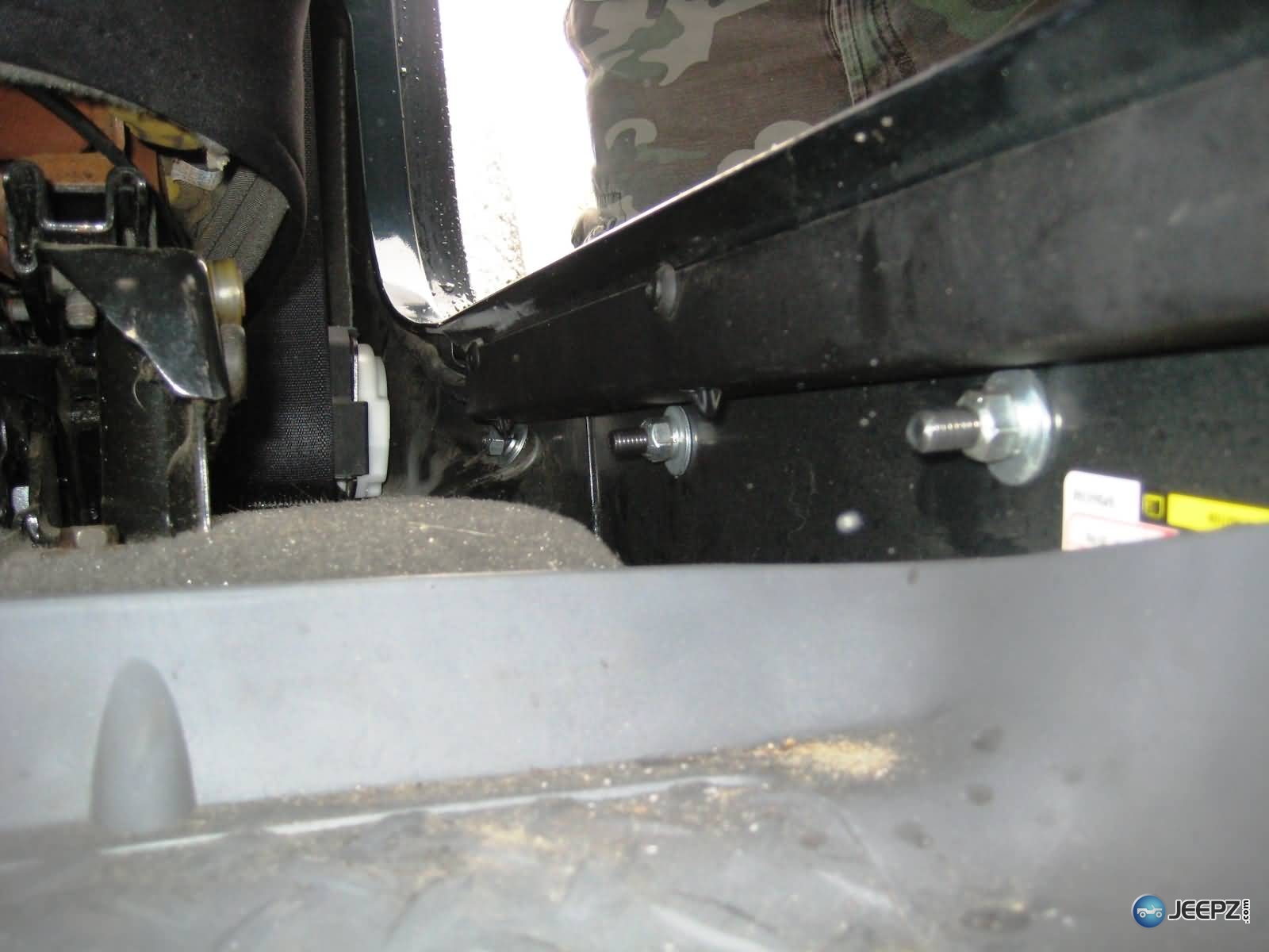

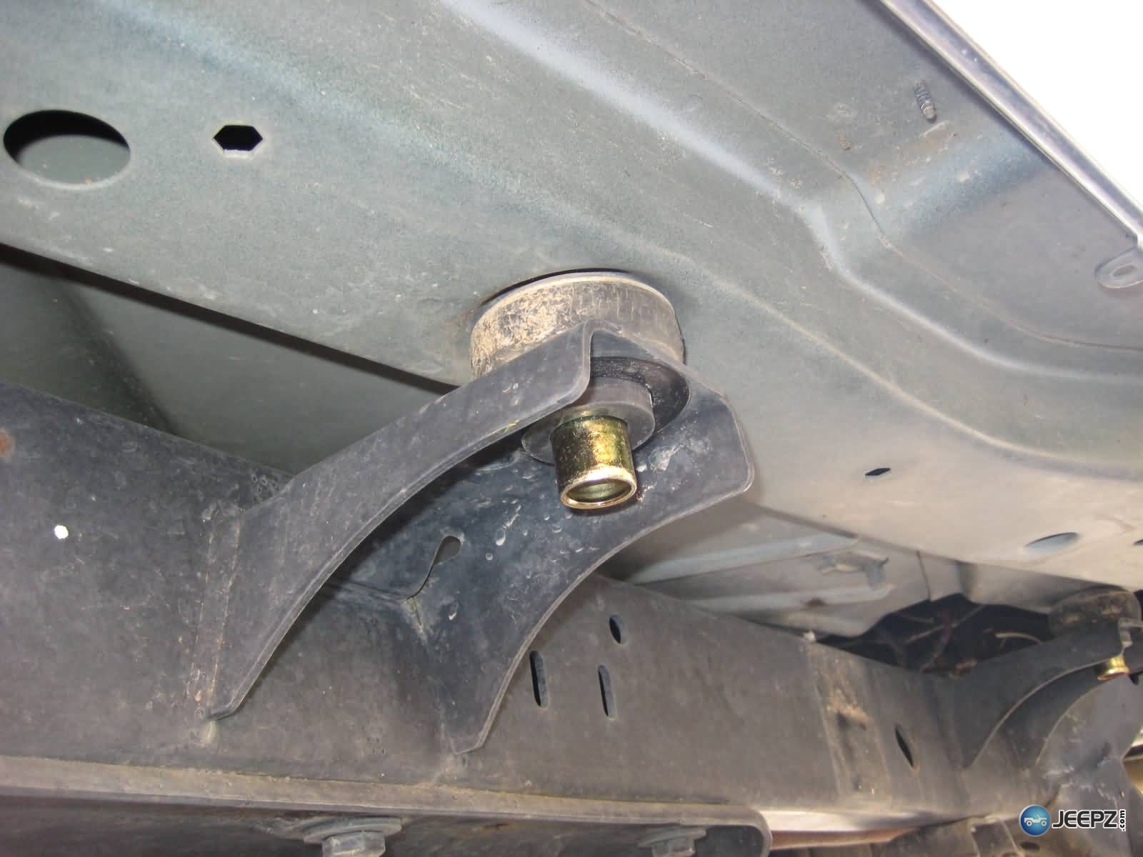

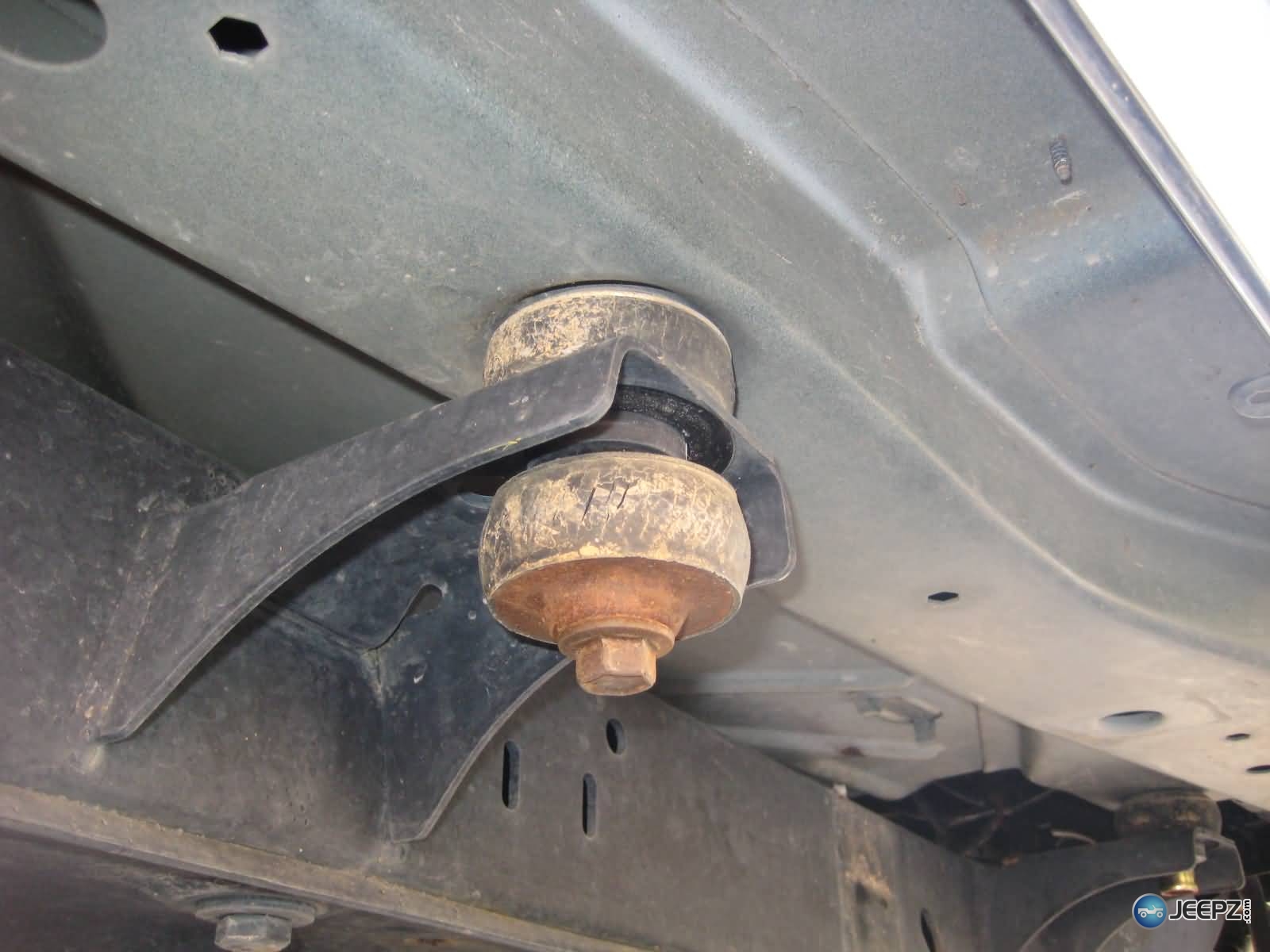

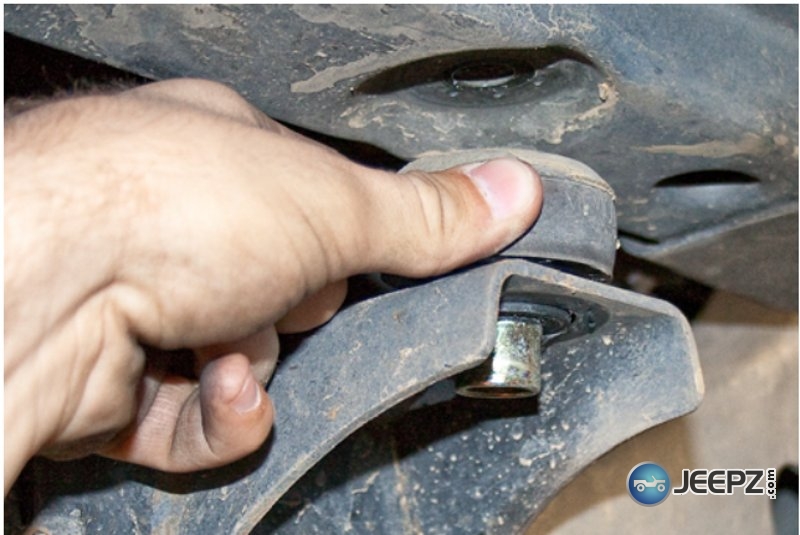

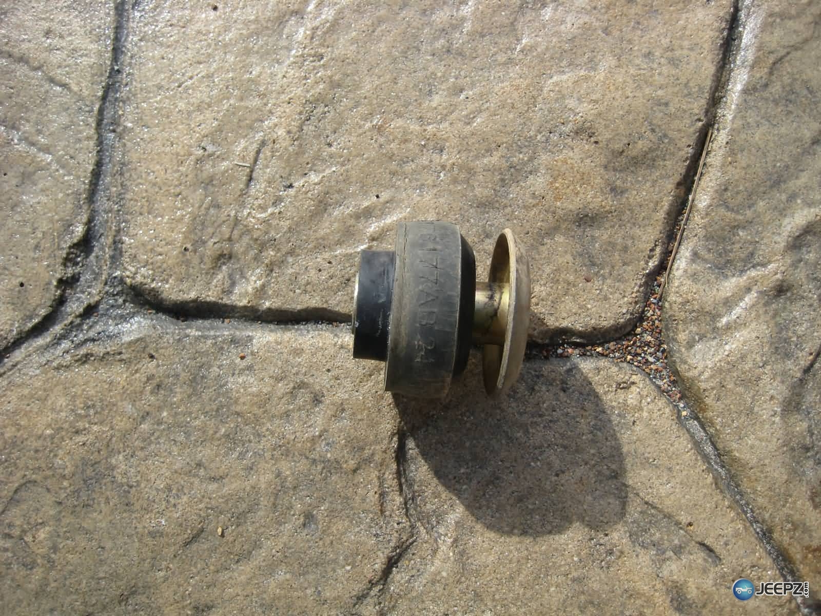

Removing the body mounts
Now you are ready to pull the body mounts. You'll need to install the sliders one side at a time. So, pick a side and remove the 5 body mounts on that side, along with the body mount in the front. If you have air tools, this job will go a lot faster.
Triming the body mounts

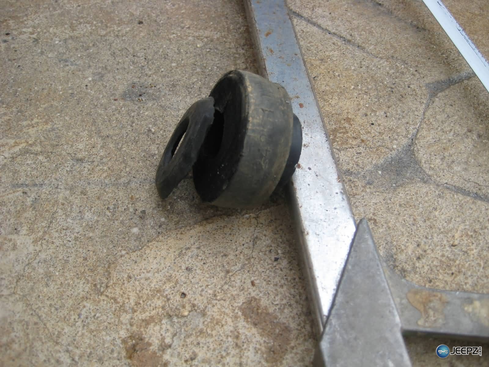

Now comes what I think is the hardest part of the install, cutting down the body mount. Since the rock slider will sandwich between the body mount and the body of the Jeep, you'll need to cut down the two side rubber body mounts by 3/16ths inch (or else the body mount would be too tall). I strayed from the directions a bit here, and decided to leave a thin sliver of rubber above the rock slider - this was probably unnecessary, and just made my life harder.
My initial thought on cutting the body mounts was to use my cutoff wheel. Do you know what happens when you use a cutoff wheel spinning at a couple of thousand RPM to saw through rubber? I now know that the rubber first emits horrible smelling toxic smoke before becoming semi-liquid and flying all over the garage and cutoff wheel operator. I eventually used my hacksaw and a vise to hold the mount and slice through it.

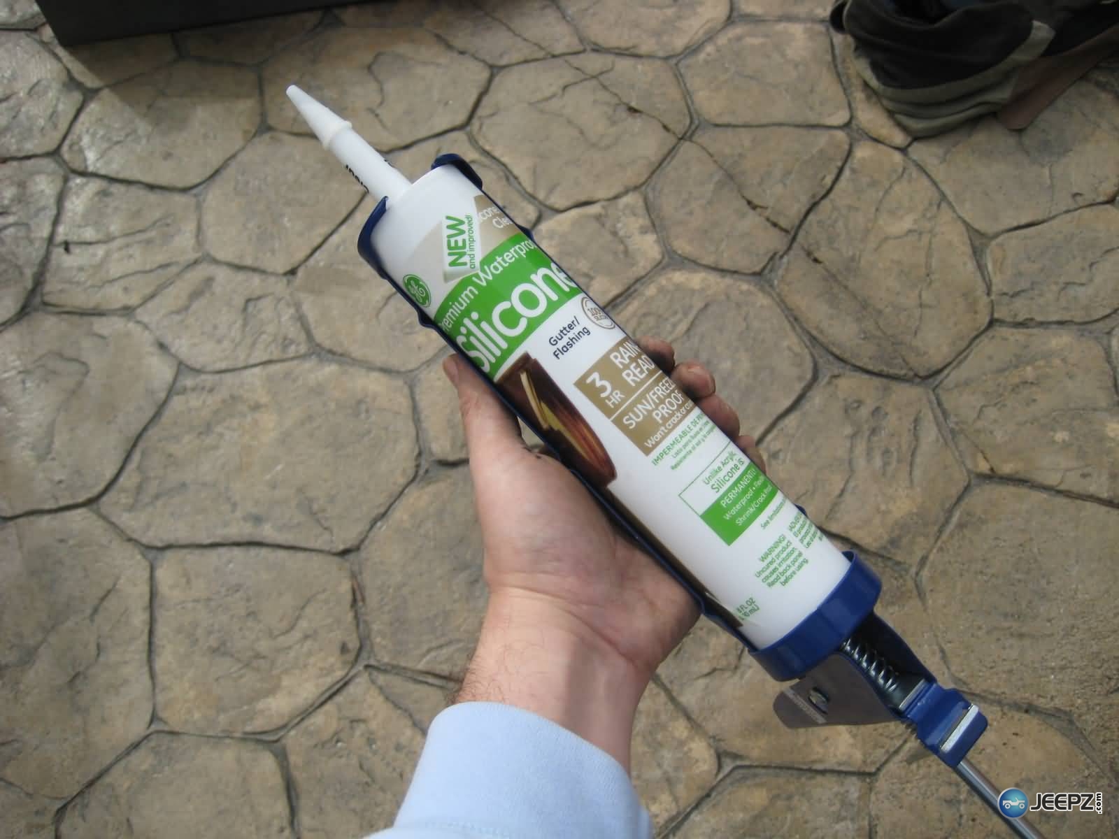

Once the mounts were cut, I prepared to put the rock slider in place. I again strayed from the directions here and decided to put a thick bead of silicone between the body of the Jeep and my new rock slider. This should help cut down on rattles, give some small amount of protection for my paint if I ever decide to remove the sliders, and finally keep some water and rust out (you will be drilling holes into your Jeep later).
I used external silicone made for gutters that I found at Lowes. Simply cover the inside of the rock rail with silicon before you hold it into position.

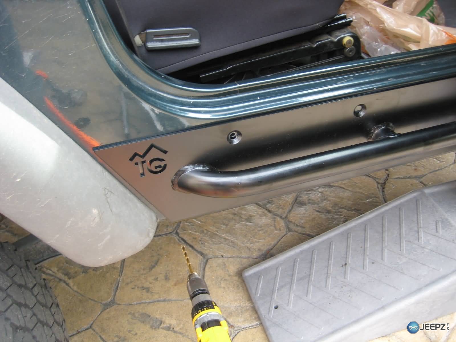

Setting the rock slider in place.
This can be rather difficult if you are working alone (I was). I decided to slide the rock slider onto the body mounts, then lower the Jeep down onto the body mounts. This allowed the weight of the Jeep to keep the slider in place, but also gave me a chance to make changes before I drilled.
I lowered the Jeep into place, but noticed that that top of the rock slider was about ¼ inch away from the Jeep. By using my Hi-Lift jack, I was able to raise the rock slider into place, giving me a good fit. You don't need to put any real pressure on the Hi-Lift, only enough to snug the slider up to where it should be.

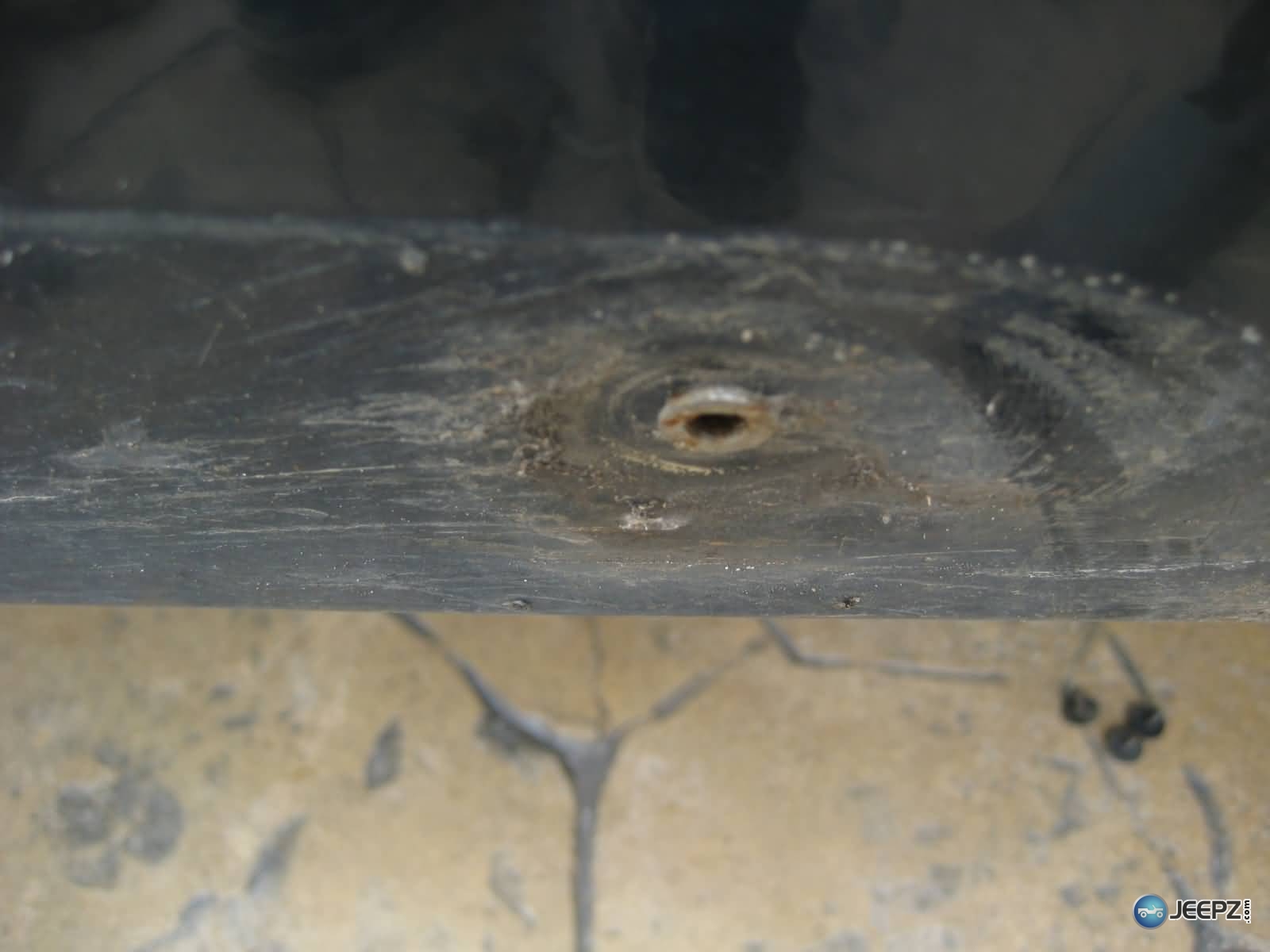

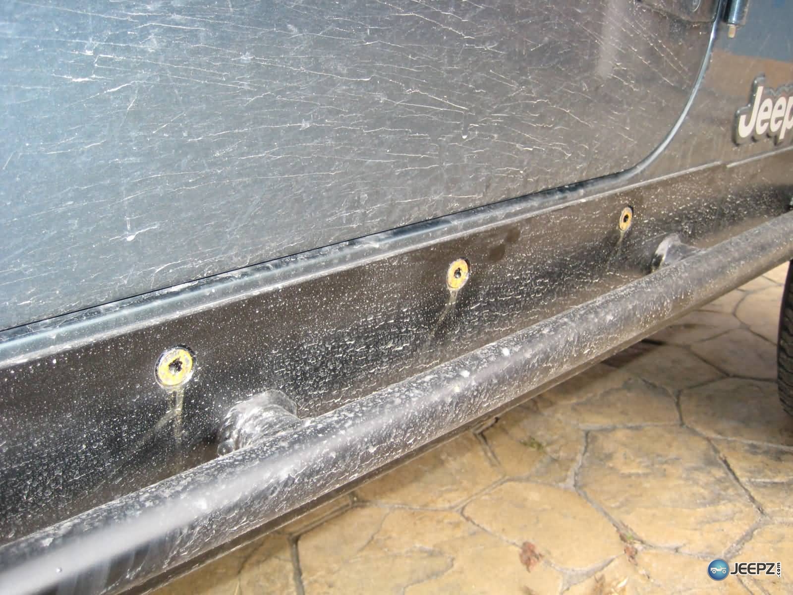

Drilling the Jeep
It took me some time to steel my nerve enough to drill my Wrangler for the first time, but once I got the slider into place, there was nothing to do but go for it. I used a normal center punch to prep the wholes, then drilled with a 3/8ths drill bit.
Once I drilled through I squirted a wad of silicone into the hole and worked it around in an attempt to waterproof things. This wouldn't be a bad time to use some touchup paint on your newly drilled holes (I didn't take the time).
The farthest back hole didn't come out as smooth as I had hoped. The inside of the Jeep at this spot has a hump that makes your bolt sit at a pretty extreme angle. There isn't much that can be done for it, but don't be surprised.
You'll need a T45 torx to tighten down the bolts. I used my air wrench to speed things along.

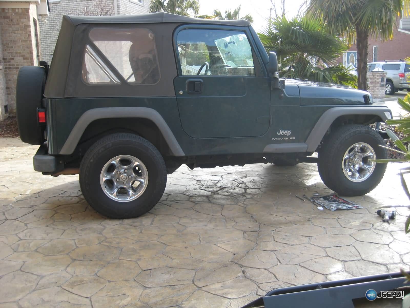

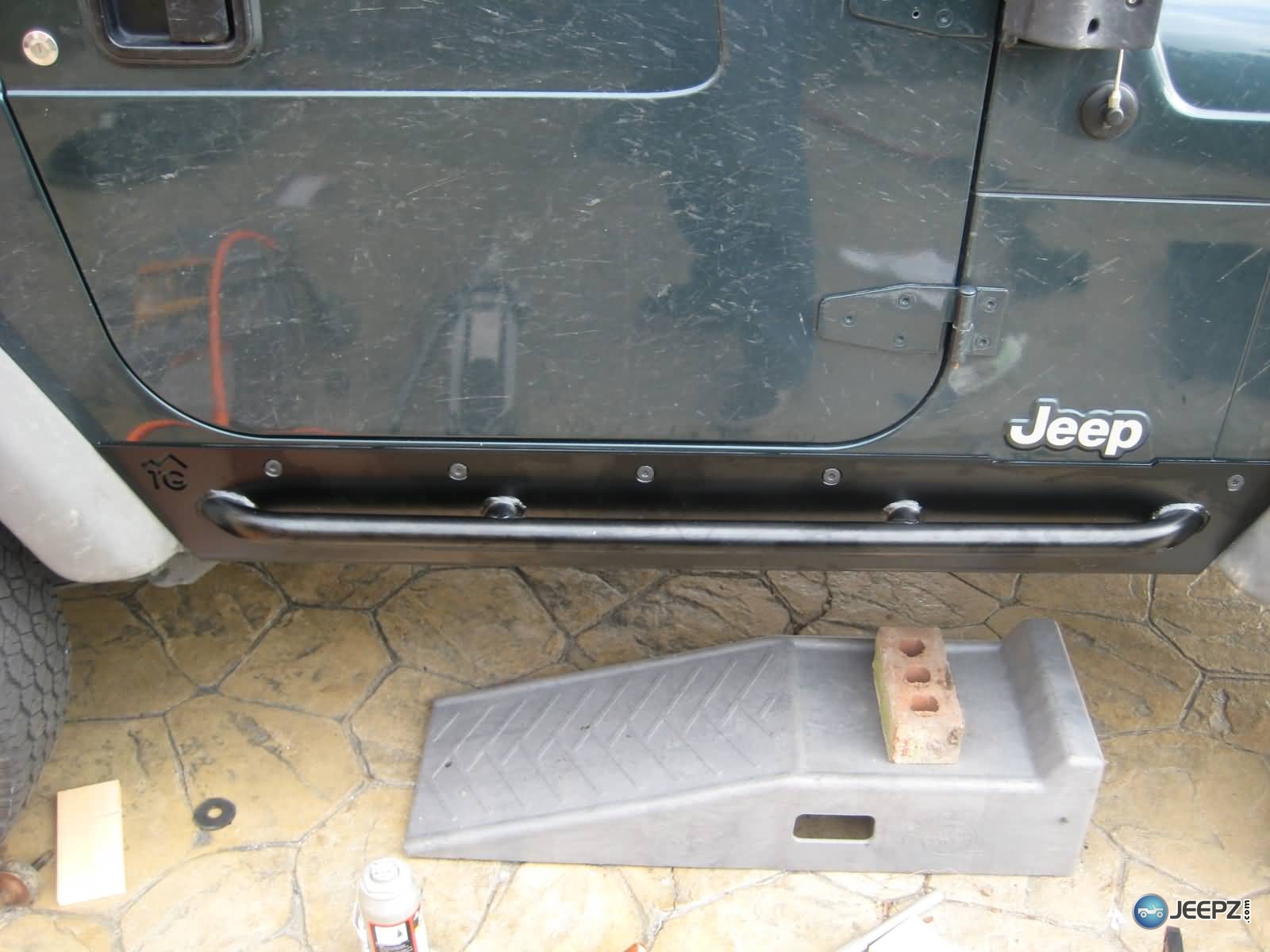

Finishing the rock slider install
Finishing up the rock rail install
Once all of my holes were drilled, and bolts were tightened, I went back with silicone and ran a bead along the top of the rocker panel, then worked it in with my finger - again, hoping to better waterproof /debris-proof things.
Painting
I was sad to see that within a week the bolts on my new rock sliders had rusted. At first I thought that it was just where my torx had worn the paint off, but I soon noticed that the entire bolt had rusted. This was not at all apparent from looking at the bolts - they looked great going on, but it appears the paint just wasn't up to snuff. Since it only took 7 days for these to rust, I'd suggest painting all your bolts yourself before installing them.

This is a one day install for a novice mechanic - I took me about 6 hours total, mainly because I had to workup the courage to drill into my Jeep. I'm very happy with the finished product, and would install these again.

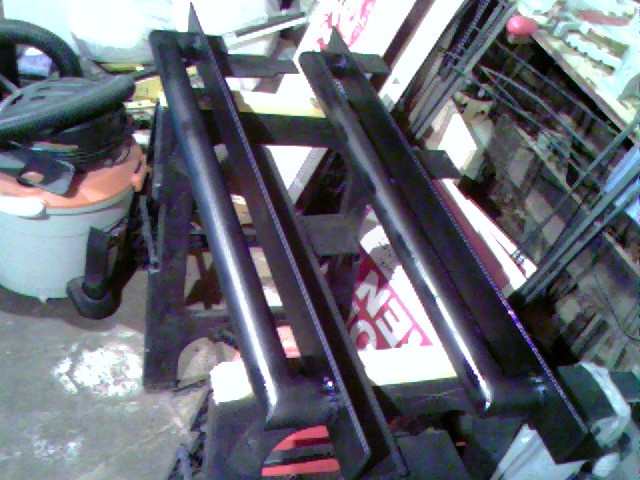

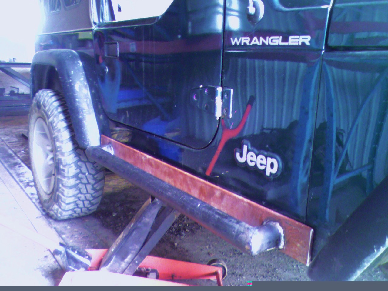

Great job!!! On the install.. i work in construction and i gathered up some angle iron and other things after a job was finished and built my own for the price of mig wire and my time. they are not to hard to build if u have time and access to material and have some welding skill.. here is a couple of pics....
