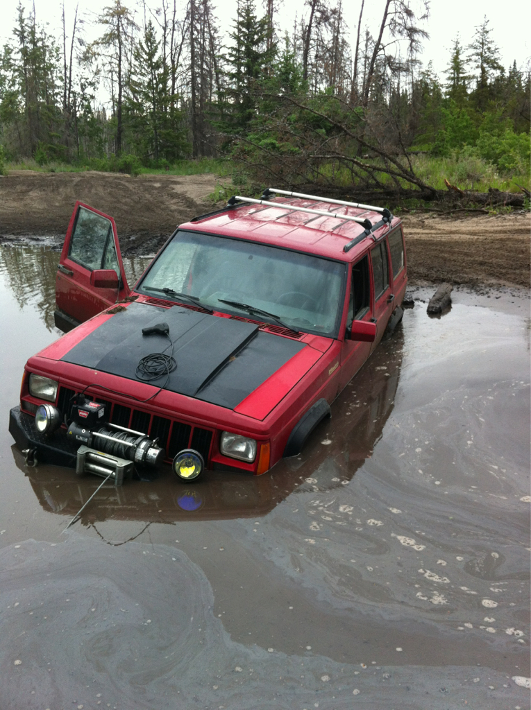

I run all my breathers to a self made port on my heater box. When I go out wheeling I hook it up for deep water. That creates a positive pressure in the diffs and trans and t case. I even run a hose to my distributor. Everything submerged and no milkshake. I run an auto to. So a milkshake is instant death.
This is how mine are ran. I just pulled them up so you can see them better for the photo. Front Diff, T Case & Trans.
