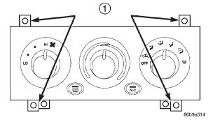

this is STANDARD or manual HVAC controls, no LED's type BS. Pict 1 manual is this correct?

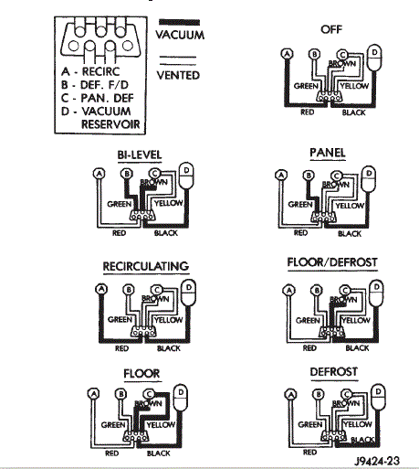

The issue is "MODE" doors. not switching - they are vacuum controlled, maybe yu unplugged a line
see pict 2 actuators
GTG I will look for vac diagram - I see no reason to suspect vac reservoir under hood.

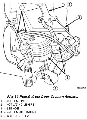

That diagram helps a lot. It must be an actuator or vacuum problem. Where is this actuator located. Is it easy access?
look by gas pedal -

FYI defrost is the default position no vacuum applied as in loss of vacuum.
PS this is MANUAL control picture #1 above?

sorry busy day for me - no time to solve this.... Attached dia looks like 1/2 half a puzzle but info is there
mybe vac lines swapped

Following up on the inspection of the actuator by the gas pedal... I took a look in there and the actuator is detached, most of the rod linkages are missing...haywire tied around the cams. No wonder the HVAC air flow is messed up! Repairing this is going to be a significant challenge. Looks like the entire dash has to come off to get at the linkage. Forty years of wrenching in the backyard and never taken a dash apart. Not sure how to do it...maybe I'll have to hire a mechanic unless I can get a good DIY video or something.
