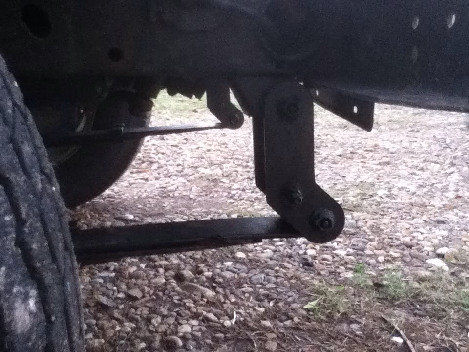

the stock ones were bent when i got this jeep so i just straightened them out and put them back on. i was having some weird clunking a few months ago so i put new poly bushings in but the ride was not horribly smooth. i read something recently about the springs not getting enough travel on stock shackles and hitting stuff, like bumpers and stuff. so i figured i would put some boomerang shackles on to give them a bit more room to flex on the ride.
here it is with the shackles, all cool and lifted. they are 5/8 longer than stock and cut from 3/8 plate. (if i had armor made from this plate mail, a horse would never be able to carry me and no one would ever be able to hurt me, this stuff is thick)

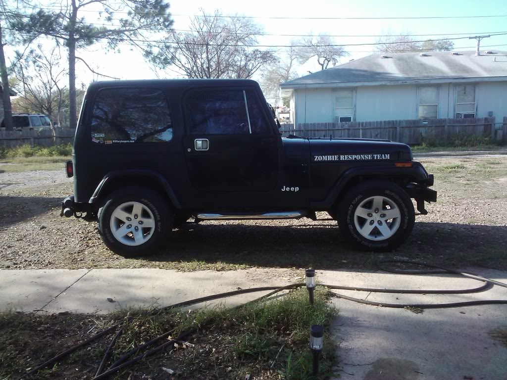

here is prior, on stockers

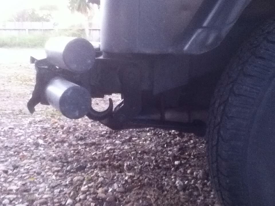

here is stock, or reference
