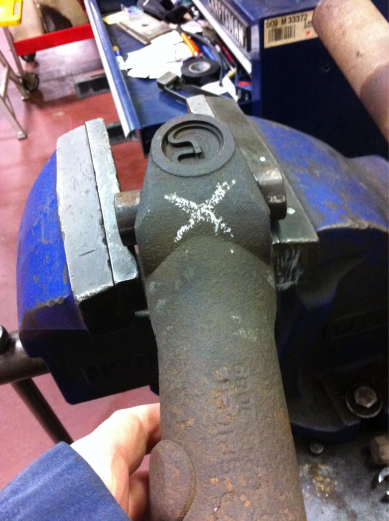

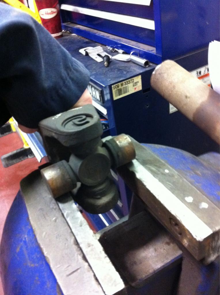

Hold the shaft supported in the vise as shown and x marks the spot you wanna hit.

Dont forget the clips lol I was just using a good shaft for demo lol.
