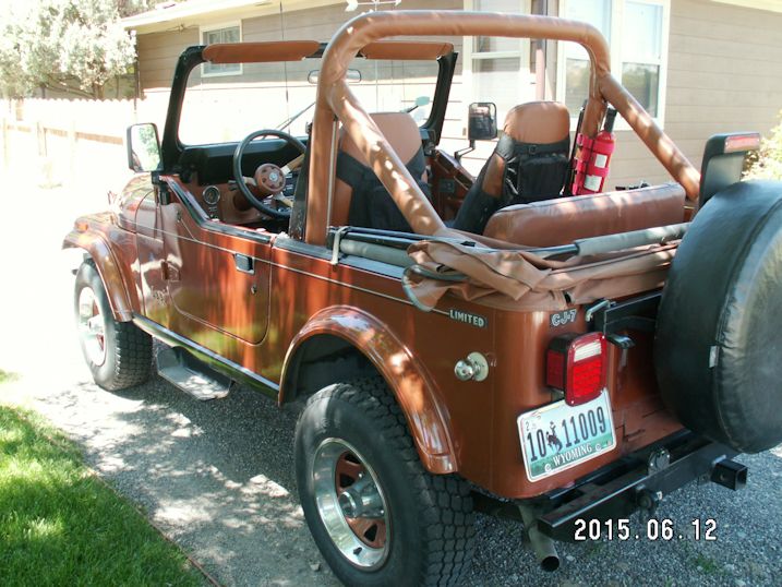

I have a Weber 32/36 on my 83CJ7 ... 258, t5 ... runs great but spent lots of time getting rid of vacuum leaks, lowering fuel pressure (2 -4 lb), and setting up jets for >5000 feet ... a lot of tweeking currently gets me 26mpg hiway. And, decent response when punching the secondary.
