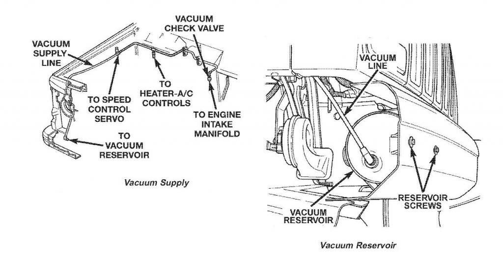

Front end collision? Did you go this far with the vac checking?
yeah, actually that vacuum reservoir for a long time we had unplugged and ran fine, but then we found out that we needed it to change where the heat was coming from
