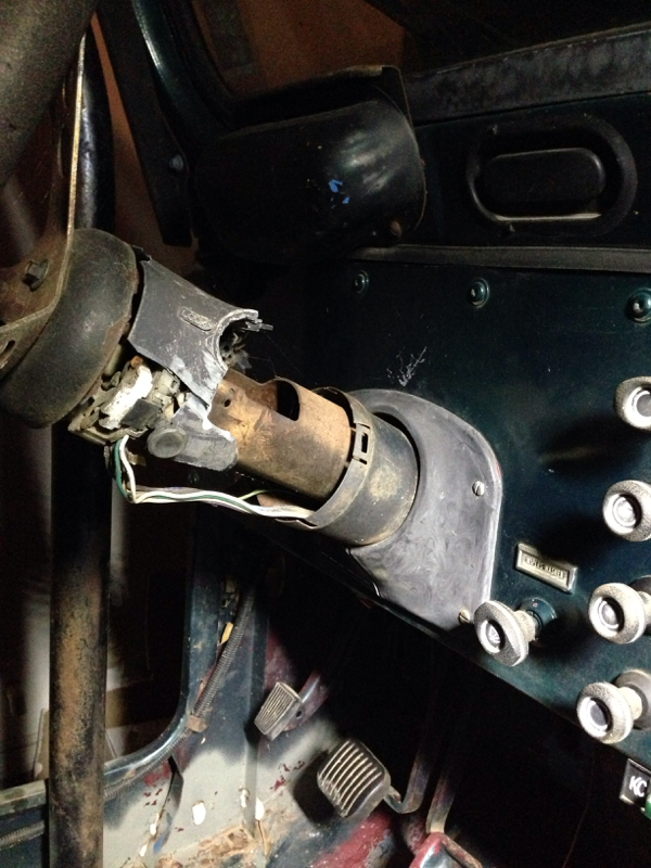

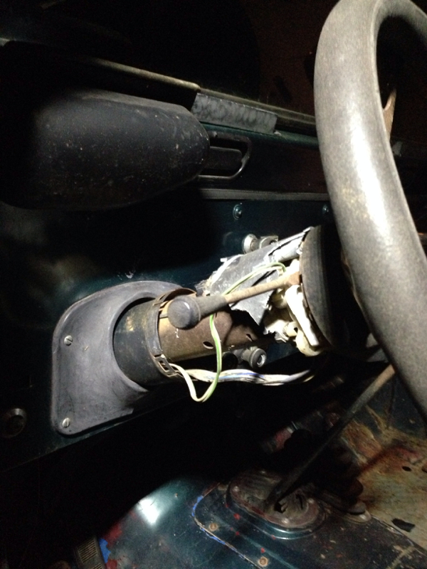

This is what I was talking about. Any clue where I can get a steering wheel shroud?
Holly crap, they wanted that thing out of there bad didn't they. I don't really know, looks like that top portion is a separate piece. The jeep steering column is a GM column, so you could try a junk yard and see what you can find, I would just look for that top portion, but would need to pull the ignition cylinder, steering wheel and unscrew the turn signal lever to pull it off, or just get the whole column
