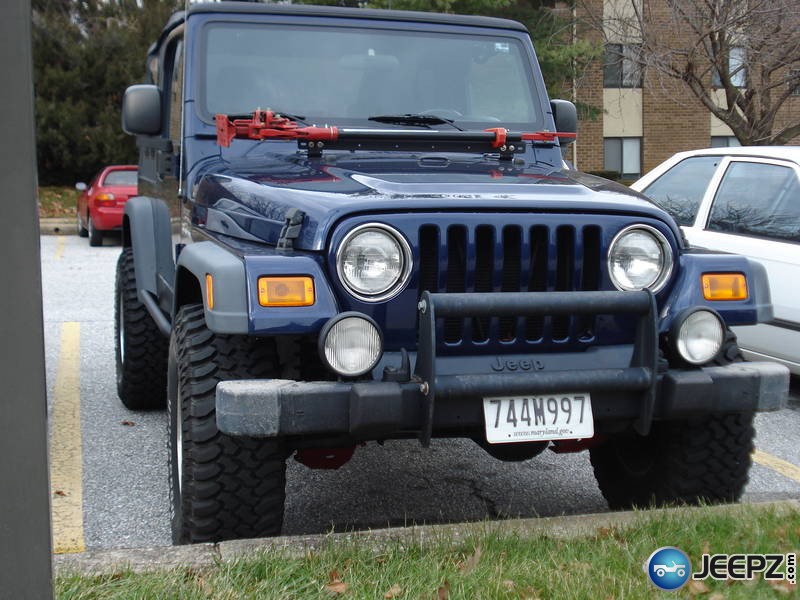

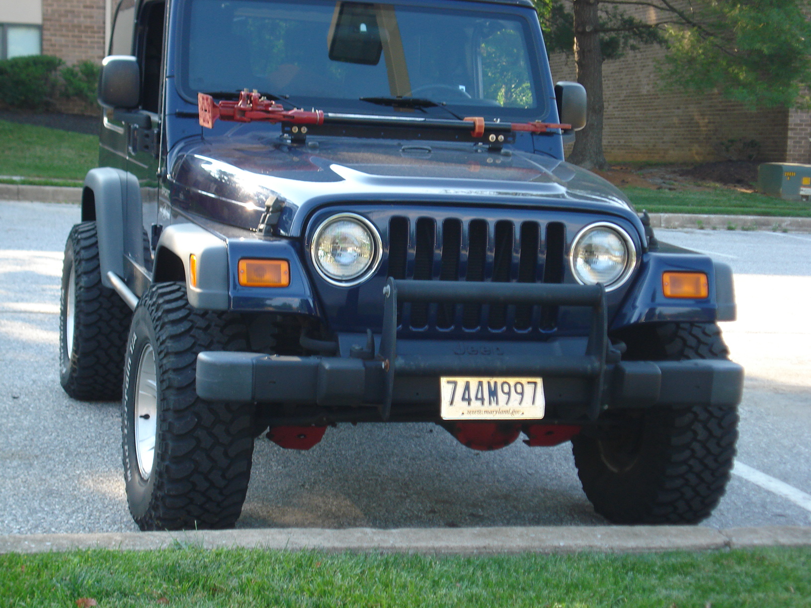

So yesterday I installed a set of four 1.5" wheel spacers from Rough Country on my '06 TJ to correct my 32" tires rubbing on the swaybar when the steering wheel is at full lock. I installed everything per the directions, removed the star washers, torqued down all the lugs and what not. Didn't have any problems. However, when I took the Jeep for a test drive afterwards, I seem to now have problems with death wobble. I had no issues at all before installing the wheel spacers. Does this make any sense?? I've just passed 41,000 miles, have had 32" tires since about 20,000 miles, still on the original steering stabilizer, 2" RE budget lift since about 10,000 miles. Could the steering stabilizer be giving up the ghost? What else should I look at?? I'm just kind of confused as to why installing spacers would cause a wobble.
Here's a before/after comparison if anyone is interested.
