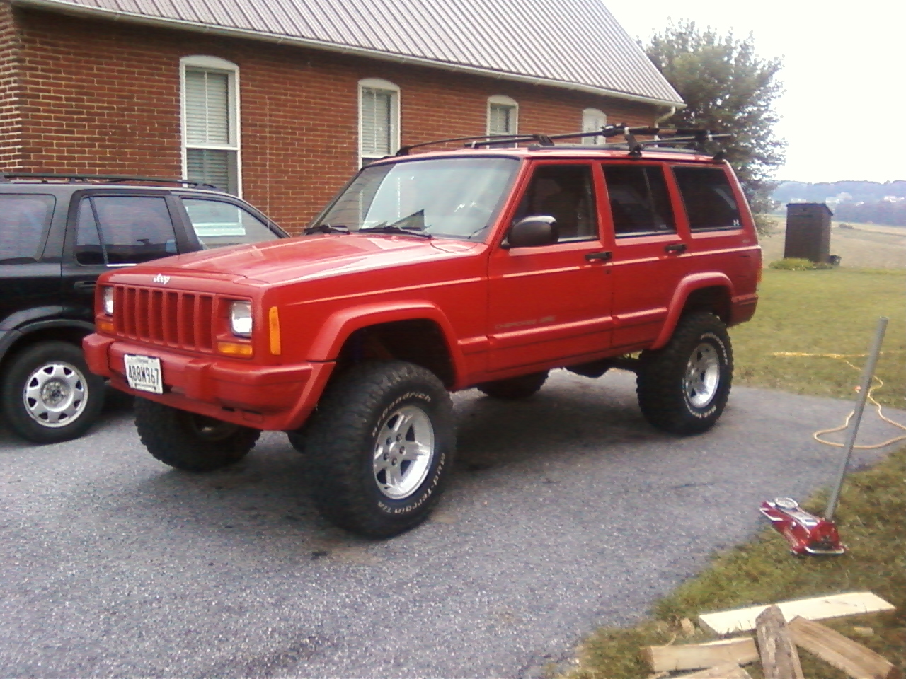

Finally got the XJ finished last night. Once we had the right bolts for the rear shackles the rest of it went together in short order.
