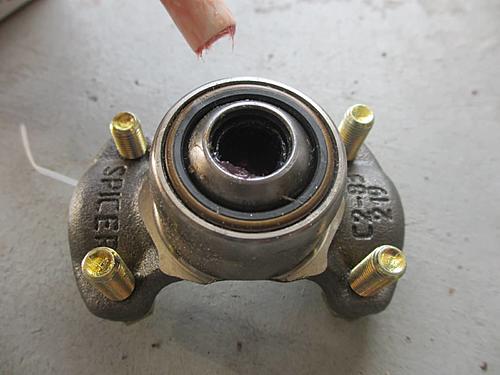

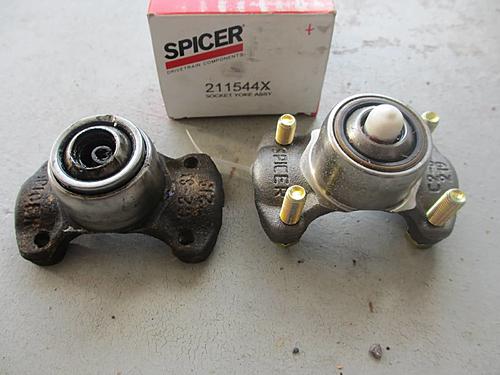

A squeak is likely the centering ball in the double cardan joint. The ujoints are fine if you just replaced them. It will require dis-assembly to properly grease the centering ball. Left unserviced the double cardan joint will grenade and take out the transfer case.
I couldn't see if your centering cap or unjointed had grease fittings.
You should always grease the ujoints during install, as well as the centering ball. The stuff used during manufacturing and shipping isn't adequate.

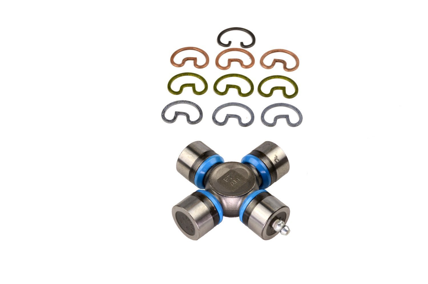

I've never seen a ujoint like this, but it looks exactly like what I need (with the grease fitting on the cup):
Amazon.com: Spicer 5-1310-1X U-Joint Kit: Automotive
Have you ever used one like this?
