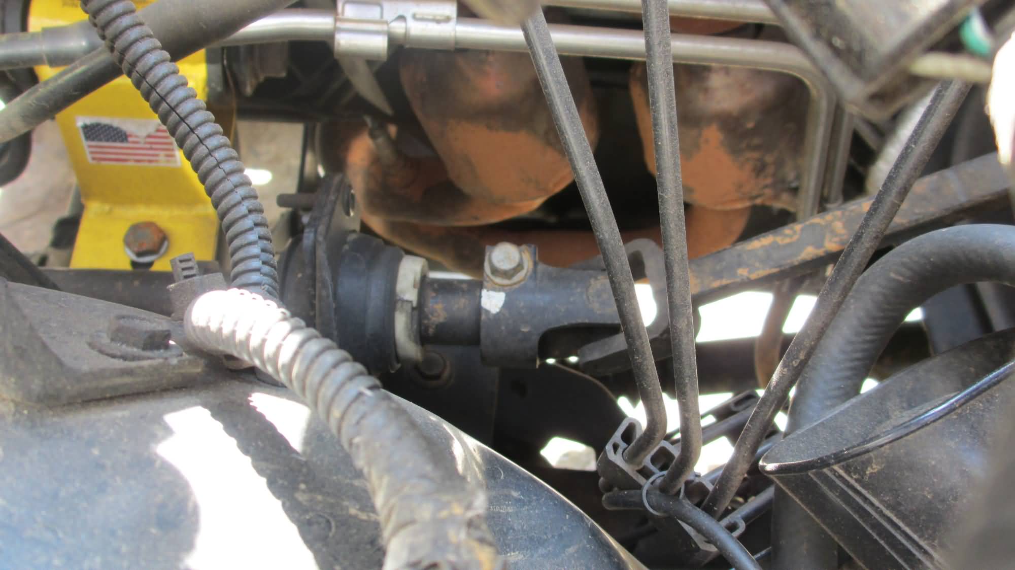

Here's the angle on the stock bracket

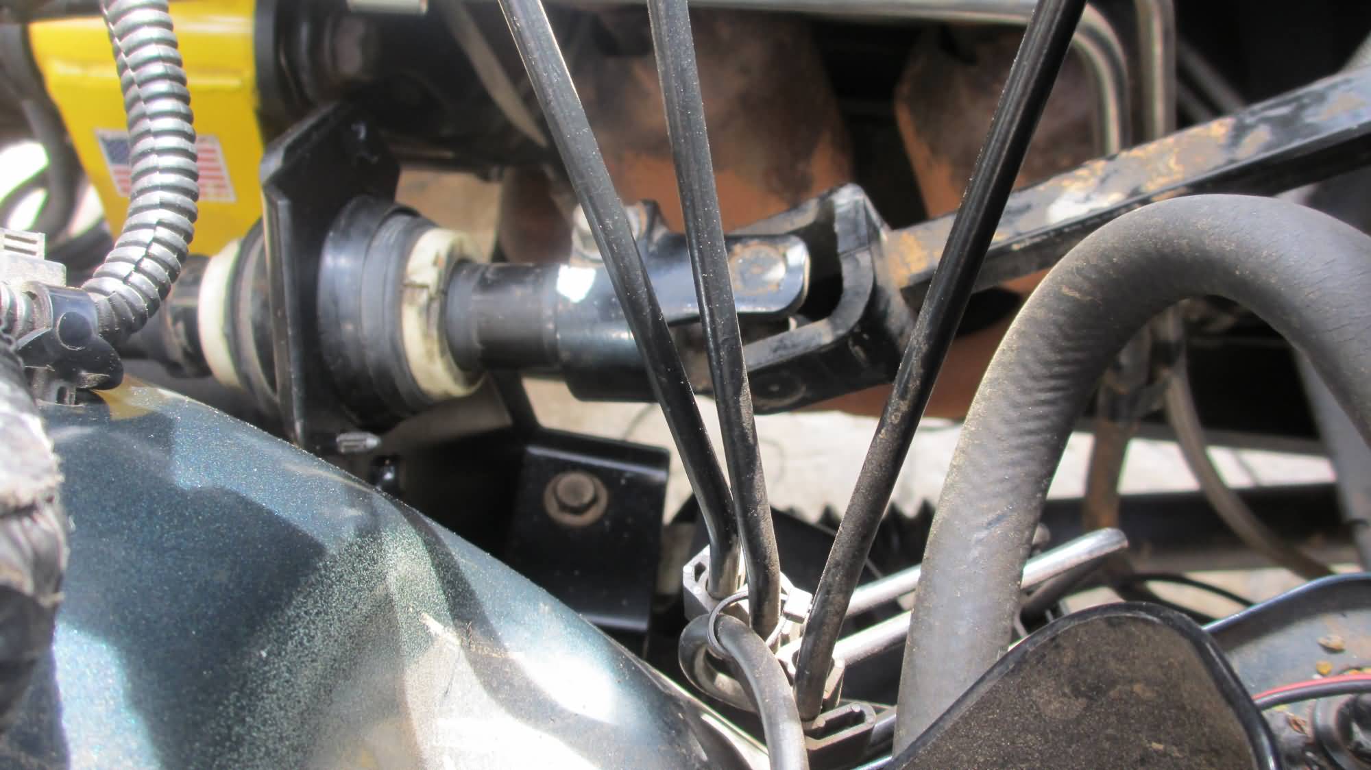

And the angle of the new bracket:

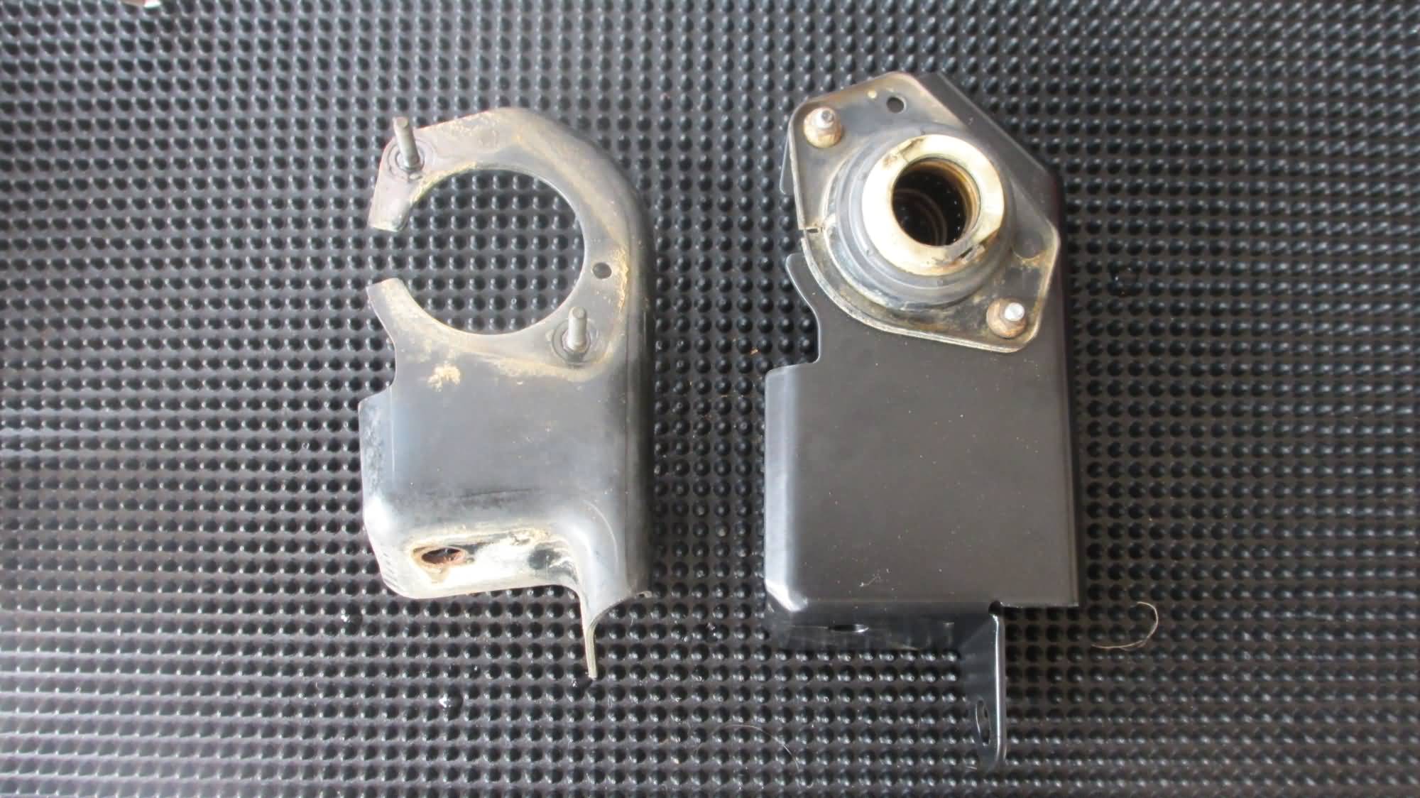

The stock bracket versus the 1" lift bracket:
So, if you've got a body lift and some wobbly / floaty felling steering, you may want to give this a try.
