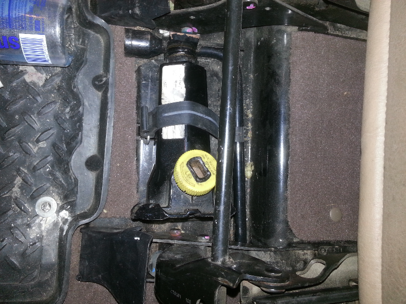

The two rods fit in a bag that is stowed under the door. The tire iron slides under the seat bracket with the seat flipped forward. I believe there is loops in metal they go through. Then screw the jack completely down. You will notice there is a hole on the baseplate. This hooks to the lip on the door side under the seat. The jack lay sideways to the center console in the seat brackets. Then screw the jack open until it jams between the brackets. There is a short rubber band with rings on both ends that clips on the floor towards the back and under the jack to over the jack to another hook in the metal on the jeep. If I could get a pic up, I'll edit this post with it.
Here you go
