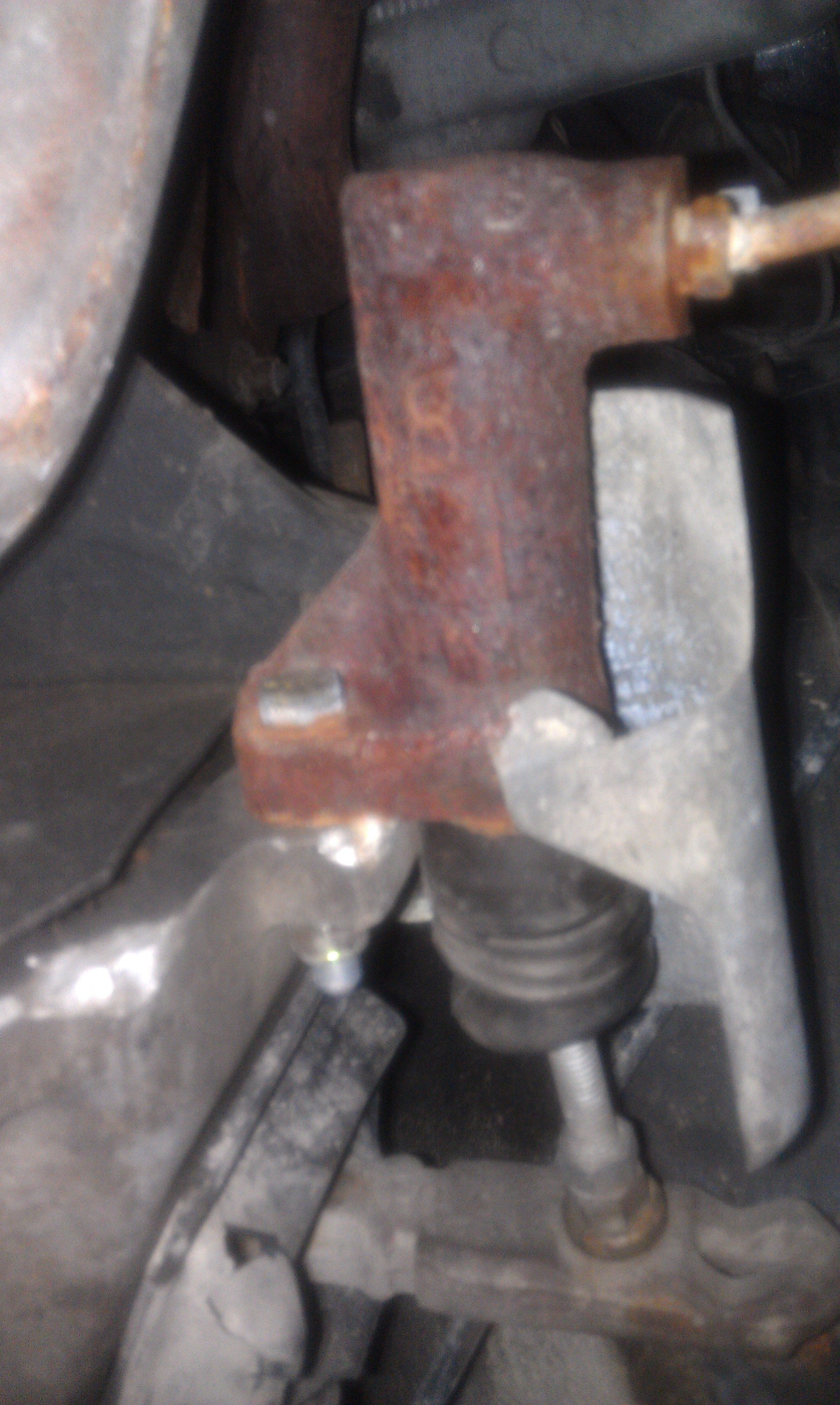

I have a jeep with a t5 transmission and dana 300 (twinstick conversion). I bought the jeep in as-is condition. When I got the jeep the slave cylinder was disconnected. Upon reconnecting the slave, I bled it out to be sure there wasn't air in the system. Now when I press the clutch in the jeep will not disengage the transmission. I know the transmission will go into gear and the jeep will move because if I crank the starter in gear it will move.
I've attached a couple of pictures. The slave seems to extend as it should, but the thing it pushes on rubs against the tub of the jeep near the end of the clutch throw. the slave push rod itself seems to be moving quite a bit, i would say as it should. I've attached a couple of quick pictures I took while under there. Any help would be awesome. First picture shows the whole slave, second picture shows the lower half of the first picture where it's rubbing.
