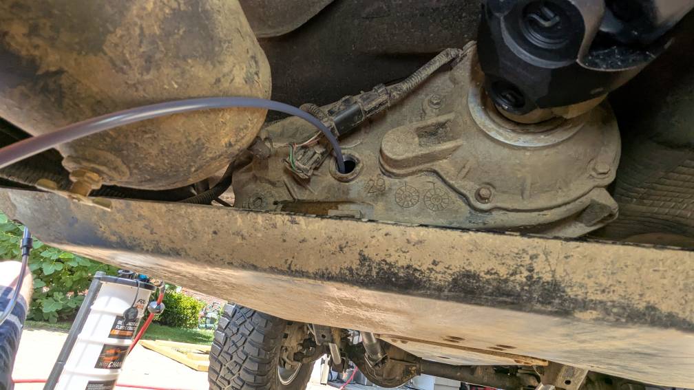

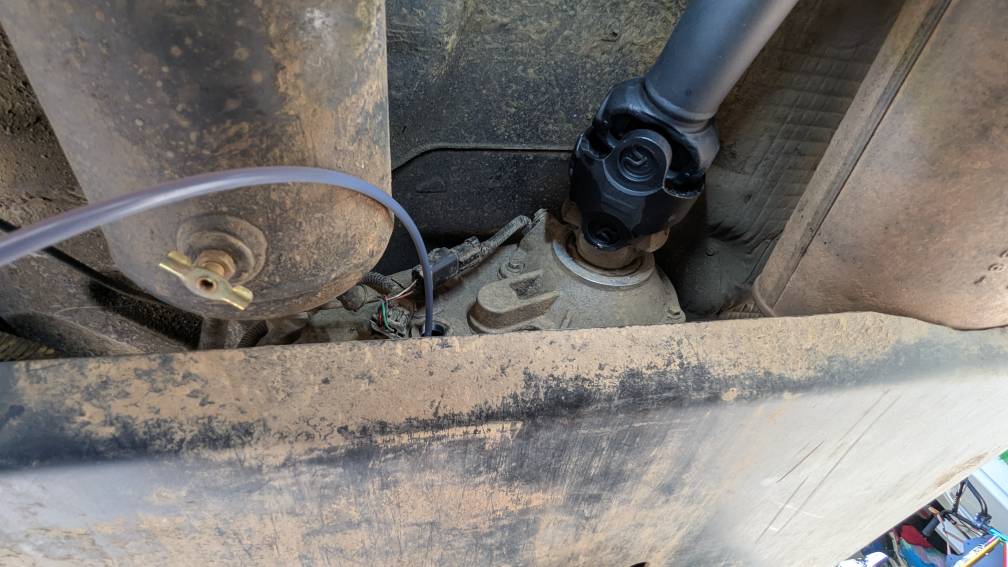

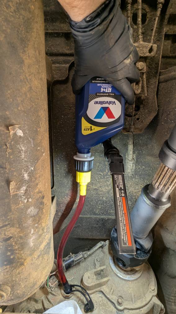

My owner's manual doesn't specify what fluid to use in my transfer case. I've done some google / youtubing and it looks like I should put about 2 quarts of ATF+4 in it.
I haven't changed the fluid in my tcase in about 10 years, so I imagine it's time.
Anyone able to verify this is correct (type and volume)?
Atf+4 same as transmission. App 1.5 quarts. Fill until it spills out gill hole.
