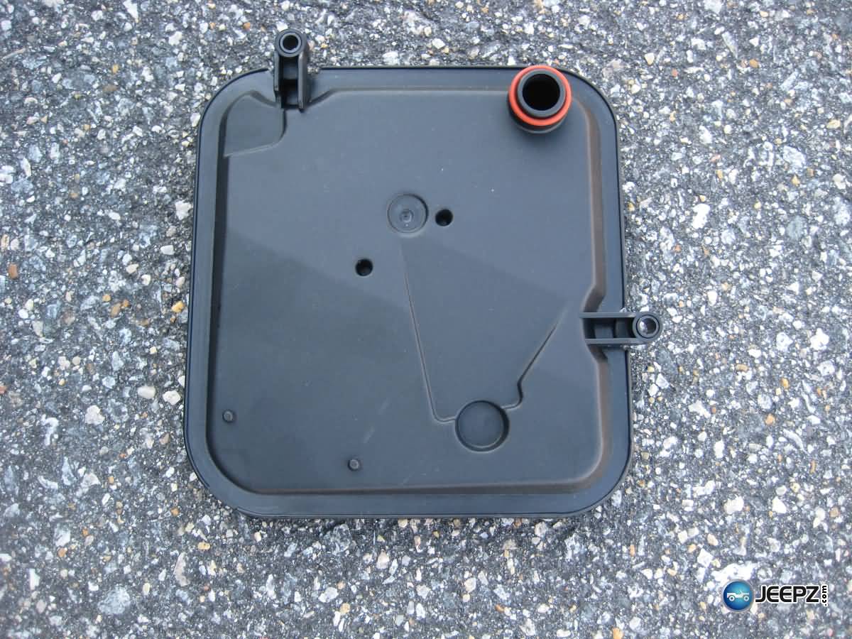

Contents of the Jeep transmission filter kit
This is what came in my Pro King FK-361 standard Wrangler transmission filter kit. A replacement gasket, a new filter, and an O-ring.

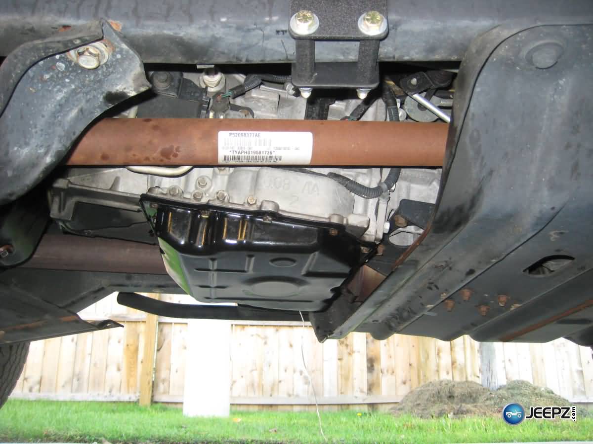

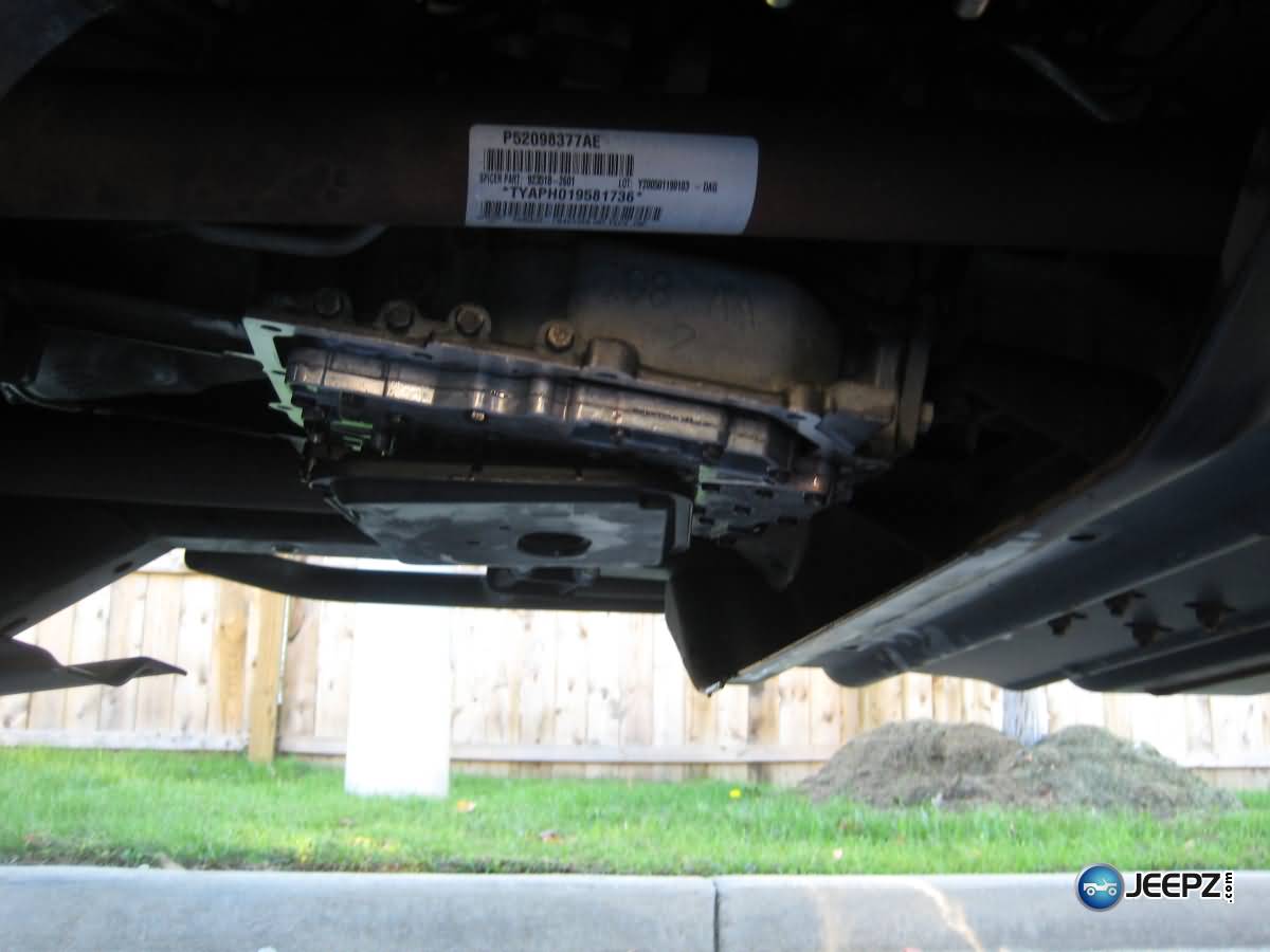

Removing the transmission skid plate
Step one is to remove the four bolts that hold the Jeep's transmission skid plate on. There are two larger bolts that connect to the frame, and two smaller bolts towards the rear.
As would be my luck, the driver side front bolt gave me some real problems. There appears to be a nut inside the frame itself that spun loose. The end result being that I couldn't get the skid plate off. I ended up using a long pry bar to bend the skid plate down, then I rotated the whole thing out of the way.

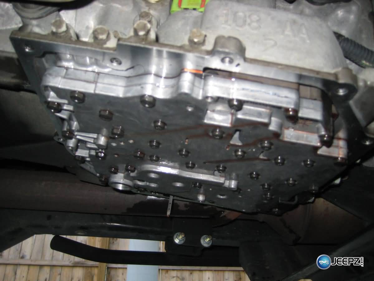

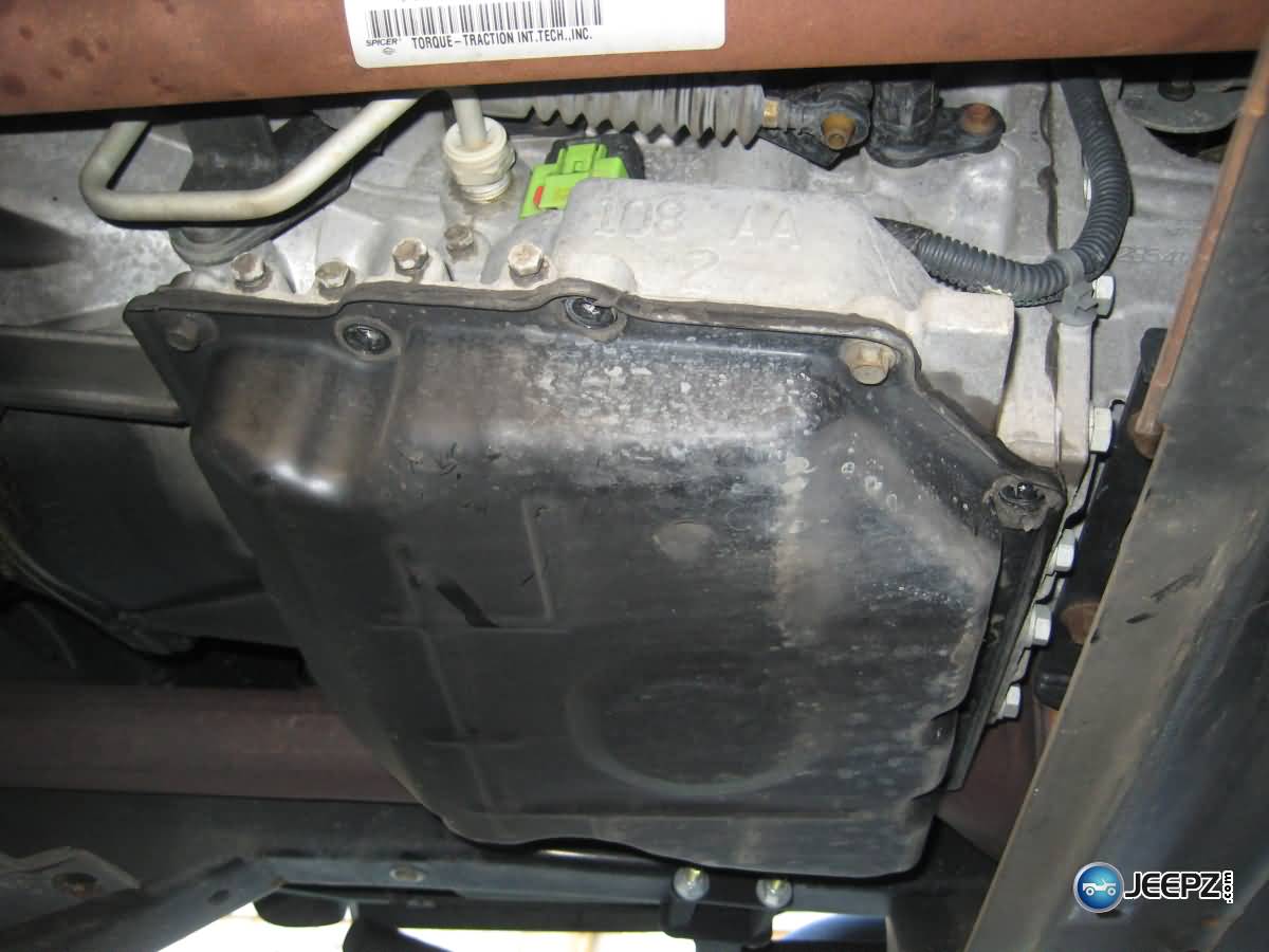

Removing the bolts from the transmission pan
Once the Wrangler's skid plate is removed, you can begin taking out the bolts that hold on the transmission pan. I left one bolt in each corner, and took all the rest out.

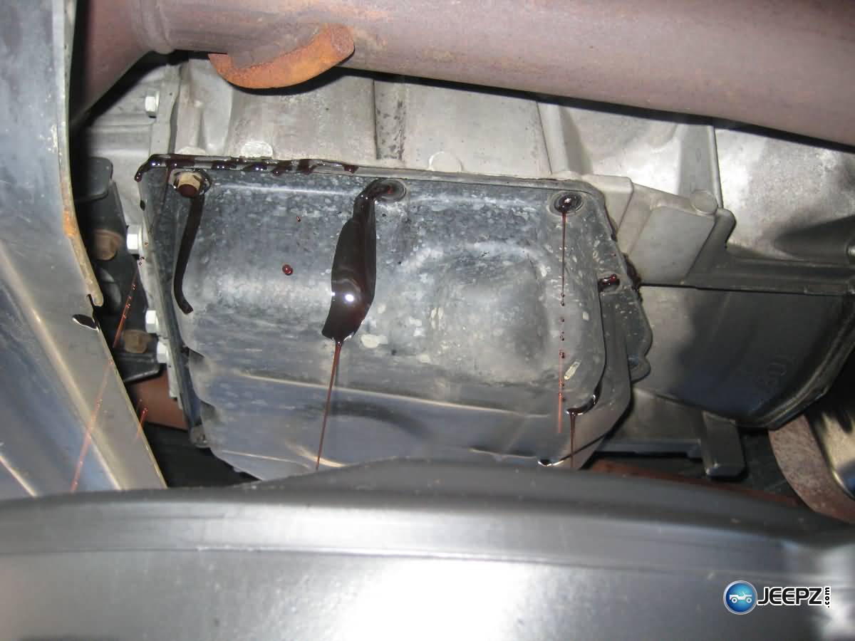

Removing the Jeep transmission pan

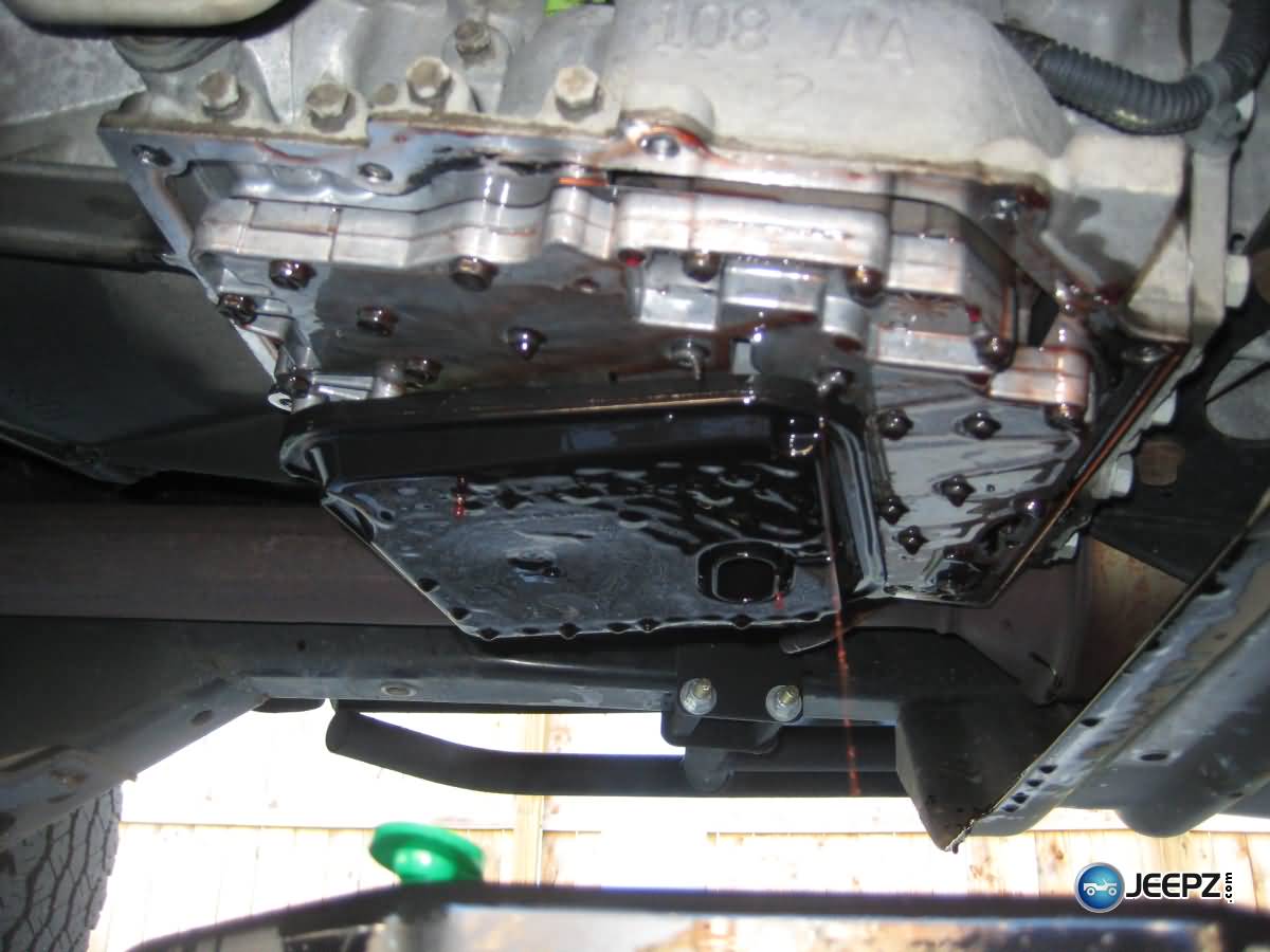

Carefully position your oil pan under the Jeep and remove two of four remaining bolts on one side of the Jeep. Chances are that the transmission pan will simply stay put - held on by the gasket, but be ready for a torrent of transmission fluid.
Once I was down to two bolts, I had to beat on the pan with a rubber hammer, then carefully pry it open with a screwdriver (don't gouge the metal!). The slower you go here the better. Once you have enough of the fluid out, remove the pan.

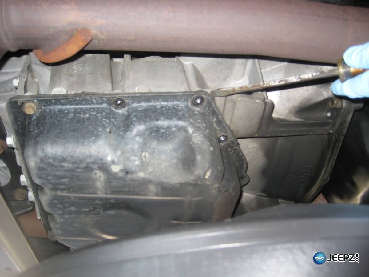

Removing the used Wrangler transmission filter
Now that the Wrangler's transmission pan is off, you can remove the filter. The transmission filter is held on by two small torx bolts. If you don't have any torx, you can usually make due with a hex key / allen key.

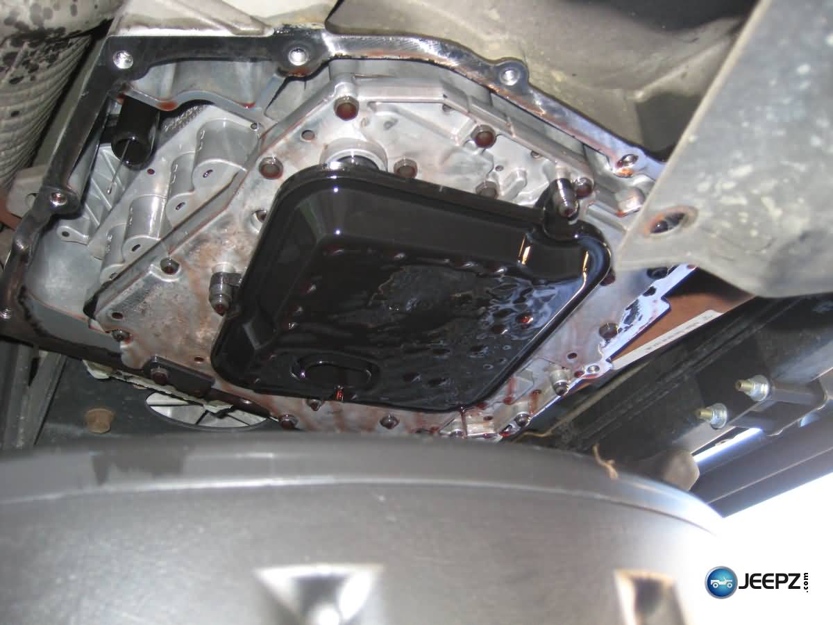

Installing the new transmission filter
Install the new Jeep automatic transmission filter, making sure to use the included rubber O-ring.

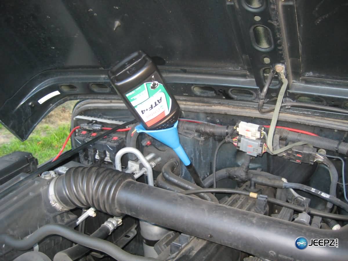

Now reinstall the transmission pan and the skid plate (don't forget the magnet that goes in the transmission pan - you have to take it from the old one). I then poured my used ATF into some containers - it turns out that I took out 5.5 quarts of fluid, so I put in 5.5 quarts of new ATF+4 as a starting point.
Then start the engine, chock the wheels, and shift the Jeep's transmission into neutral - this will cause the transmission to pump fluid. Let your Jeep warm up for 10 minutes or so, then while it's running, shift the transmission into park. With the Jeep still running, check the transmission fluid level. Top it off if you're low, and you're done!

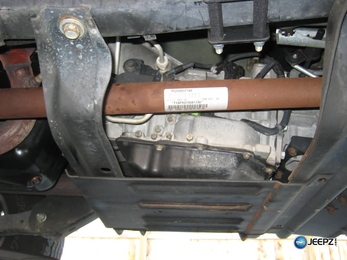

Hey TerryMason...I was thinking of changing the trans oil and filter and I have read other threads if you remove the skid plate you have to put a jack under the transmission, as it tends to drop some. I have a 2005 Jeep Wrangler Unlimited that looks identical to yours underneath. I was curious if this is something you had to do or did you just remove the skid plate and go at it??? thanks

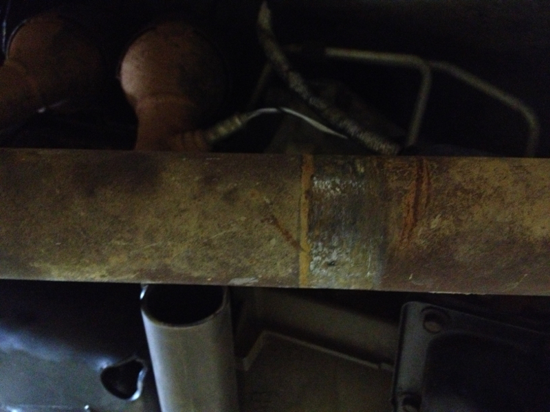

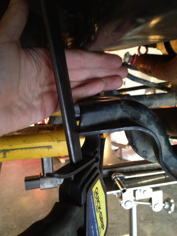

The stock skid plate is not attached to the auto transmission. You remove the front part of the plate to get to the pan that holds the ATF. I would show you a pic of my '06 Unlimited, but I had made a different plate to prevent it from rubbing the drive shaft. Something for you to be aware of if you have a lift (mine was 4") - the factory plate has a piece toward its front that connects to the driver's side of the frame. That piece will rub the drive shaft if you offroad/ disconnect the sway bar. I had over 2 inches that my drive shaft dropped farther once I removed that piece of the plate!!!
Here are pics I found of my old plate when I was removing it and the mark where it was rubbing the drive shaft. The pic shows how far down I had to drop the plate before it didn't touch the shaft!
