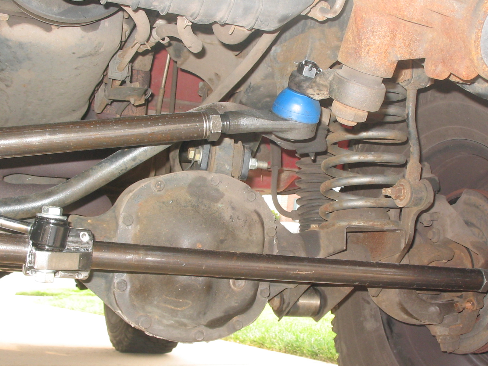

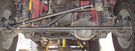

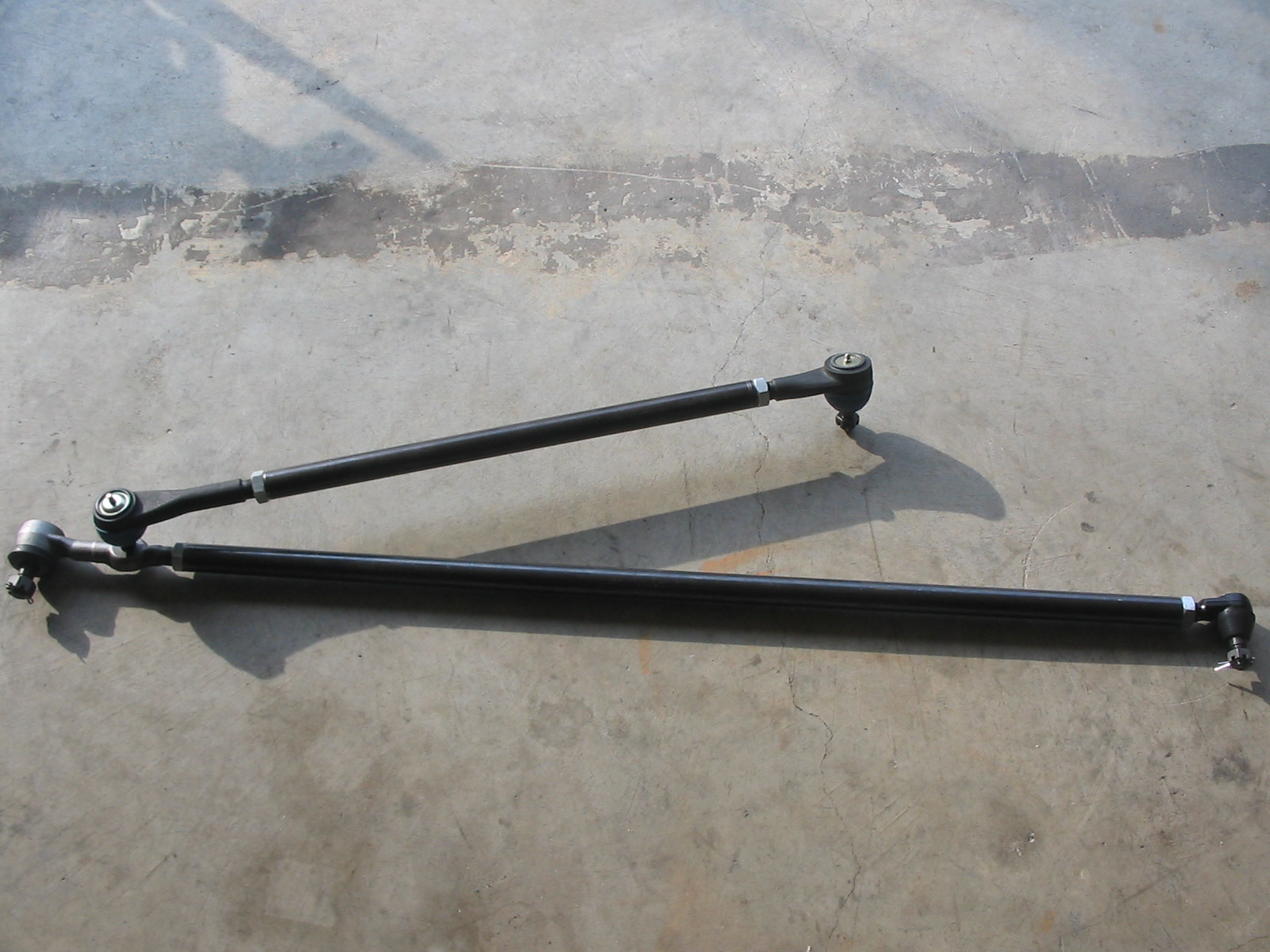

I just started to make the Jeep Wrangler crossover steering. They are strong and built right. Uses GM TRE's
The rods are a beefy 1.25" diameter DOM, with .25" wall; threads are tapped into the tube. This means (unlike a threaded insert) the TRE has full thread engagement into the tube for the length of its threads.
While I have had great luck not running a steering stabilizer one can be added. This kit will still allow you to easily align your steering.
Drilling and reaming is required of both knuckles and pitman arm.
This setup can be used for other models and years. Measurements will be needed.

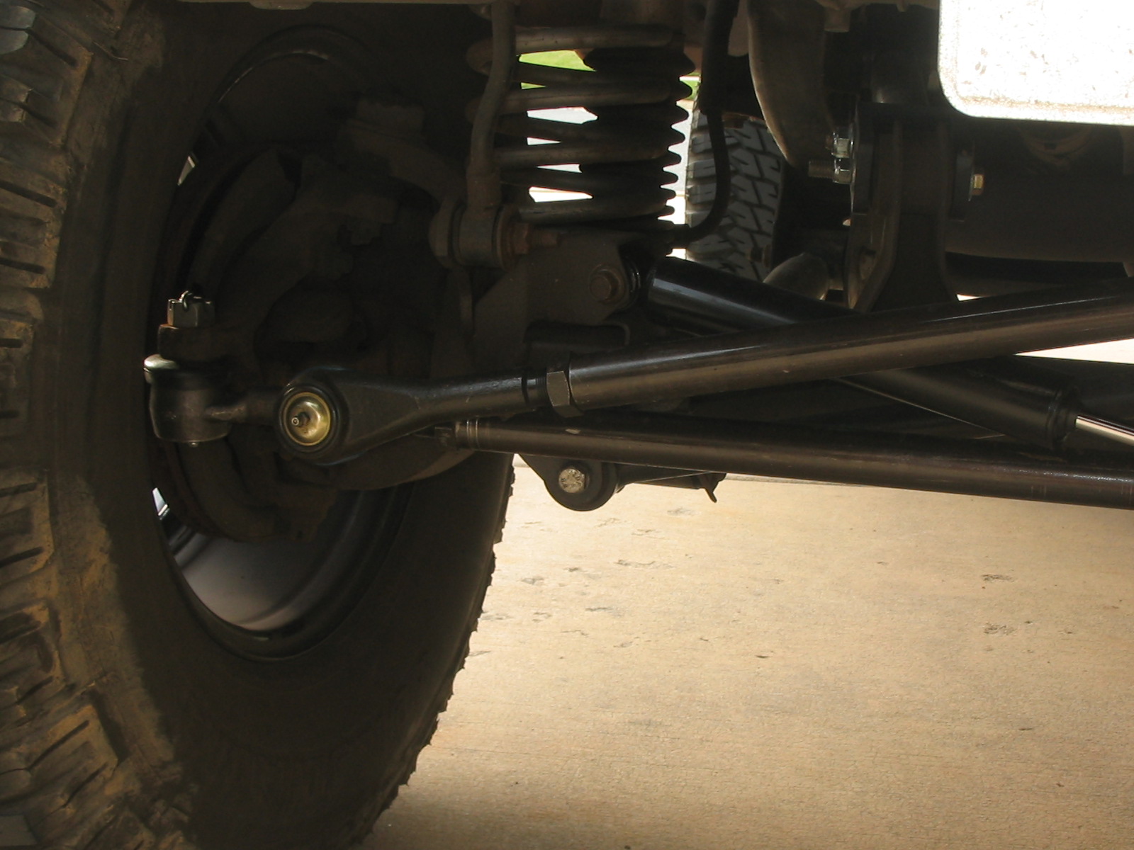

Does steering input twist the tierod before turning the Jeep? Any clearance issues at the axle or trackbar bolt when turned to full-lock?
If it does twist it's minimal. No issues with the trackbar bolt at all. I did have to adjust the steering locks out a little. Less than a 1/4" from stock. This set-up has been on my Jeep for about 6 months with no ill effects at all. Driving down the highway it stays straight with no bumpsteer.
