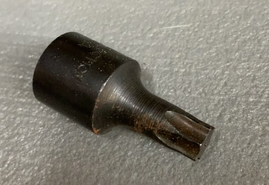

This?
My only recommendations on torx bolts are to be sure the dirt and paint is cleaned out first.
Then use a sharp end torx bit. So it fits down into the corners of the bolt. Otherwise it will strip.
Try loosening and tightening to get the bolt to move. You might try heating the bit red hot to help loosen rust or any thread locker.
