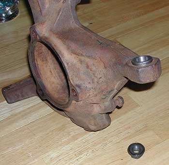

For about $50 you can buy three tapered inserts and flip the stock steering to the top of the steering arms.

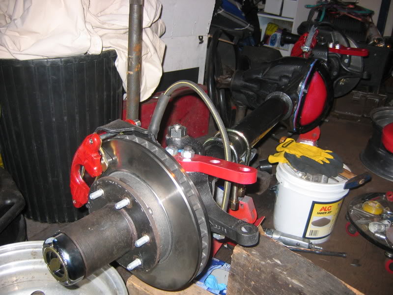

Here is my set up, ya it's a 44, so minus the steering arms cost about $150, the tubing 1.5 dia .25 wall DOM, simply drilled and taped for 7/8-24 thread and use moog F450 Tie rod end. Simply Ream my Pitman Arm, Ream out your knuckles (so that the tie rod ends sit above the ear) and have a killer set up. Or run heims.

http://goferitoffroad.com/products.htm is the tapered inserts to move your stock steering to the top of the steering arms. Cheaper than buying a reamer. $49 shipped to your door for 3 inserts.

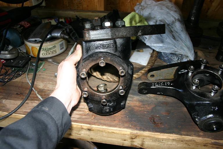

The knuckle pictured below is one of mine (for my 44). It was a brand new casting, cast without the lower arm, but has the flat top for the hi steer. You can see the steering arm bolted to the knuckle. You can see a factory knuckle on the bench in the back with an arm bolted to it.

Jesse, I do have flat top knuckle from a 75 chevy 1/2 ton.. I think I may have not described it clearly before, with a D30 (assumeing you still have it) you will use the stock knuckles but flip the TRE from under the ear to above the ear.. and with a SOA will give you a considerable amount of clearence.
Bounty Yes they make inserts to convert and other what nots.. I paid a local machine shop $5 to ream the pitman arm and the Hi-steer arms, and $16 for 4 tube ends drilled, reamed and tapped. so I am assuming that Joopin can also fine a shop to ream out his D30 knuckles for a similar price. (while in there, replace U-joints, unit bearings, upgrade shafts to TJ one piece etc...)
I prefered the beef of the 450 ends compared to the chevy, plus I only have to carry two spares instead of 3. and all the threads are the same (minus right hand left hand) so I only had to use two taps at one size.

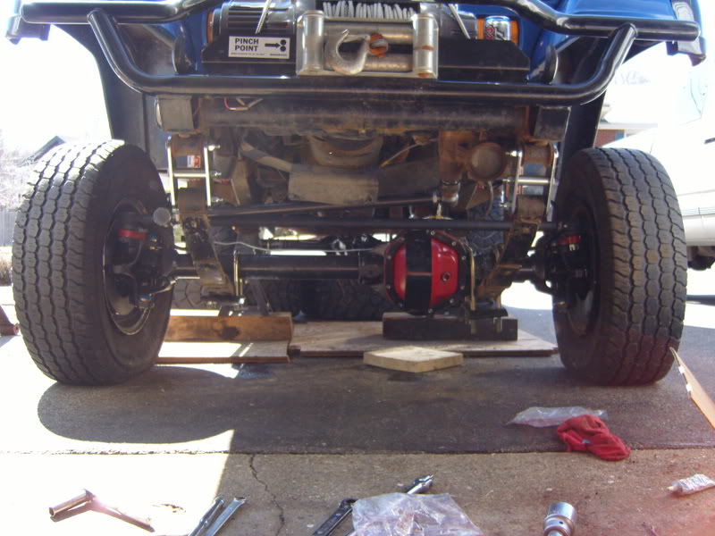

This is the best pic I can find of my set up, I like the knuckles corrupt has, but for $50 for the pair at the yard.. I can deal with the lower ear, plus I have yet to hit them due to the close proximity of the tire
