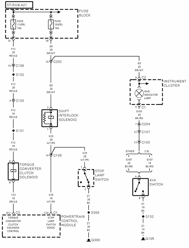

I have a 1997 jeep wrangler. Thr problem is that it keeps on blowing fuse #11. I have narrowed it to the torque converter clutch solenoid circuit. I have replaced the solenoid, drove it for a week and it blew the fuse again. I put 2 more fuses in and they blew. I disconnected the solenoid and no more blown fuses. The car sat for 5 days before ZI started to work on it again and noticed that the problem has went away. Could it be the PCM?
