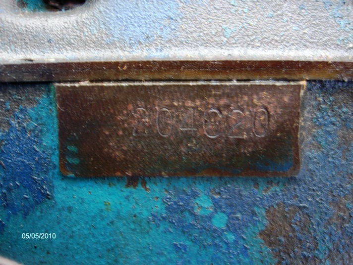

I just recently bought my first Jeep. It's a bit of a Frankenstein: 72-75 frame and 78 body. I originally thought the engine might be an '82, but looking at some of the decoders online, I'm thinking it might be the original '78. The code on the engine block is 204C20...2bbl carb, April 20th, 1978? I'm not sure what type of Carter is on there now.

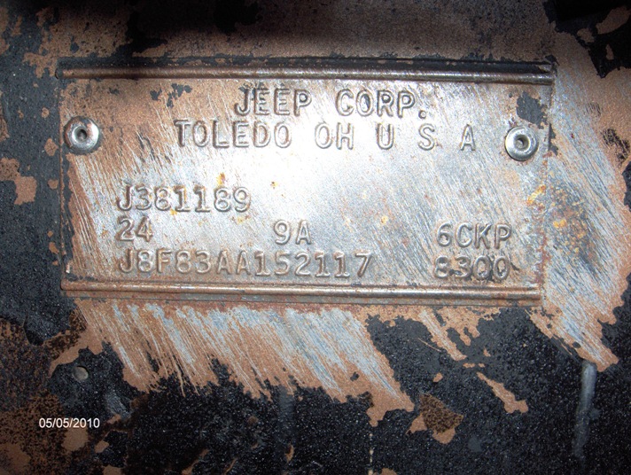

Here's my puzzle: I've researched the firewall aluminum tag to death, but what I've come up with gives me 1979 answers, not 1978. The only thing that confirms it as a 1978 is the VIN. The paint code and trim code are 1979, though. Here is the tag:
J381189
24 9A 6CKP
J8F83AA152117 8300
The paint code 9A breaks out to Alpaca Brown Metallic for 1979. The Jeep is right now spraypainted black. I scraped down and found it had been blue at one time, but I then found the Alpaca Brown Metallic on parts of the firewall, so that's confirmed.
The trim code 6CKP, near as I can figure, breaks out to Tan Levi's Denim, vinyl bucket seats. I had to piece the 1978 and 1979 codes together to get that, because the code doesn't exist, according to the decoders I have.

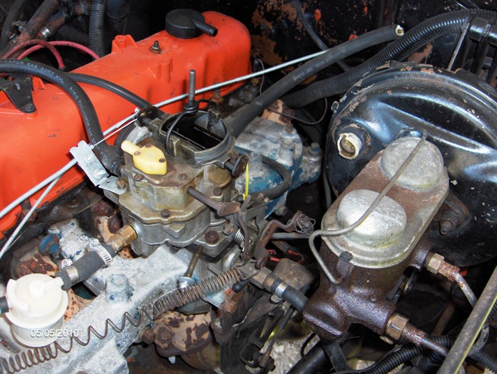

On edit: I just took some pics...here they are. Also found out that the Carter is a BBD...I've heard not so good things about these carbs. Were these used on '78's? There is no stepper motor on the back of the carb.

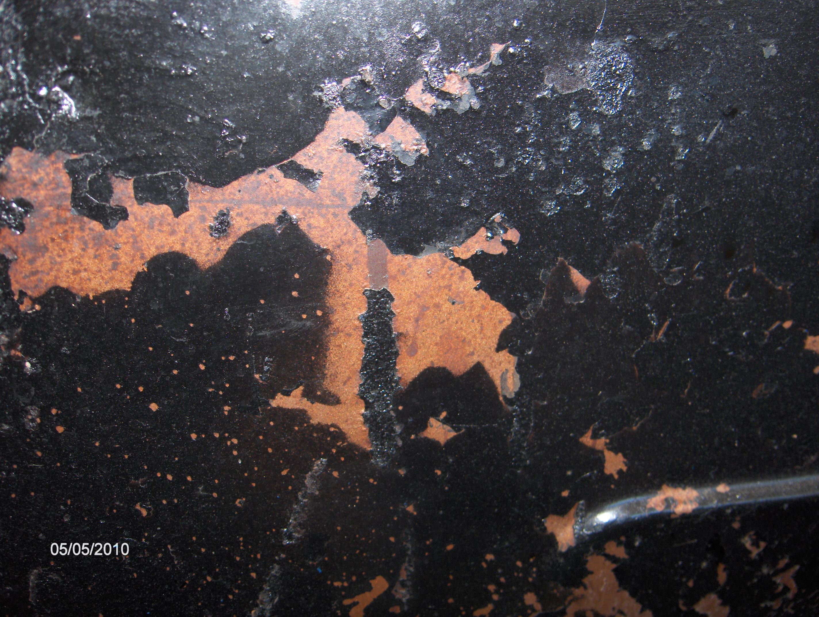

1) This Jeep was born as a Golden Eagle. It has the tach, the clock, and on scraping down some of the paint on the hood, I found the "g". It sure doesn't look like it did, when it was new, though.

4) According to the VIN, I should have a 1bbl YF carburetor. What I have is a 2bbl BBD. Also, the plastic valve cover tells me that the code on the side of the engine block, "204C020", means that it's a 1982 engine.

I just checked the vin tag on my '78. The jeep is currently in pieces waiting for a new body so I had to find the tag in the pile'o'parts(but that's another story. My paint code shows Pewter Gray ala 1977. I know the frame was built in june of '77. As with most things Jeep especially AMC era there was a lot of year to year overlap & mid year changes. I've found the tag codes to be more of a guideline than gospel.;) Anyway welcome to the world of Jeeps & good lick with your project. I like the idea of getting it running & having fun while working towads the ultimate goal.
