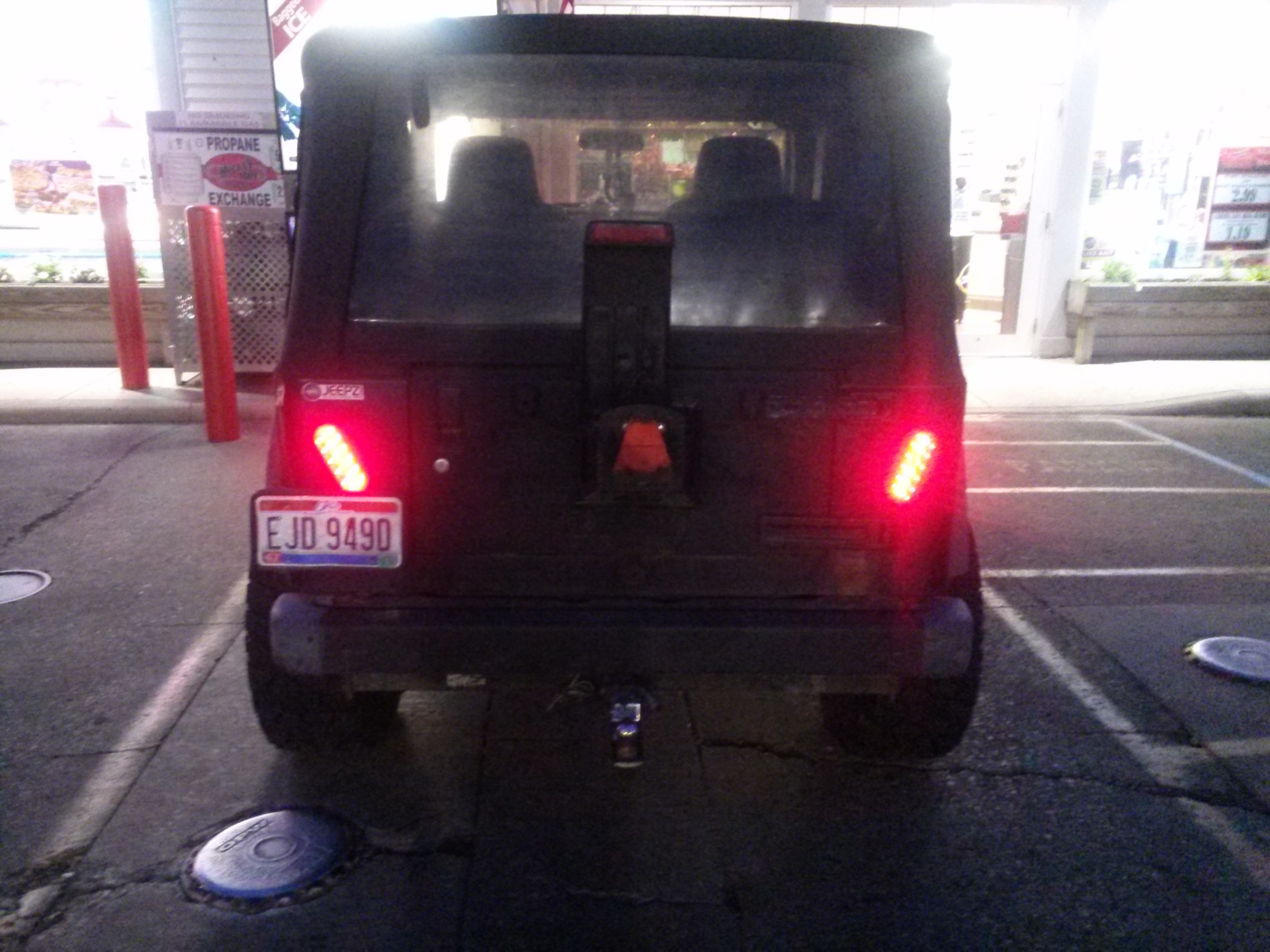

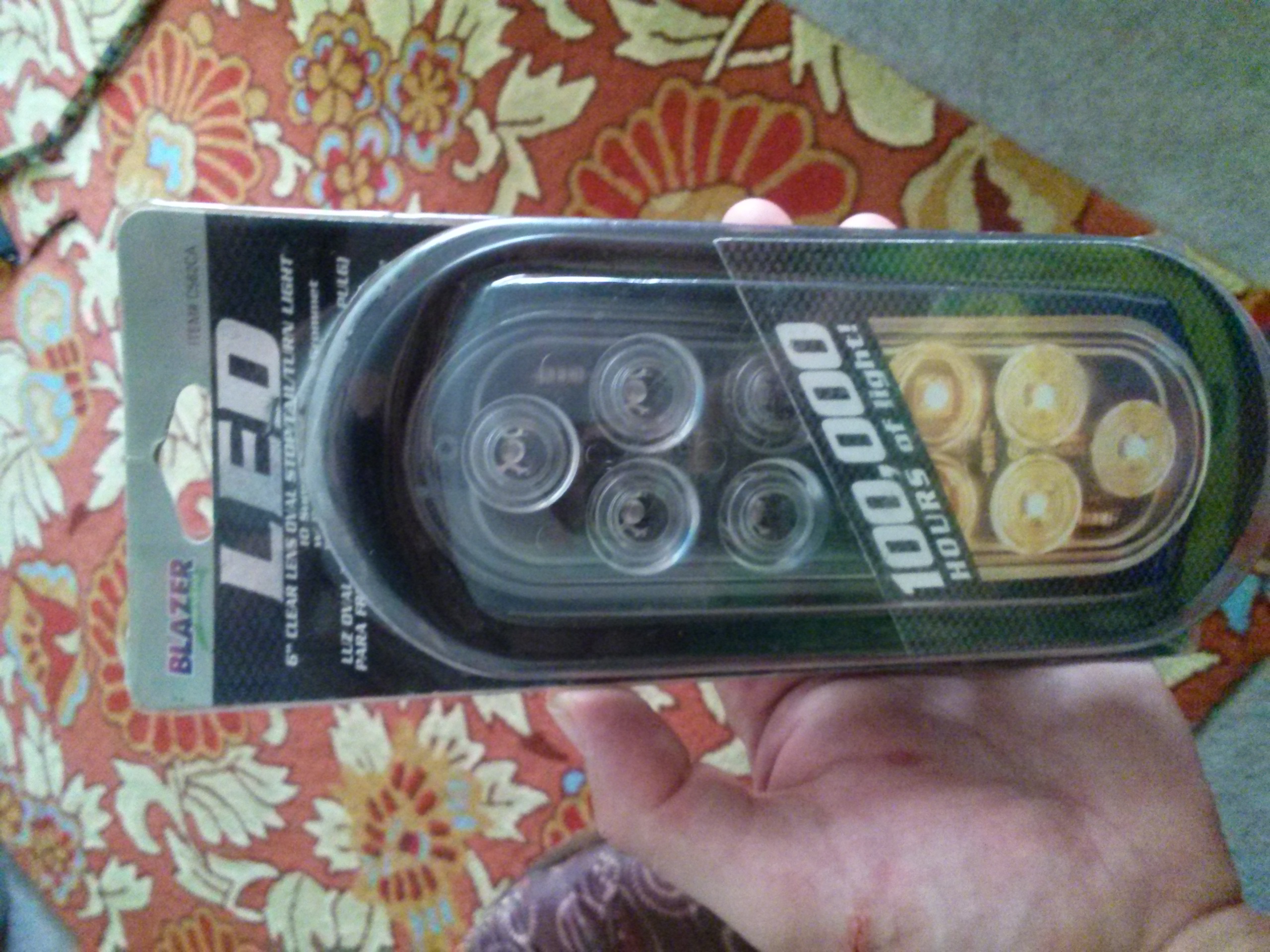

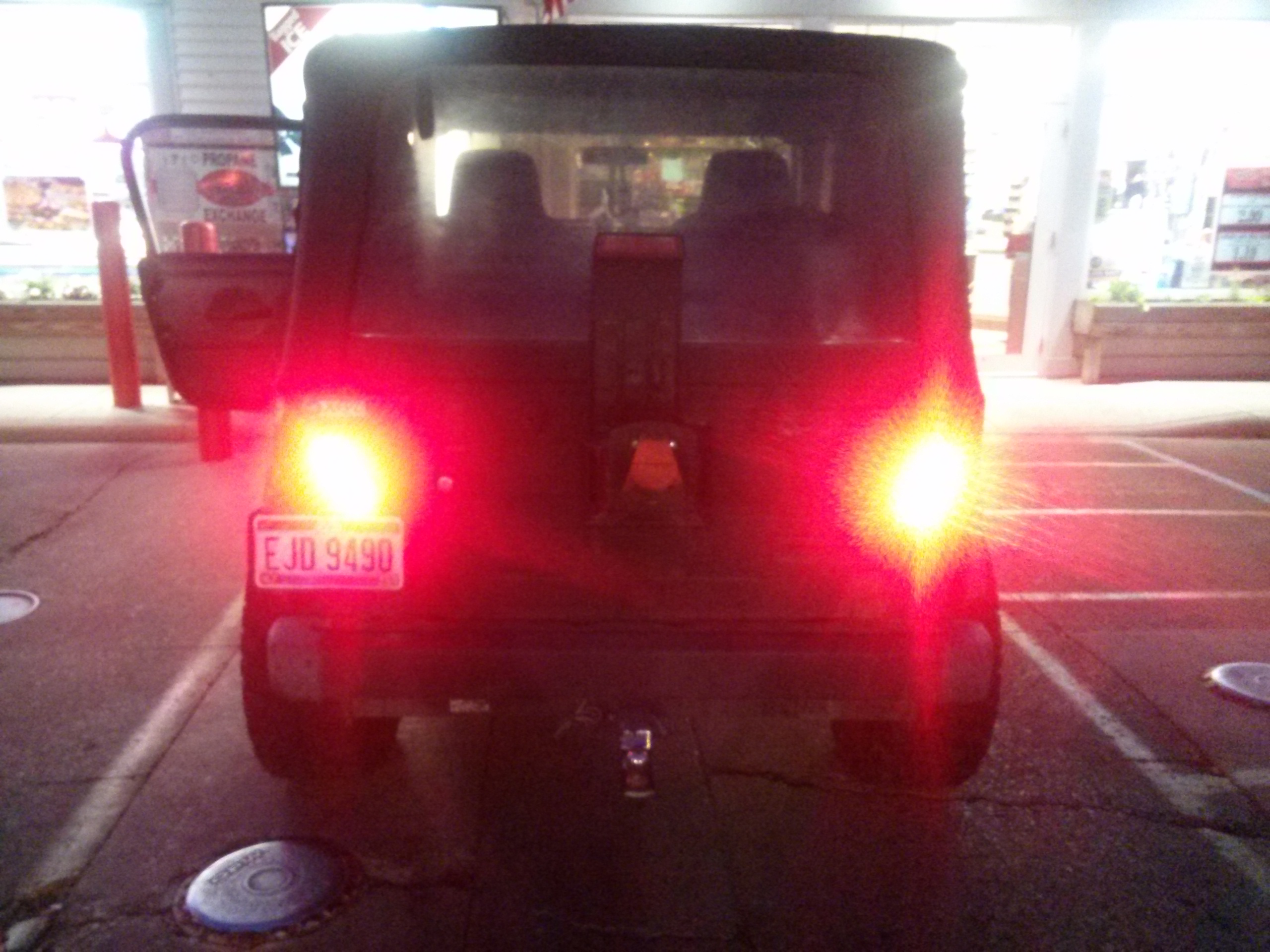

Well.... I'm going to assume you are replacing a set. If so, a new flasher for led light would be required. I went on blazers site. In their FAQ it talks about rapid flashing lights and replacing the flasher. Other way to tell is just hook me up and try it. If they flas Sent from my iPhone using Jeepz
