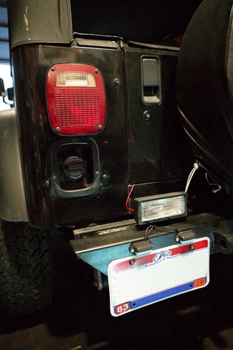

Here is the relocated license plate with lights and Back-Up lights.

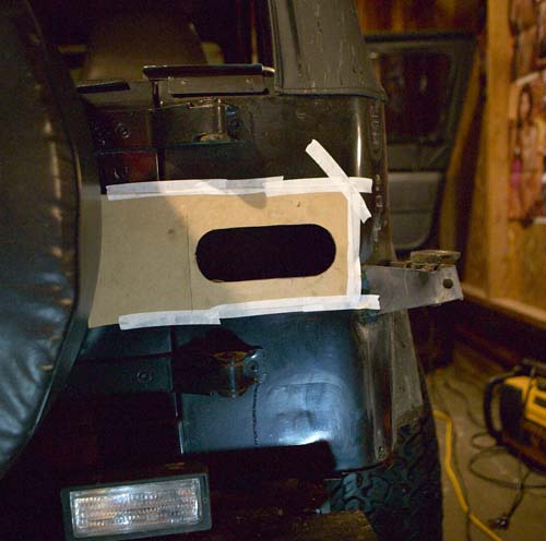

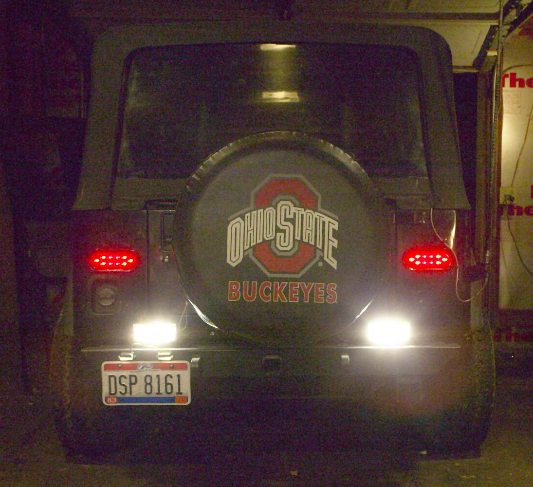

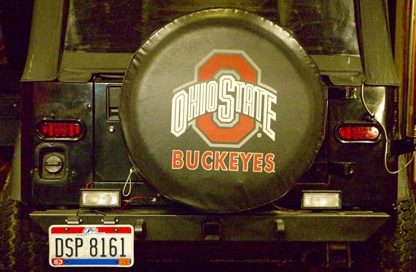

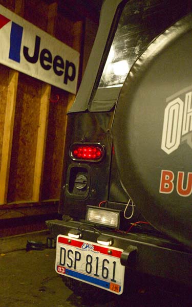

Well finished up last night. Flasher worked last night but then half way to work today stoped working. I'll pick up another EL 12 to see if it was a bad flasher. But here are some pics.
