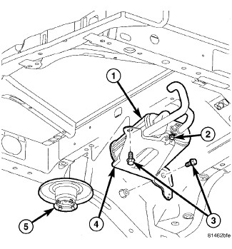

Went looking for the canister a while ago and couldn't find it. Seems like it's down below the passenger side fender well where the windshield washer reservoir is. Otherwise, I couldn't locate it. Also, while I was at it I couldn't locate the spark plug wires on this thing either. Does it even have any? :lol:
If it is like the earlier models, the canister is located Forward of the gas tank, above the rear axle. Lay under the rear of the vehicle looking up and you will see it. There are a couple hoses that go into it and one of them is prone to failure. I have repaired two of them on two different KJ's. If you see cracks in it, its bad.
Yup!
The EVAP canister (1) is located near front of fuel tank and next to the left/rear spring perch (5).

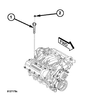

The 3.7, 4.7 and 5.7 engines uses a C.O.P.(coil on plug ) system.
Each coil (1) is mounted directly into the cylinder head and onto the top of each spark plug. This eliminates the use of ignition wires and gives it a more positive ignition performance .
Thanks for the help and information fellas. This really helps as this is probably where the leak is. :-)
Oh! I almost forgot to thank SteelHeadz for the pictorals, especially the spark plug information.
I'll post an update as soon as I take the time to crawl underneath the vehicle and snoop around the canister area looking for leaking hoses and such. I'll let you all know what, if anything, I find.
