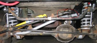

Anywho I have a problem, RE 5.5 lift, guy told me that I didn't need a dropped pitman arm...however picture below shows some knuckle already hit the swaybar link end and bent over my pin.
Will a dropped pitman arm fix this? or anyone else have other ideas

Could you take a pic of the front end back far enough to see the whole steering system?
front end. Might have track bar problems too, however if I adjust it either way it'll cause the axle to be off center.
That's where the tierod connects to the draglink, I've got RE 5.5" coils on mine and it doesn't hit there. A drop pitman arm should remedy that, but you want to make sure that with the drop pitman arm that your draglink and track bar are still parallel.

Think an alignment will fix it? I mean, the track bar does look over extended to me, but axle is center.
It looks to me like the tarckbar abd draglink are not parallel. With the trackbar's bends this can be confusing, so I circled the image below where they should be. It appears (emphasis on appears) that a small drop pitman arm may help out this alignment issue and also the problem with the draglink hitting the swaybar link.
Usually they dont recomment a drop arm until 6" of lift, but you are close to that now anyhow.
I forget which stock arms are which, but Snitty could probably tell you if a ZJ or WJ arm would work for a 1-2" drop ;)

I seen 'em on rustys they have 1.25" drop and 3" drop, but not sure what drop to get. So what you are saying is that the draglink should almost cover the trackbar in the picture? or do you have a picture of the way it should look.

This was mine with around 4.5" of lift on it. Same trackbar I think (RE1600???) and I did not have that problem. It looks about the same as yours. The thoery is that the trackbar and drag link should be parallel, but it you are not having any bumpsteer or DW issues then I would be leery of putting on a drop pitman arm.
Are you certain the axle is centered?
Axle looks really center. Again, i still have to get it all aligned..going thursday.
by parallel you mean....like photo one:
or photo two, as in parallell that the drag link should cover the track bar at the same height?
Could always see what the clowns at the alignment place thinks. Just wanted to be able to drive it there without tearing the grease fitting bubble.
Then again, the plus of your father owning a tow truck company. hehe
Photo one, but like I wrote before, it's tough to say parallel when it has so many bends.
Break out the measuring tape to check the axle being centered. It can be deceiving.

Should both front shocks be at the same angle? If so, then couldn't you measure the angle of each front shock to determine if the axle is centered? If the axle was off center, the shock angle would be greater on one side and less on the other, right?:?:

It would be easier to find a centerpoint then measure to each end of the axle tubes
