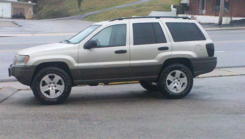

Lets hope not! On my wj im leaning towards the IRO. The xj like i said is gonna be 3" and prob 31" tires, i think it will give it a personality. Its a 92 laredo with only 150k .

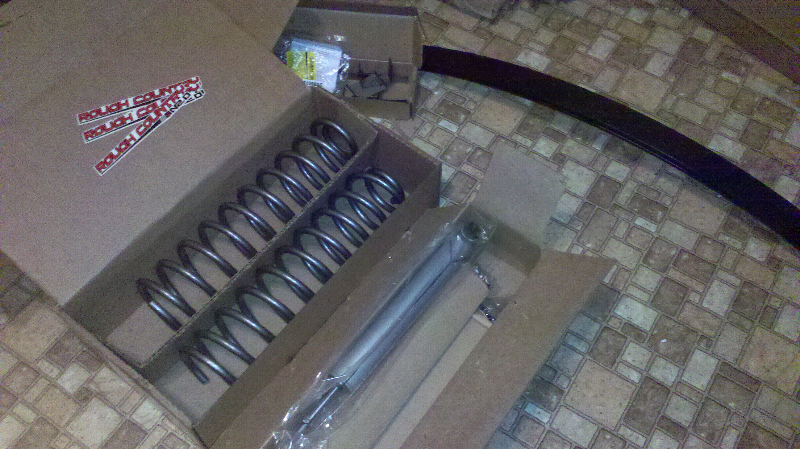

The lift came in today for the xj! Hope to have it thrown on tomorrow night or saturday evening, still tryin to find a set of 31"s :p

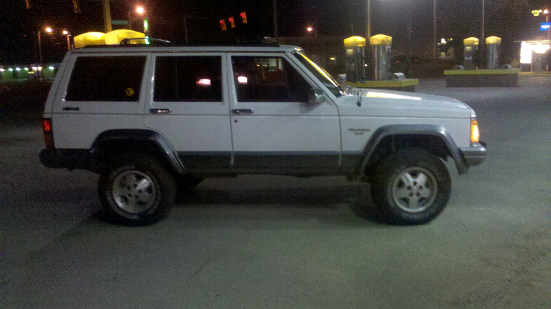

Looks good, Installed the lift on our xj last night after work, turned out nice. Gained a little more than 3" but expecting it to settle. Found a set of 31x10.5 that i will hopefully get in the next few days.

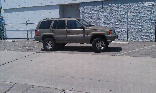

Desertrunner, the Jeep in the pic is a Zj.
