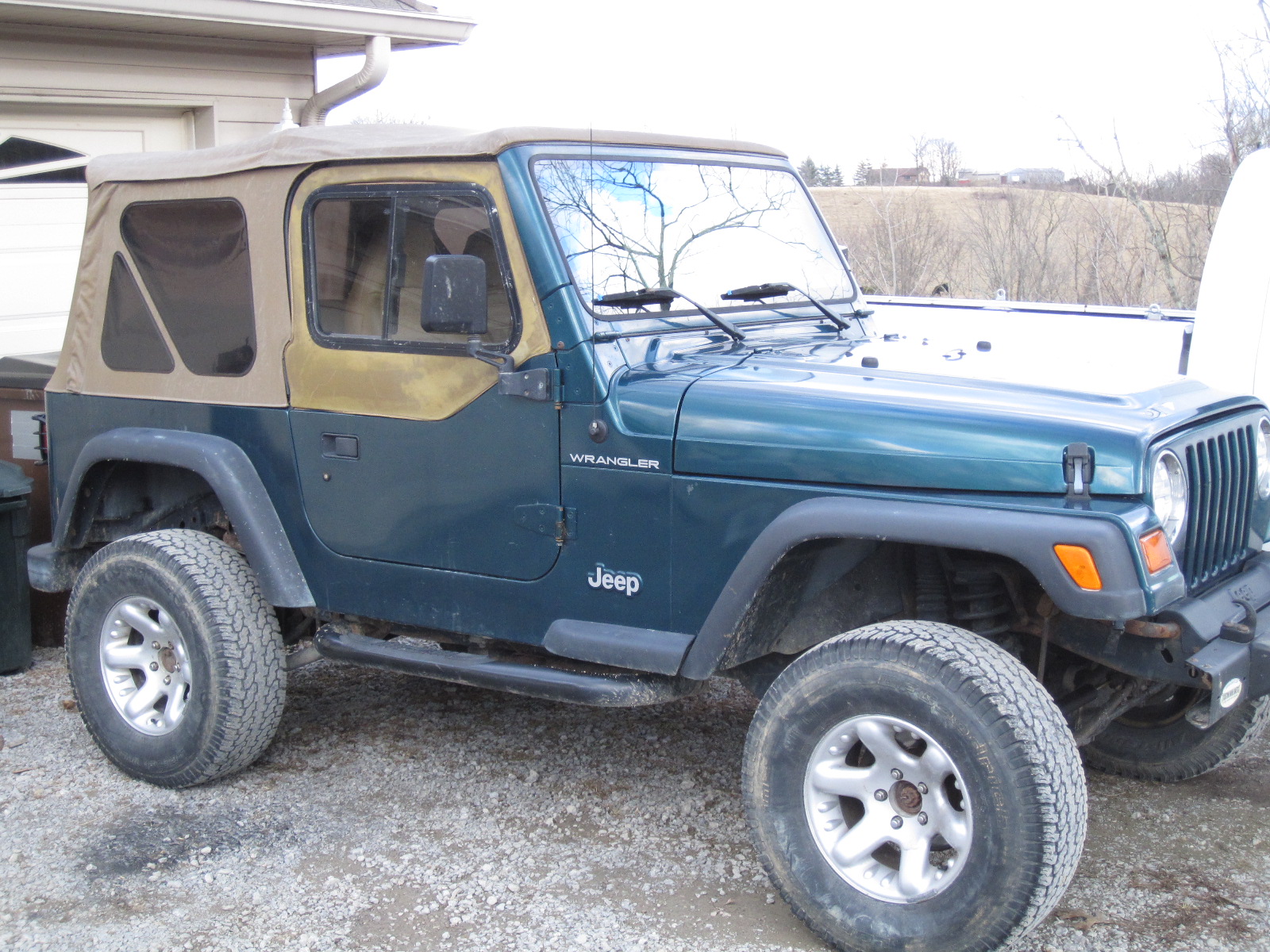

I've read you can take a measurement from your spring ends and subtract a number and that will give you your lift height. Upon looking at the huge space between the top of the tire and the wheel well I'm not sure I "calculated" the correct height. These are 31's and they do look tiny when you stand back and look at things.
So, does anyone out there have a 98 TJ with 31's and a known height? If so, what is the measurement between the top of the tire and I guess top inside of wheel well?

I can as I just put new shocks on... so that won't help much. I'm leaning towards a 4" lift as it has a BDS lift kit and from all indications it would be 4".

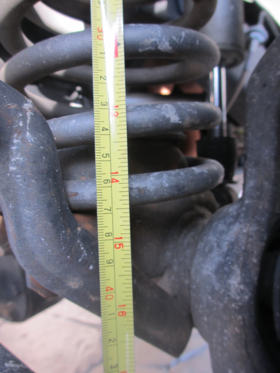

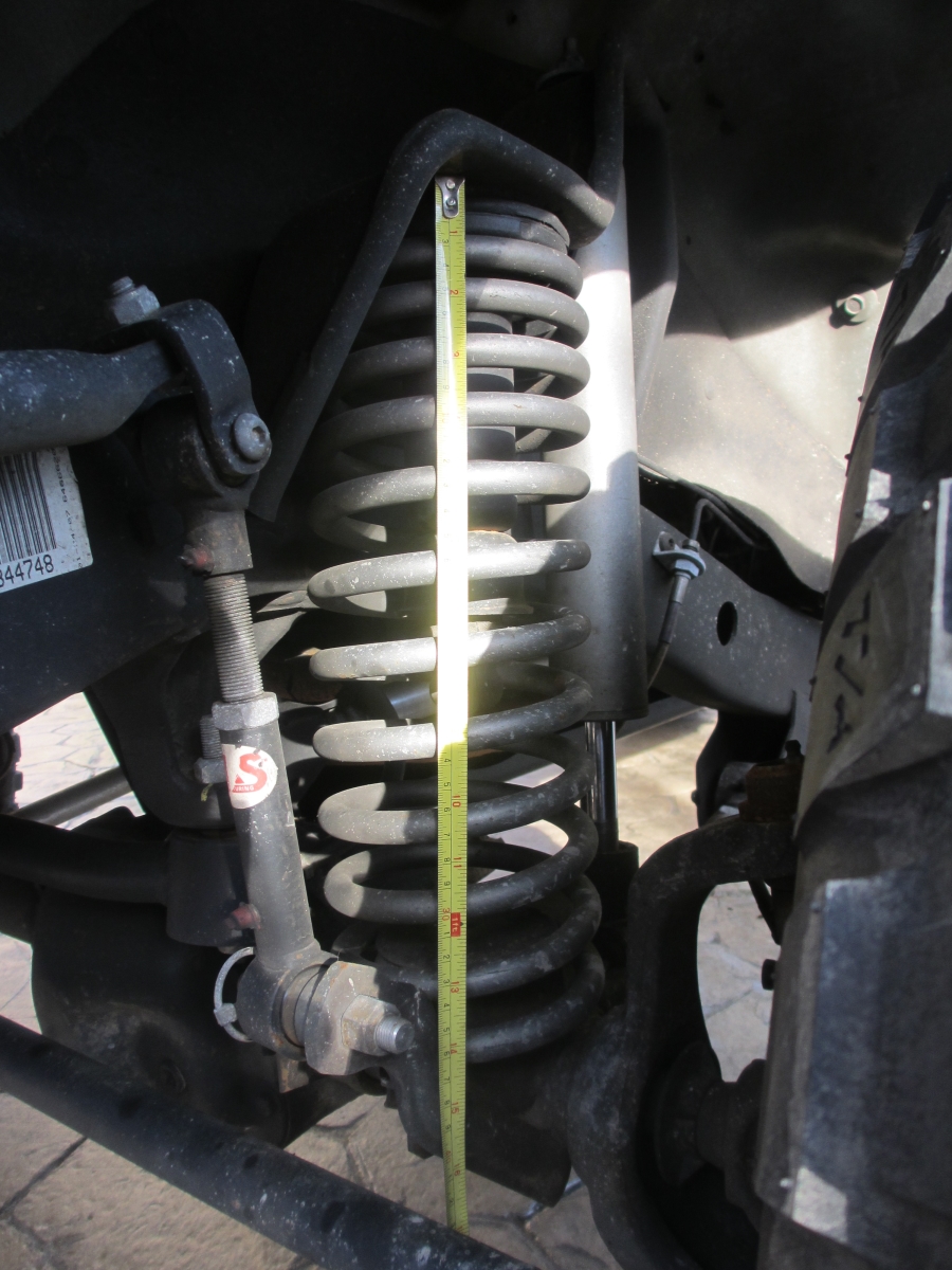

I'll measure my springs tonight. I'm not sure if that will be very exact, but we'll give it a try.
I'm running some Rough Country 2.5" lift springs that are a couple of years old. They seem to be about 14.5 inches in the front
You will have a good chance of ripping off shock mounts offroad if you run too short or too long of a shock from bottoming the shock out or over extension. I have seen it happen on cj's and wranglers. You probably have a 4" lift, which is common on wranglers for fitting 33's
ooops, just noticed you have a tj not yj so im not sure about the 4" as im not too up on the tj,s. the shock advice still applies though.
