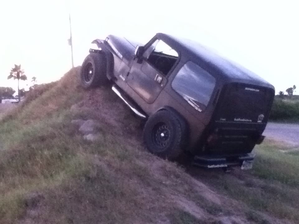

I have 5/8th boom shackle on mine with trimmed flares and I am running a 265/75/16 tire which is a 31.5.
As you can, it rubs when one aid of the axle drops and weight is on the back. For normal driving, it doesn't rub
I like that pic, thats about what im looking for. little bit bigger tires with a small lift. But id like to add some bush wackers on it. just a bit bigger than factory...
