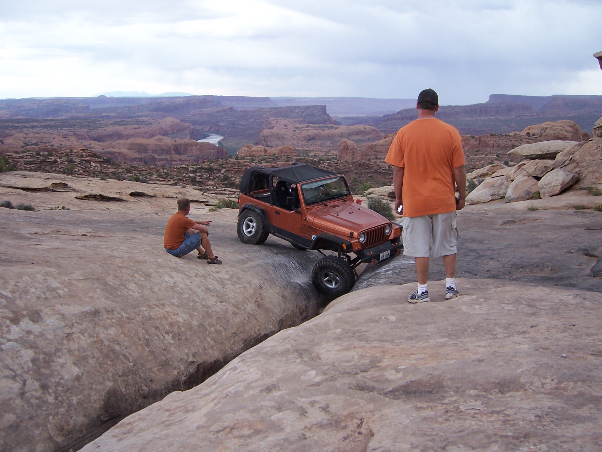

I run a Tera-flex long arm kit. IMO long are is the only way to go.
The street ride is better than stock and off-road...

I paid around 1700$ at the time. The company has made several changes to its lift kits since 2001. But this is one of the most important things your going to add to your jeep. I always tell people to wait till you can afford the best kit you can buy.
Your lift kit determines how your jeep rides on and off-road.
