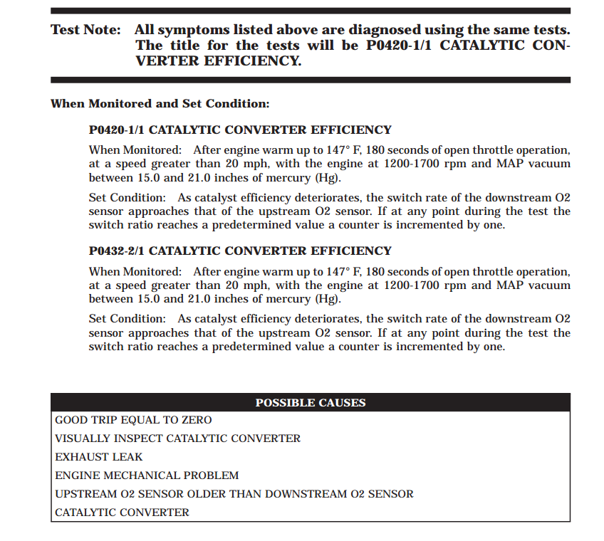

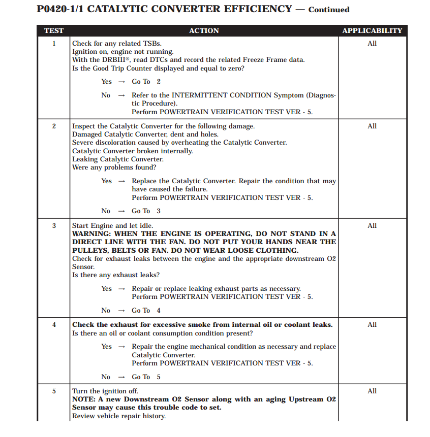

04 Jeep Wrangler 4.0 5 speed manual. It's losing power in all gears and 5th gear it won't rev and won't go above 44 mph. Any ideas on what it could be?
