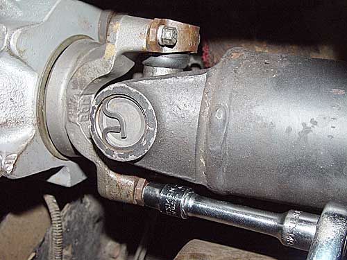

This leads me even more to believe that it is the front DS. As Bounty said, remove it and give it a shot. To remove, you only need to remove 8 small bolts, so you can do it yourself in about 5 to 10 minutes...
Here you can see the bolts you need to undo:

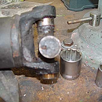

And if it is the U-Joints, you can also change them yourself. Remove the 2 snap rings from the drive shaft yoke ends.

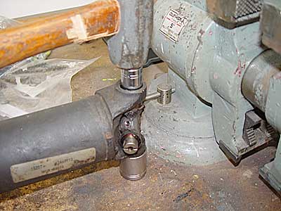

Support the drive shaft so it's sitting level with the 1-1/8 socket facing open side up on the bottom. Place the 11/16 socket on top of the bearing cap and tap it down until the cross contacts the bottom of the drive shaft yoke. Then use a BFH until the cap on the opposite side is out.
Basically, something like this:
Remove the cap and try to get the U-Joint out (you may have to get the second cap out in much the same way... only using a smaller socket set).
