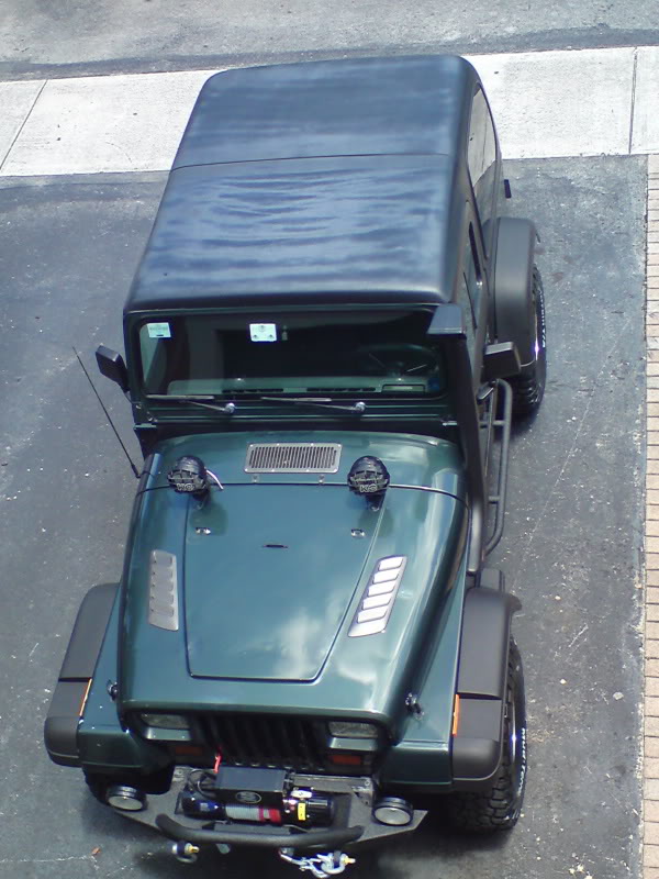

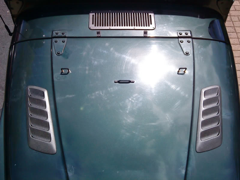

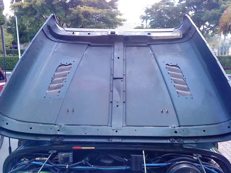

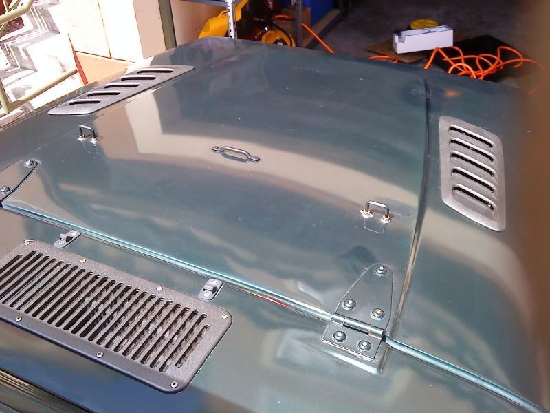

I put some on mine, and they do help keep the engine bay down. Even when parked, you can feel hot air coming off the engine bay. I do expect, though, that it does not work as well standing still as it does driving at 55mph. By the way, I went the junkyard way with mine; I got some Pontiac GTO ones that were $20, painted them and installed them with 3M automotive double sided tape. Have been on for over a year now without issues.

Keeping the engine bay cooler means that if your intake is in the engine bay (I have a snorkel, so it does not apply), you are breathing cooler air, which helps increase power. Also, the components under the hood will not deteriorate as fast (I did mine because I got tired of changing cracked vacuum lines).

Thanks. I think for under $30, I cannot complaint for the louvers!

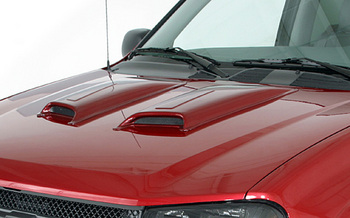

i added hood scoops like these on my xj with 2 small electric fans forcing air in helps some at slower speeds there on a switch in the cab they run me $95.00 with the fans
type in hood scoop in google theres lots of places to get them
easy to mount they use double sided tape mine have been on almost 8 years and a 3 inch hole saw to cut out holes in hood to mount little fans
