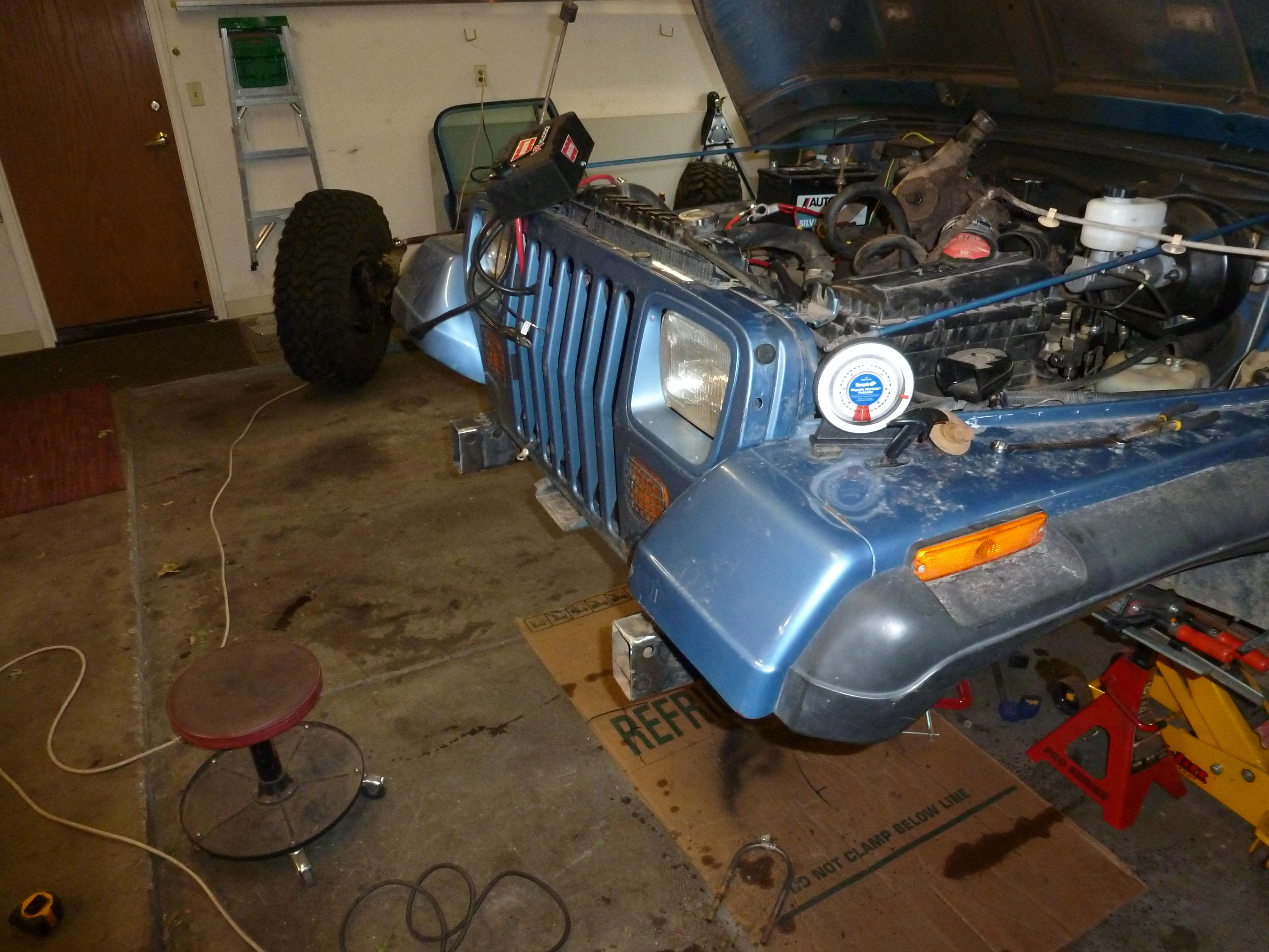

Made some very good and bad progress today on stretching the front.
Plasma cutters are fun!
Cut just behind the round frame brace which ended up being 4 inches back instead of the planned 2 inches back which would be an difficult cut and reweld through the middle of it. This will prove a problem later.
New front end welds in nicely. First problems notices are the clevises are too close the shackle bolts. No big deal just annoying.

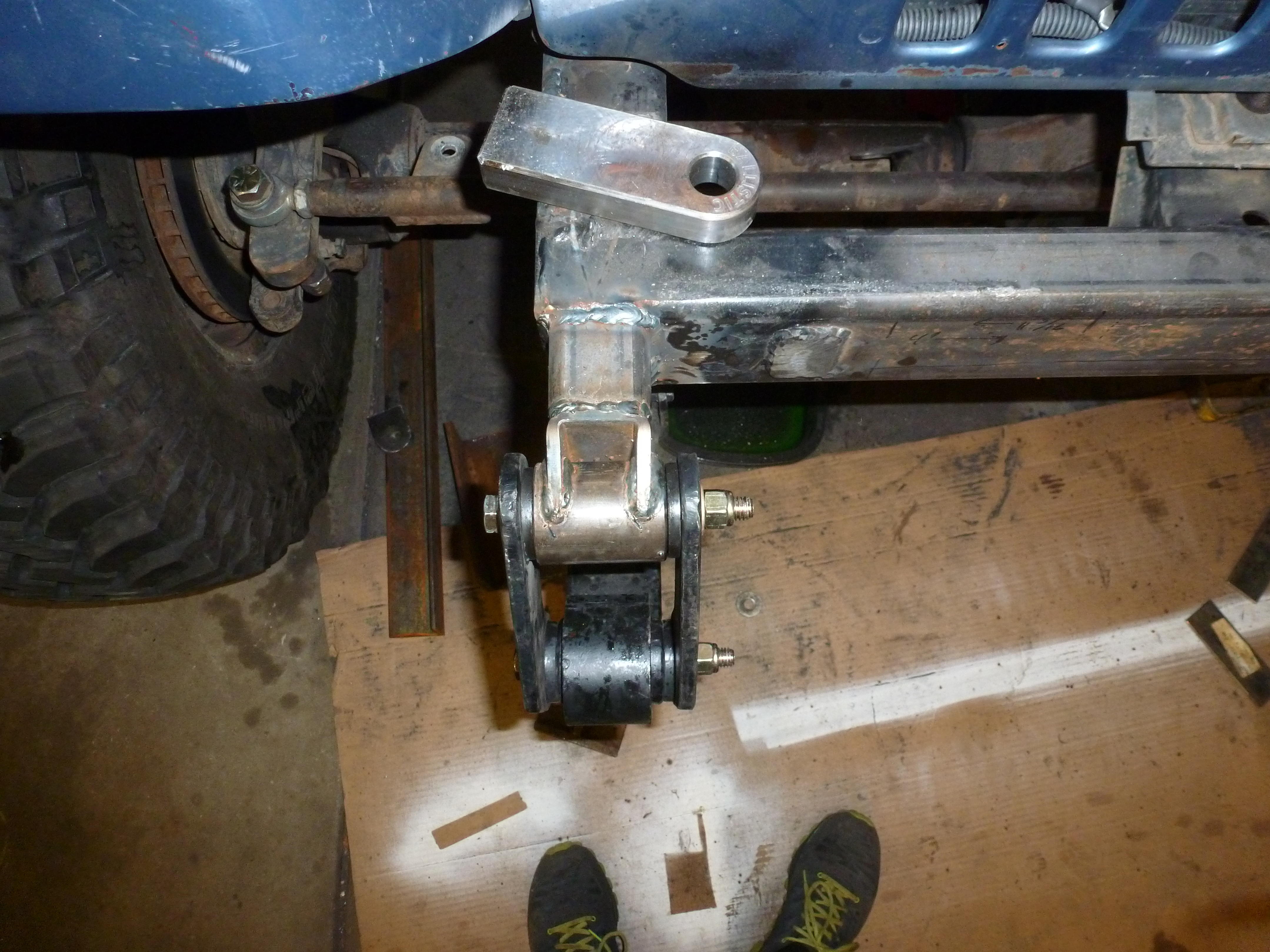

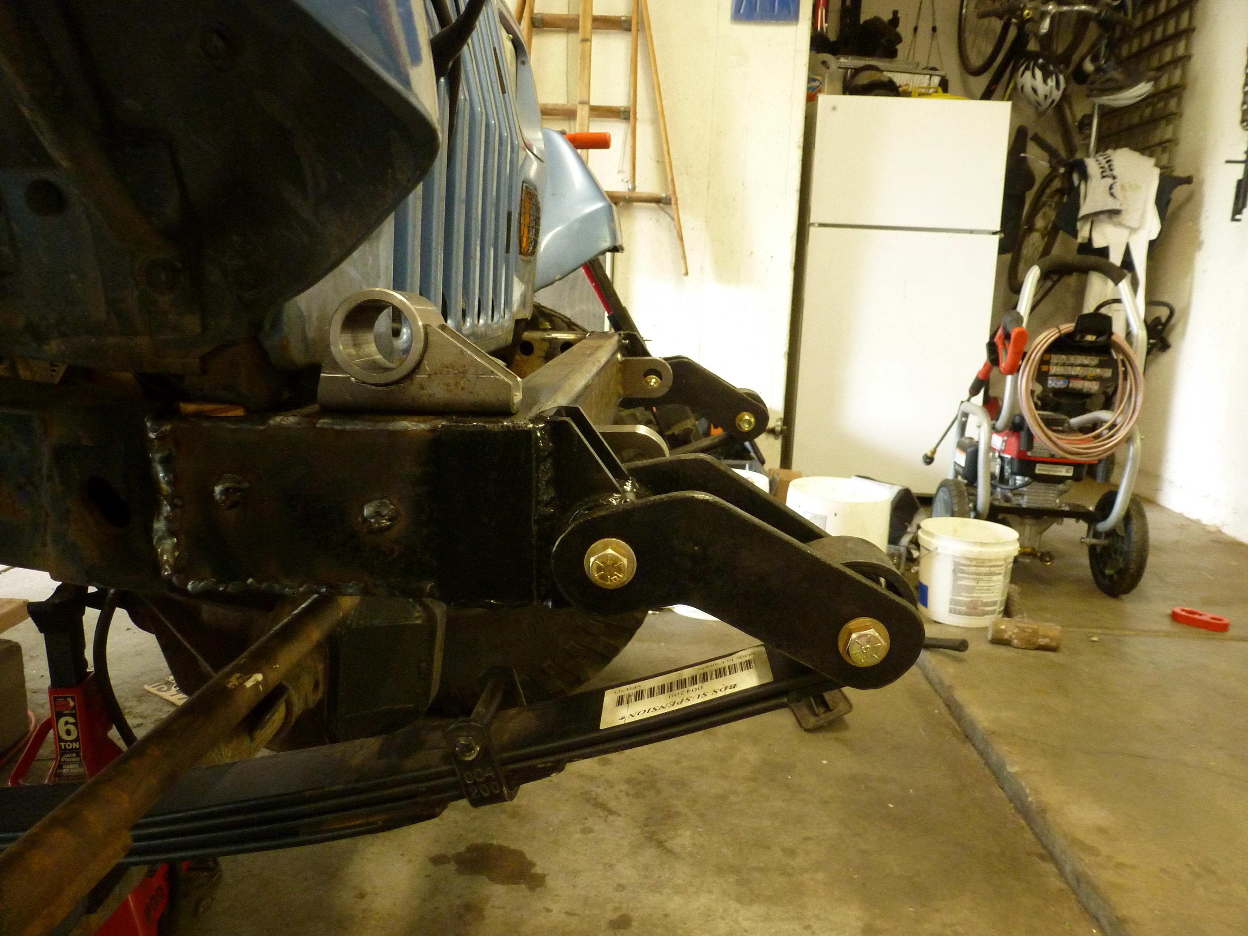

The spring hangers are welded to the surface of the frame instead of frenching them in. WAY easier. The hangers are 6 inches forward and 3 inches up eye to eye from stock. On went the springs along with the home make boomerang shackles. Placed the spring perches on the axles and lowered the setup into place...
#@%&@$# the shackle angle is at 70* from vertical. I dun f***ed up. I was aiming for 30-35*.
After slamming a quick beer and some choice words we figures out the problem was the extra 2 inches off the frame for the easier cut and neglected to replace those 2 inches.

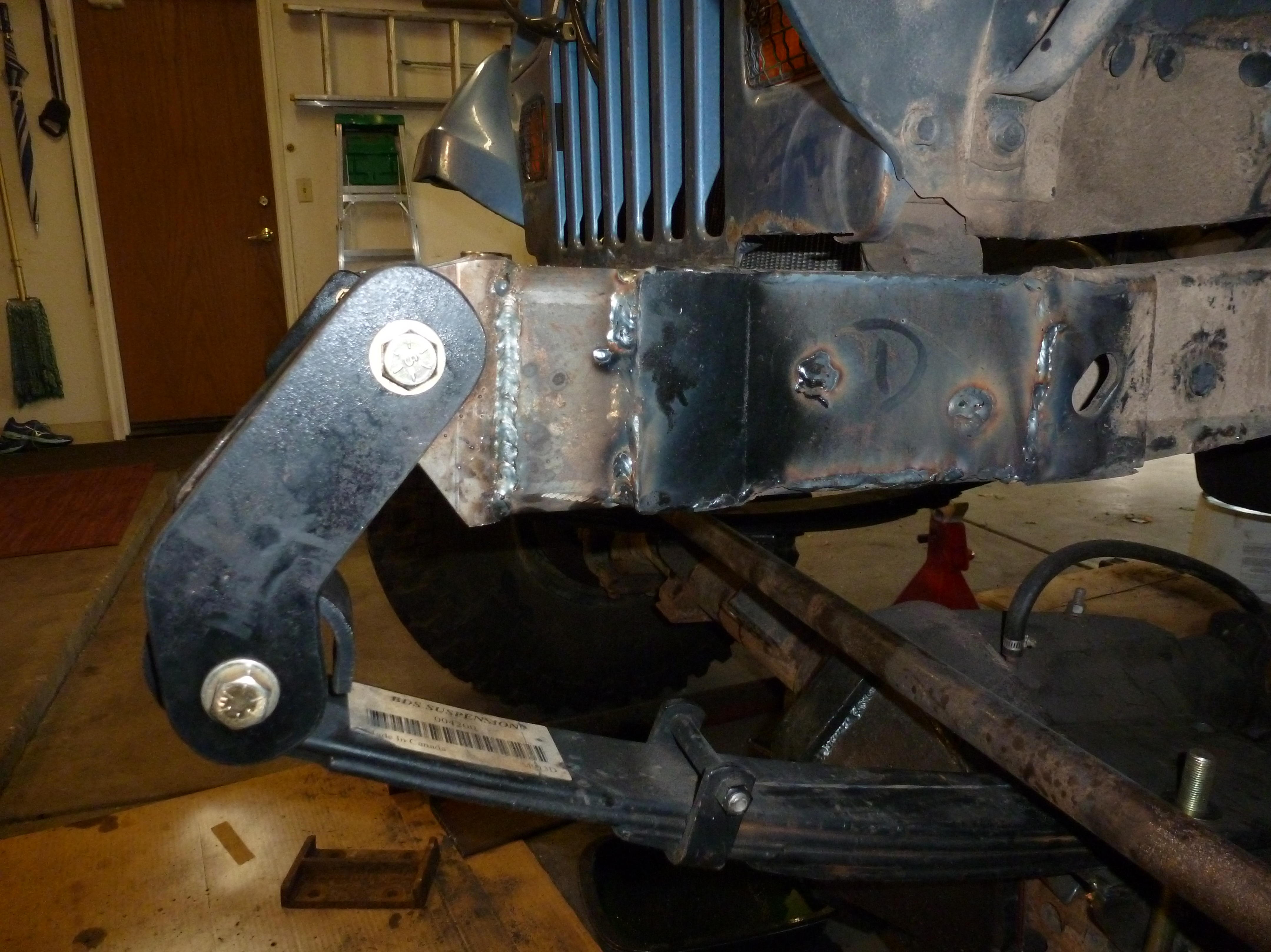

MUCH better day today.
Added 2 inches back to the front and all was good! (that's what she said)
My dad pushed for just adding to the end of the already fabricated front. It was much easier than cutting off the front again, adding in and plating the added section of the frame. I still may do this in the future because I am not happy with my dad's suggestion/push for the easy fix. Still needs some plating.

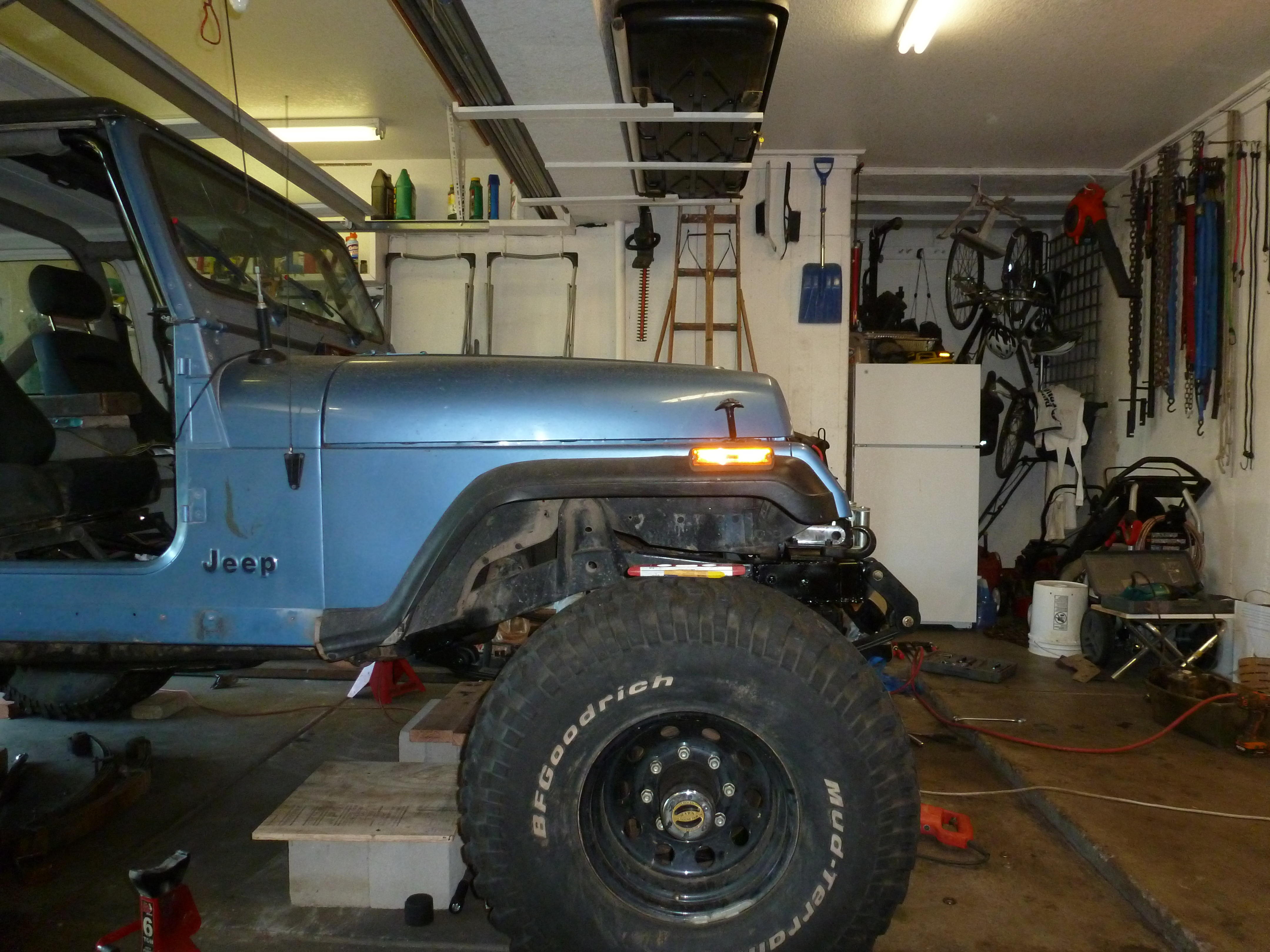

It turned out as I had originally planned (after adding back in the 2 inches). Great shackle angle of 35*. Frame height is 23 inches. (YEY!!)
Tearing down the back end but leaving the stock hangers and hoping the BlueTorch Fab's YJ/XJ stretch works out with a set of stock used XJ springs from the junk yard. If the mock up does not look/measure right I will figure something else out.
