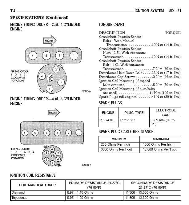

It sounds to me like you got the wrong firing order on the cylinders (mixed up the spark plug wires).
I'm not sure what engine you have, but the firing order should be:
2.5L 1-3-4-2
4.0L 1-5-3-6-2-4

double checked the firing order, that was correct, cap and rotor were ok, but replaced them anyway, not a big misfire, jjust has that hint of slightly rough idle, almost like a big cam would do in a hot rod, havent pulled the plugs back out yet, guess i should make that my next step to check for a crack, and recheck the gap, thanks for the input
