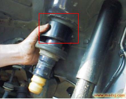

The spring connects to the bump stop. When i take the spring off does the thing the spring connects to at the top also fall out? How is this held in?\
I have circled the part I am talking about in the picture. You will notice that they put the new spring spacer above the bump stop/coil spring holder. I already have a sky jacker lift should this be the same or is the only way to find out to take the spring off?

Ok so apparently I attached the pic. Anyone have a tip on how to get it so it displays in the post?
