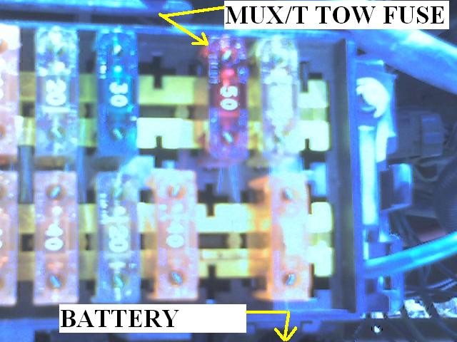

hi Steel Headz no iu do mean MUX/T TOW that is what it says on the fuse box cover.
Is there a Fuse #? . I've been searching and reading all the circuits on both factory and aftermarket tow wiring diagrams and cannot find that. I even tried looking into the export model, still none.
i will have to check i'm at work now only other info i remember now is that it is a 50Amp fuse
and it is in the fuse BOX that is under the hood just behind the battery
hi I could not find any fuse number on the power distribution box, sorry i dont know what else i could look at to give more info on what FUSE i'm talking about:???:
HI
sorry this took so long i attached the pictures hope this helps

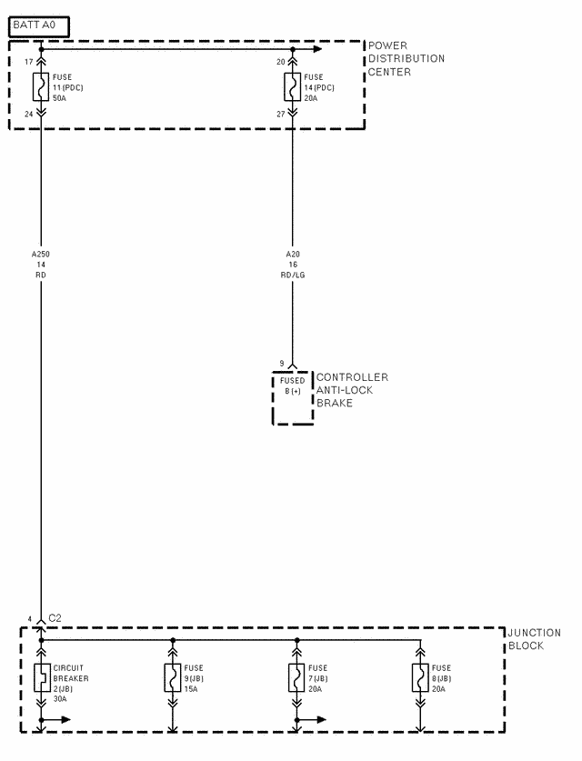

Okie dokie, I feel really stupid after you posted the pic.. The whole time, i kept reading it as Muxit tow fuse. after you posted that pic, i can understand now that it's a Mux / T. Tow fuse. lol. Anyway's , here it is. The schematic Diagram looks pretty simple from the PDC to the Junction block. This is where it gets a little complicated(From the junction block). The circuits Splits(junctions) out to multiple modules such as the DDM(Driver door module), PDM(passenger door module), BCM(Body control module), Auto day and night mirror and stop lamp switch. Let me know where you want to start on your venture trying to figure this out. I have dug up a lot of Diagrams but too much to post all at the same time.. Just let me know.

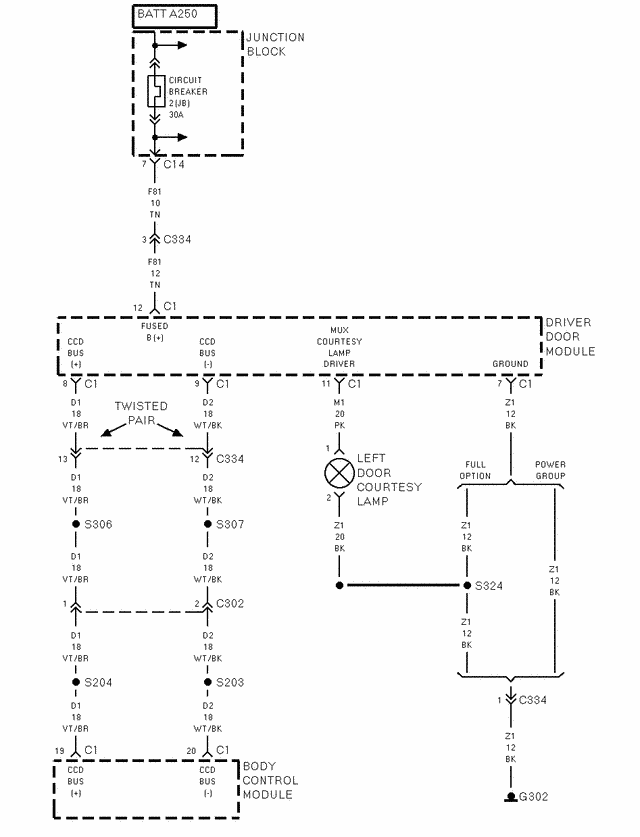

Hi thank you for the schematic, so yestaerday I took out fuses # 7, 8, 9 from the junction Blcok they are all connected the MUC/T TOW fuse.
consuption continued so I went to circuit bracker 2(30A) the one that powers the passenger/driver door modules. and finally consuption stoped.
so now the thing was to take out the modules i took the passenger side first en the consuption stoped! yei!. then I went to the driver side and also took out that module so that i could out the passenger module on the driver module an comsuption started again.
I finnaly found my multi-meter and measure the exact current so with the circuit braker out the current measures 14mA with the driver module on the current goes up to 16mA (2mA difference), when the passenger side is connected it goes up to 24mA (8mA difference), I want to go and get a passenger door module but i need to hear youre advise first because while the passenger door module consumes 4X what the driver side does it seems like very little current to me, but i'm not that familiar with current values on cars.
thanks again I think we are close
Before you condem the DDM or the PDM, did you let the BCM go on the "Sleep mode"?, cause if you didn't , the test you just did will be inaccurate. . The difference in voltage flow between the PDM and the DDM will vary due to the added support of the RKE. Im not sure if it's the DDM or the PDM that is requested by the BCM to program the RKE and Skim if equipped. Right now i'm leaning towards the BCM for the battery draw issue.
