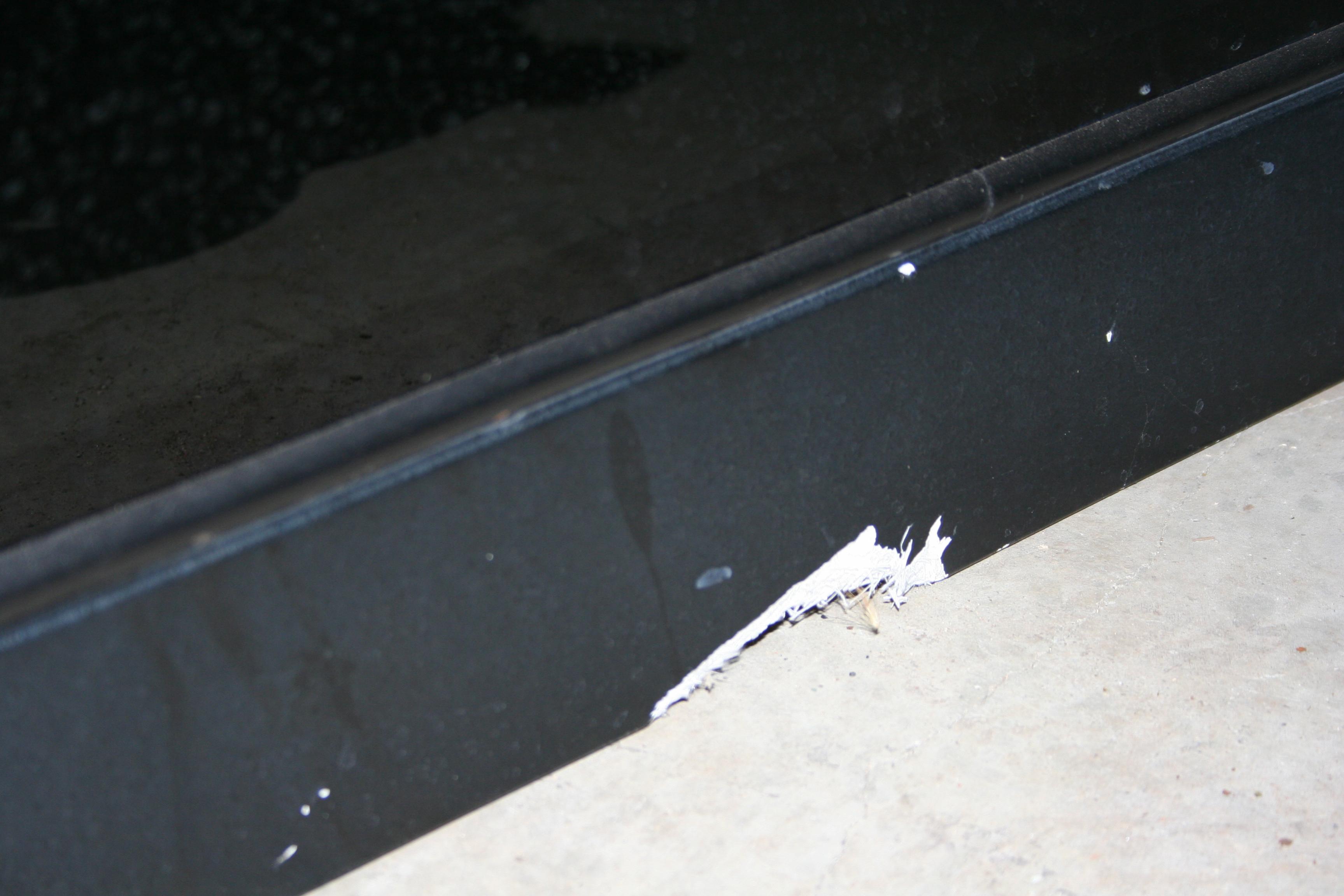

I got this hard top for twenty bucks. It has a few scratches I can easily sand down and cover with herc. I need a new rear window glass, but the defrosters, wiper motor and arm, and hinges are there. There is one good sized chunk missing, (see pic), but all in all, 20 bucks seemed good to me.

That's a Great deal!, better yet , it's a steal. You can re-work that missing chunk with a fiberglass resin and get it to where it's as good as new. I have a Rear Glass that would fit that. It came off a TJ as well. as far as fitment is, i don't know how much of an angle difference there is in on the header section. as far as the door dimensions, i think (i could be wrong) they are pretty much the same. When i installed an 04 Rubi. soft top on my 81 CJ7, all the dimensions fit the same as the 04 rubi. exept the header area. i had the upholstery shop chop off 2" at the end and had the plastic header channel stitched onto the end like the original CJ's style top. I think, the best thing to do right now is to set the top on your Jeep and see what fitment mods. that needs to be done. this will give you an idea also on the door dimensions if it would work. Bounty_hunter knows a lot more of this than i do, i'm sure he would give you some tips on what needs to be done. I've been contemplating on this project, but i haven't tried it yet. I'm glad you beat me to it:lol:.. Let me know if you want the glass..

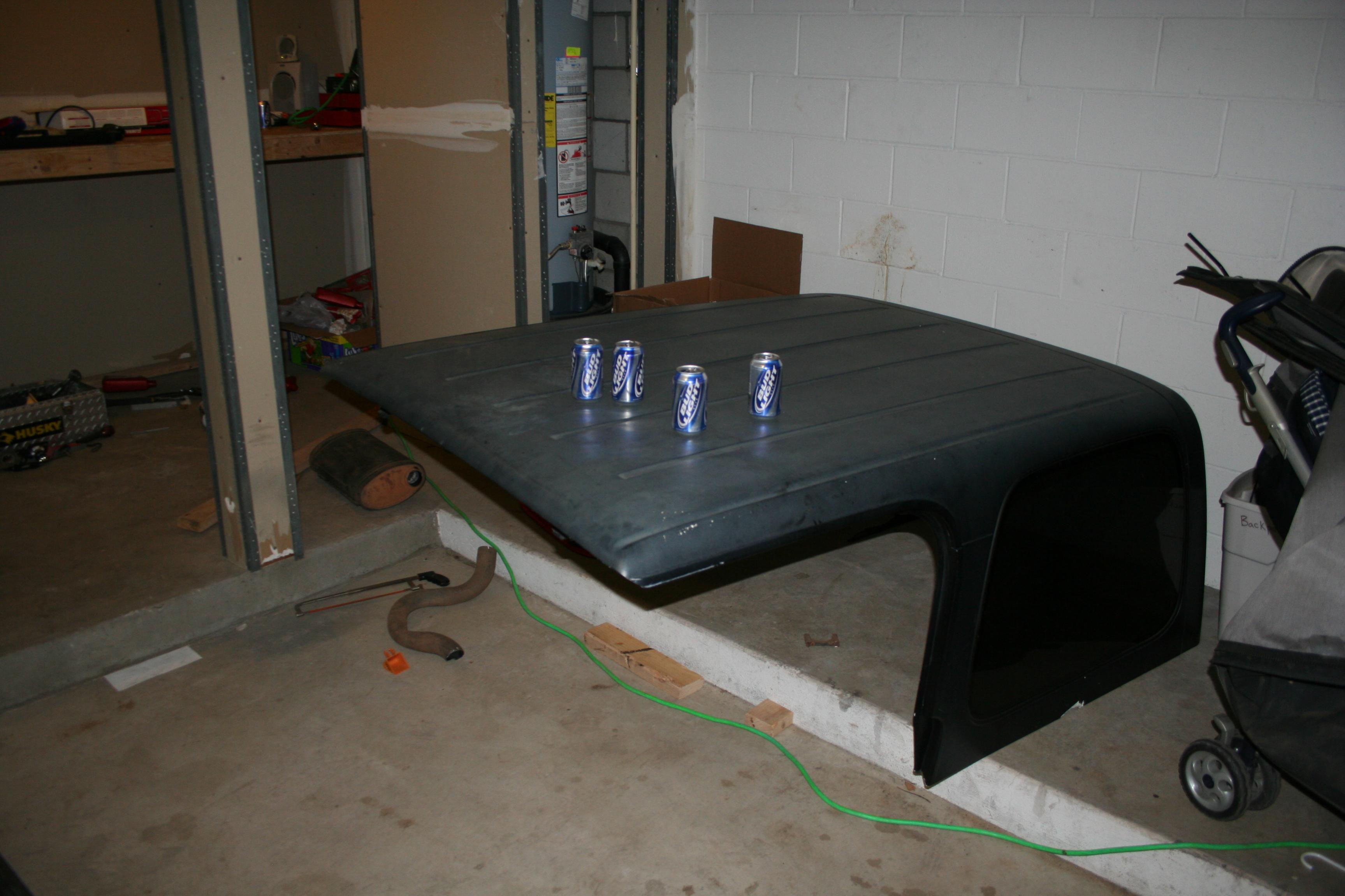

BTW.........I love the decorations on top of it!! Did those come with it, too (Full, I hope)????:lol::lol::lol:
No, those were collected from the "standing there staring at it with an open beer wondering how the heck I'm gonna make this thing work" stage of the project. I've got the week off work to help my wife, (who just gave birth to son #2), so naturally that translates to, "a week off to work on the rig!" I'll get the top on today and see how she looks, I'll post some pics.

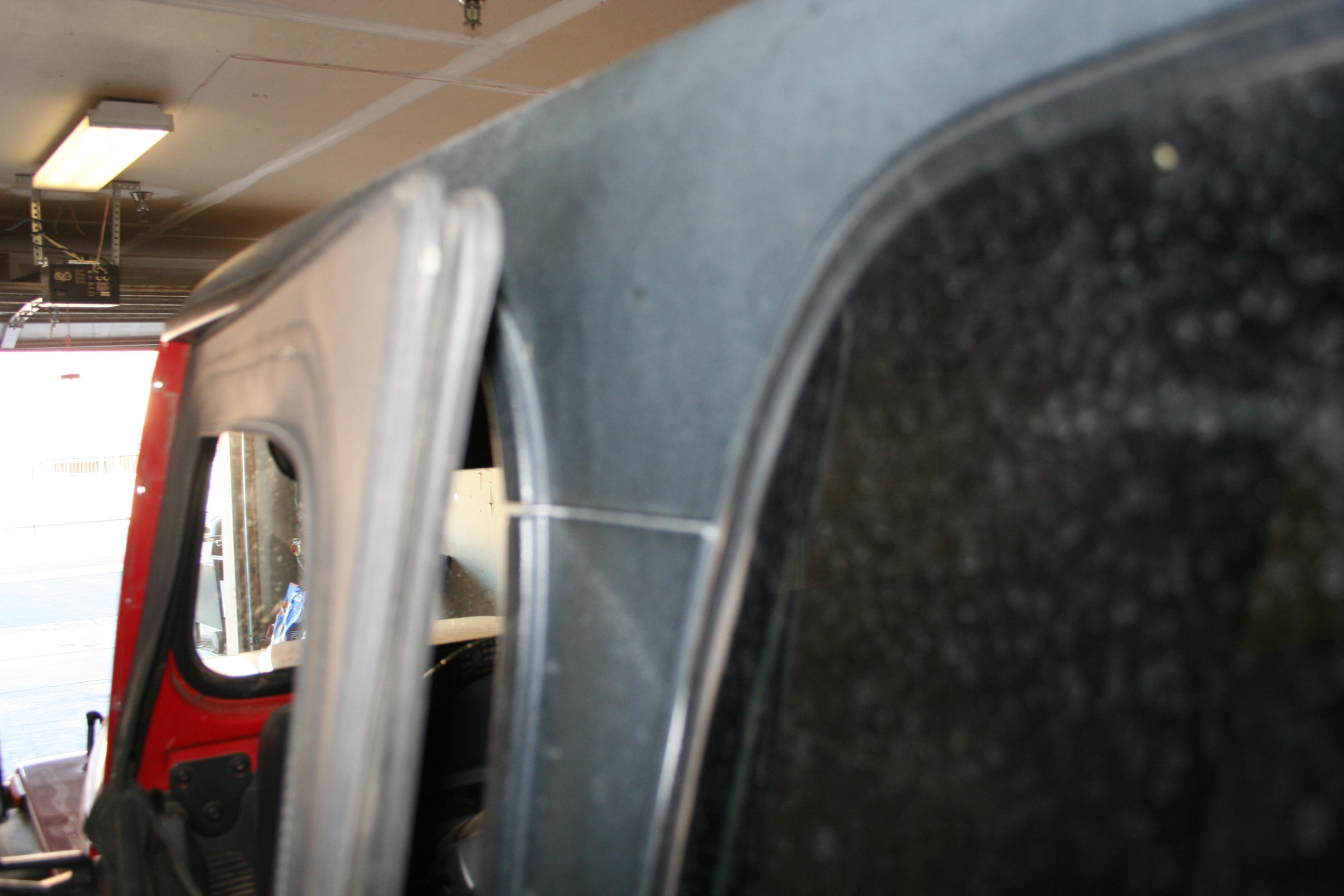

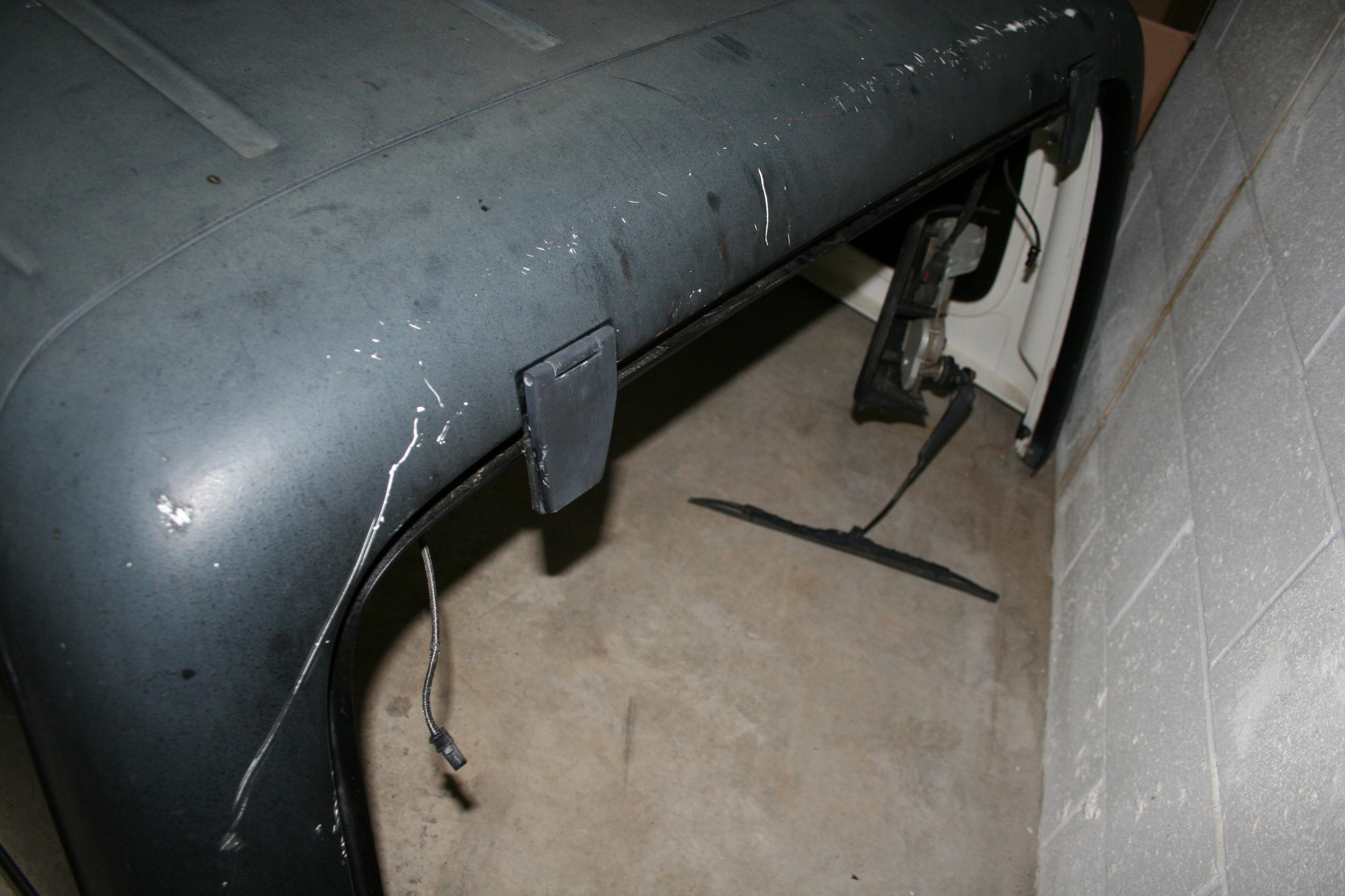

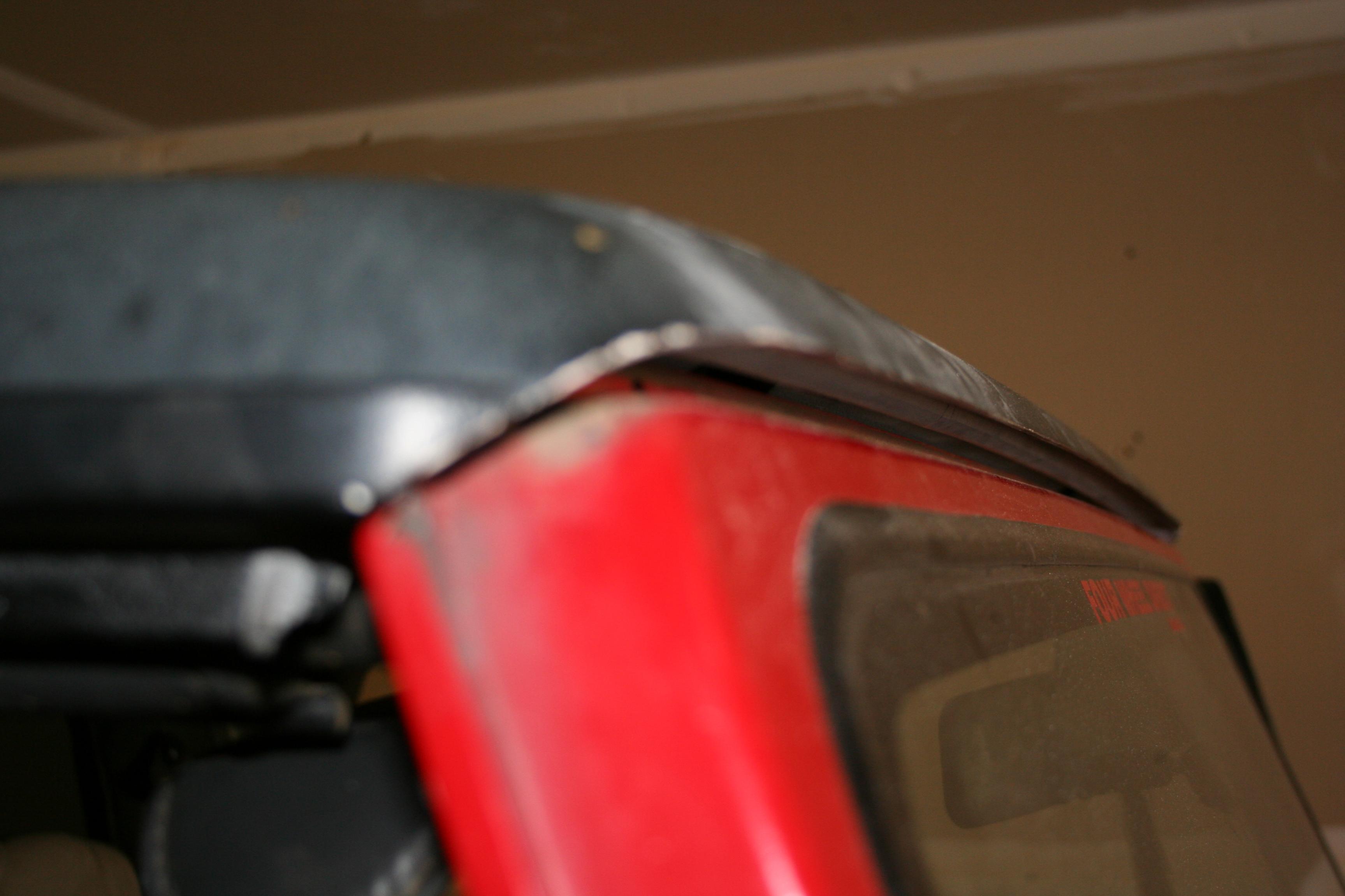

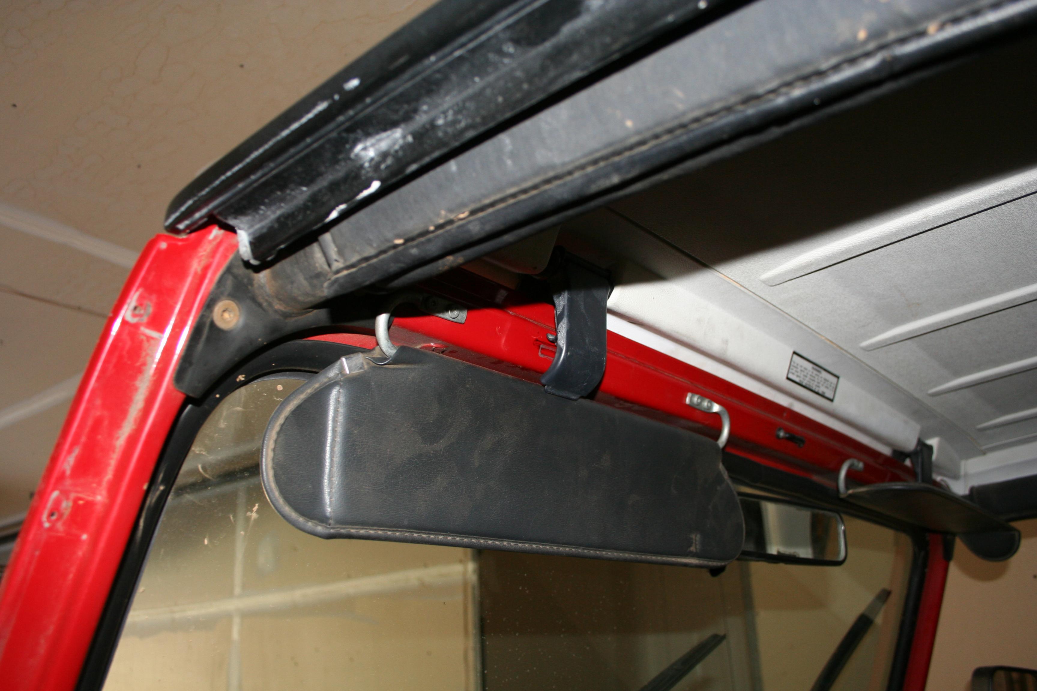

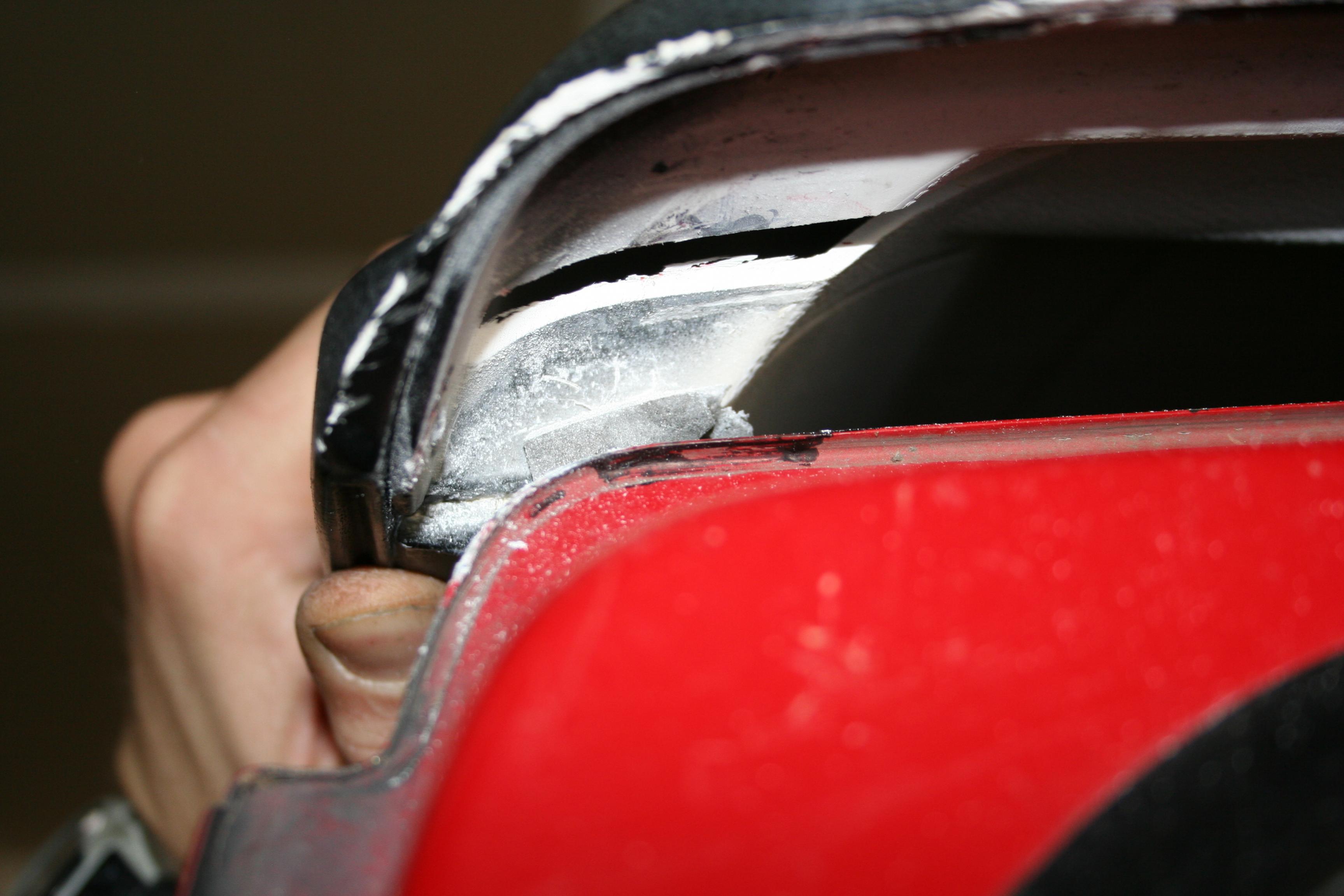

So I got the hard top on, and even though it isn't a perfect fit, I think it's going to work just fine. If you look at the pics. you'll see I had to notch the corners of the top b/c it was hanging up on the windshield frame. Even with the notching there is still about a 3/4 inch gap between the header and the top, but I'll just fill that with some thick weather stripping. I had hoped that the soft doors would work untill I could get some full doors, but it's just not possible. (Anyone got some full doors that will fit?)
My only hang up is that I don't have the notches in my header to latch the top down. I know I'll just have to man up and hack it, but I'm hesitant. I'll only get one shot at it and I don't want to mess it up. I'm thinking of having a body shop do it, and maybe they can re-inforce it while they're at it. Any input on this one would be helpful. Thanks guys.

Pick up a roll of Foam tape from a Craft store or a hardware store. install this on the header area on the hard top where it contacts the windshield frame. this will seal it from water intrusions , wind noise and keep it from squeeking on rough roads. put some on the sides where it sits on the tub as well..
