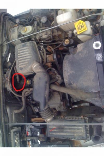

I have a 2003 TJ 2.5 L 135,000 km. Just recently started performing some simple maintenance on it (like changing the spark plugs for the first time)
Today I broke the CCV plastic cap/rubber fitting... Is it ok to drive the Jeep without this ?
think you mean PCV , any auto part store has them in stock , I"d replace it right away other wise you will have oil splatter all in engine compartment
Not on a 4.0 they are ccv
It's a CCV (Closed Crankcase Ventilation) on both the 2.5 and 4.0 engines from '91+.
That particular fitting should be sucking filtered air from the airbox into the crankcase, so if the CCV is functioning properly your only concern is getting unfiltered air into the crankcase.
