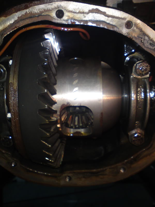

And just for the heck of it, here's how the D35 looks today from the inside (ignore the marks on the ARB; that's from a previous issue that has since been fixed):
I also agree that it is better to throw a Ford 8.8 in there rather than throwing money on a D35, but then again, I threw my money on the D35 and it has yet to fail me (although I do know it is my weak link, especially with 33's and ARB's; I DO have, on the other hand 31 spline alloy axles in there).
