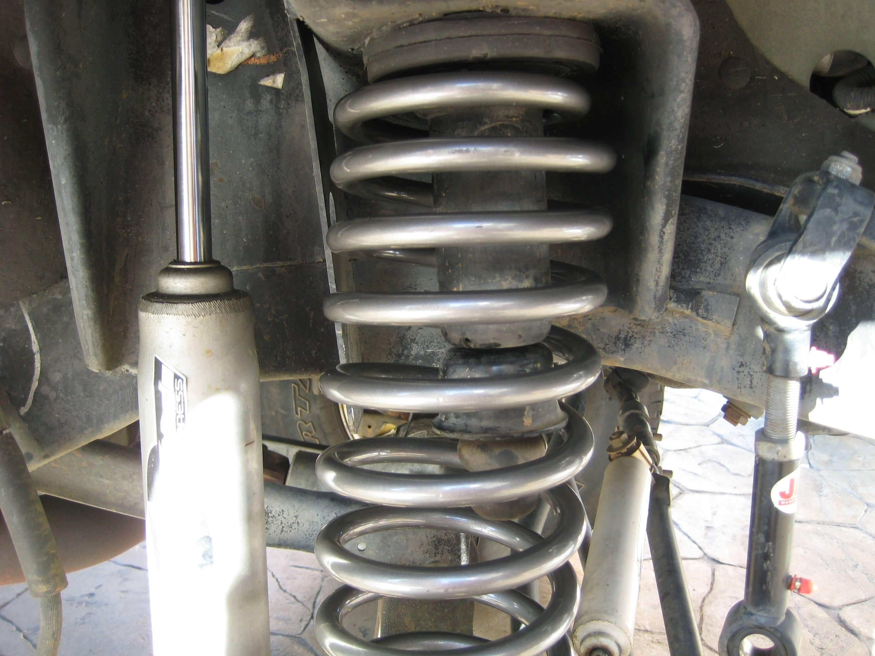

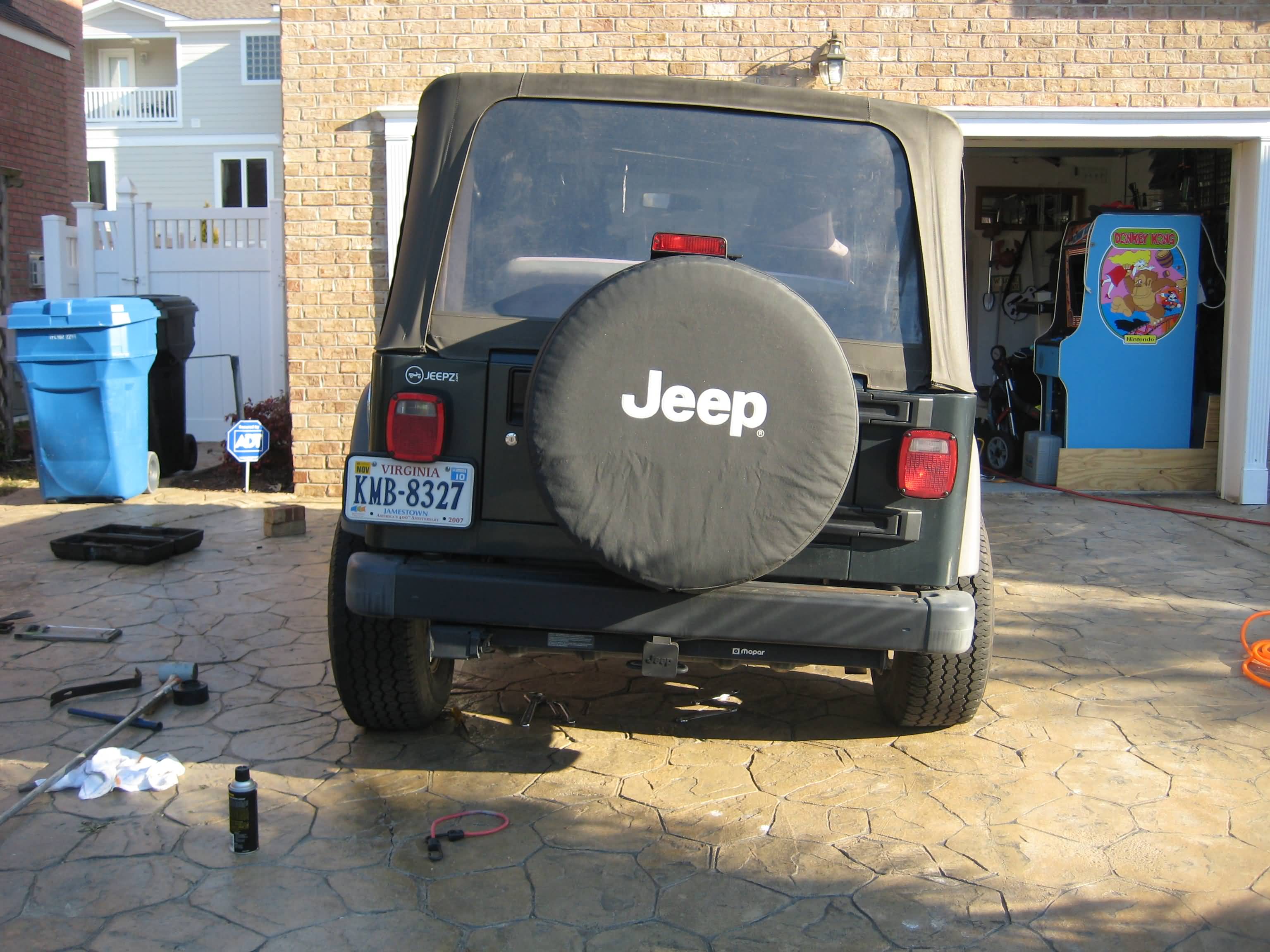

Here's a shot with my 2.5" coils on the driver side, and stock springs with 2" spacers on the passenger. The Jeep seems to be standing alot taller with the new springs.

To ultimately have the proper angle on the drive shafts, Yes, the adjustable lower control arms will help attain that and will also help attain the proper caster as well. That looks great Terry. Kinda looks funny with only one side lift though.lol.
You may have been able to get by with just installing the adjustable cam bolts on the axle end of the lower control arms on the front. Then adjust them all the way out so the bottom of the front axle is as far forward as possible. This is all the caster adjustment necessary when I lift a jeep 2"-2.5".
Early TJ's came with these adjustable cam bolts, later TJ's went cheap and used non-adjustable bolts that appear similar to the cam bolts.
