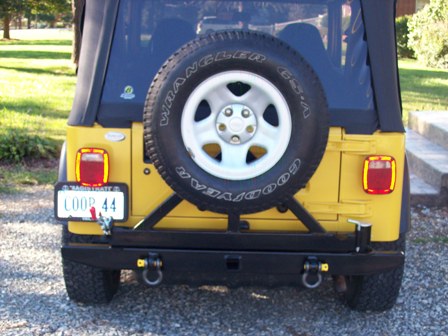

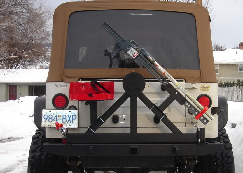

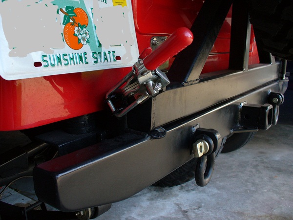

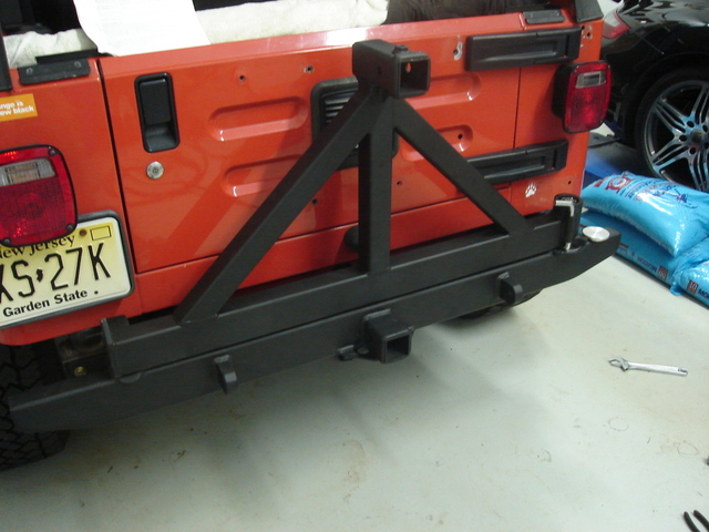

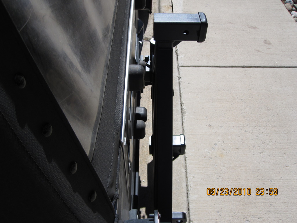

As to your problem, you'll want to buy a tire carrier. This is normally a new rear bumper with it's own swing away tire carrier built in. I'm a fan of Ground Pounder myself because it's a local business, and the owner Eddie is a nice guy. You can send him a pm for a quote (his name is BESRK on this message board).
Here are some examples of a tire carrier:
