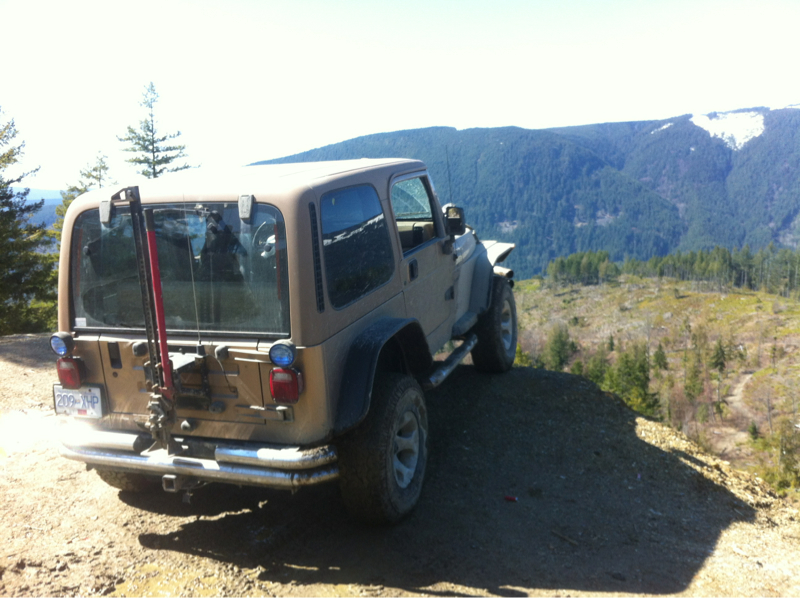

I'm building up my 99 tj, it has a 4" procomp lift and 33's everything else is stock, 4.0l , 5 speed. It's my daily driver, hunting/trail rig, so basically my do everything vehicle. I would like to go up to 35's , with lockers front and rear, thinking arb or e lockers, I would like to find a 241or for the 4:1. I know the axles can't really take this stock, do should I go with a super 35 in the rear, find a rubi 44, or go to a ford 8.8? The front I think I would be ok to go with cromo shafts, or do I go rubi 44 up front as well, or if I go 44's front and rear look for a set from a jk? What do you guys think? It's not a hard core wheeler up its sees it's share of action. Oh and I would re gear to 4.88's for the 35's.
Oh I need to get bumpers and sliders as well:)
