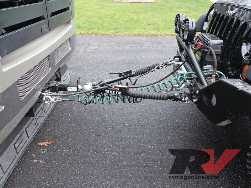

My Wife and I just got into Jeeping and had a great time in Moab, Utah at Easter Jeep Safari recently. Thanks to the Red Rock 4 Wheelers! We realize we need to beef up our 2005 TJ and we'll do that little by little. For now, we had some issues with the rear frame mounted U-haul hitch receiver hitting some boulders and ordered a new rear bumper with integral receiver and pivoting tire carrier to replace the stock bumper. In the front, we'd like to replace our stock bumper with one that has these features:
  • Winch mount provisions.
  • A pair of tabs on each end that will accept a standard tow bar from our RV.
  • Provisions for lights?
  • Left and right shackle mounts (I don't think the tow bar tabs will accept a shackle directly, but this is up for discussion).
See the attached picture. The issue is finding a front bumper with the tow tabs built in. Any recommendations you have will be appreciated.

I like that setup! It doesn't drop down from the RV and attach low on the Jeep. Nothing to remove when arriving at the campsite: just detach everything and hit the trail. I have the newest Smittybuilt catalog. I can see that bumper in there, but it doesn't have the lower 2 light holes or the tow tabs. I could not find tow tabs in the catalog.
